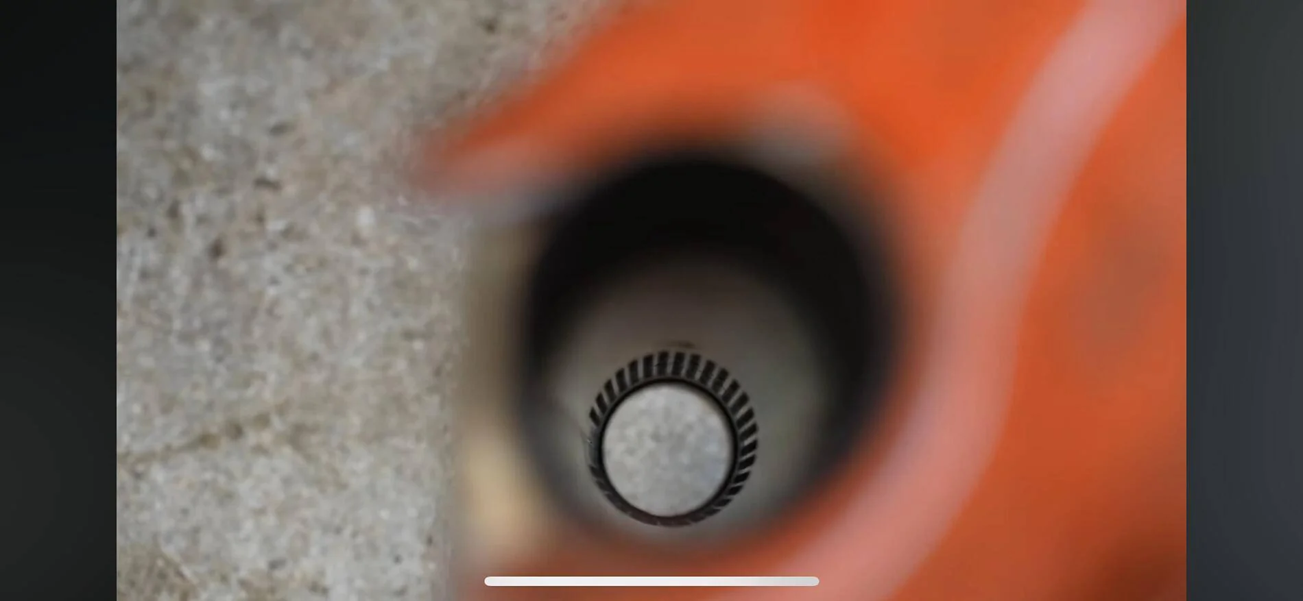

30 seconds into this video it shows the inside of a stock S650 GT V8 resonator. I didn’t realize it’s basically 2 straight pipes without an equalizing crossover like H or X pipe. The screen capture shows one side. Makes me wonder why Ford wouldn’t include at least an internal H. Maybe manufacturing cost or EPA noise regulations?

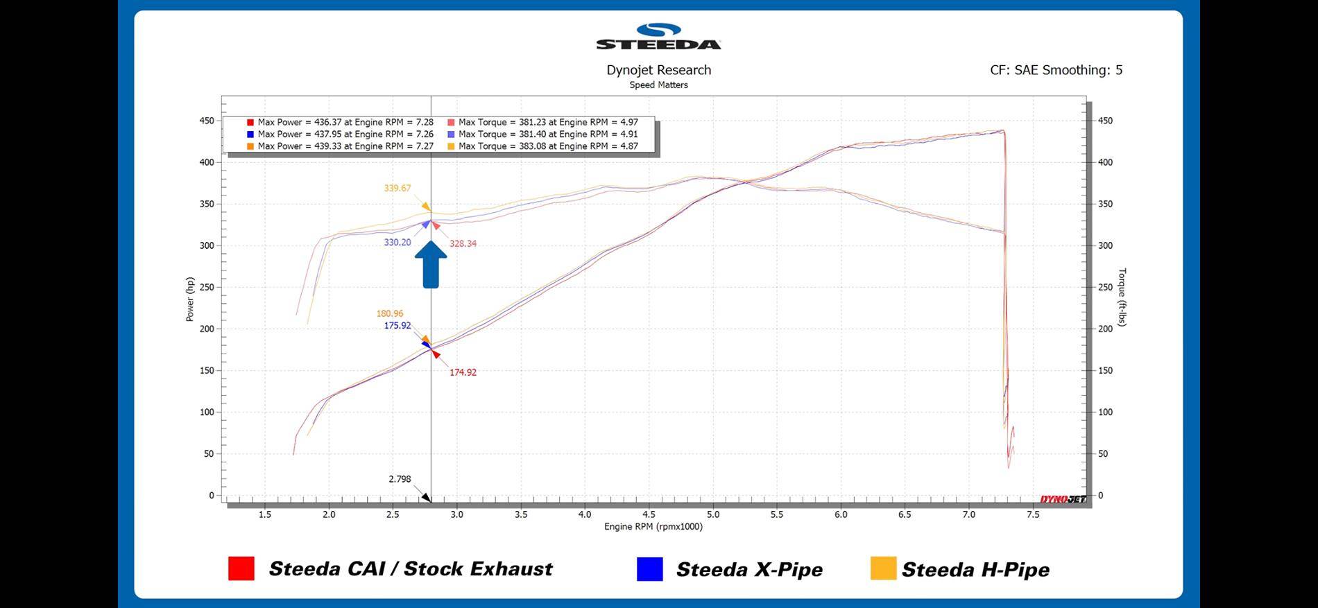

There’s an updated Steeda video where they found the H pipe makes 10 ft lbs more torque at 2800 rpm. Very tempting. Hard to say how it would improve my setup, not active exhaust, but have Roush axle back. Here’s a screen capture.
Are all three runs with the steeda Cai?

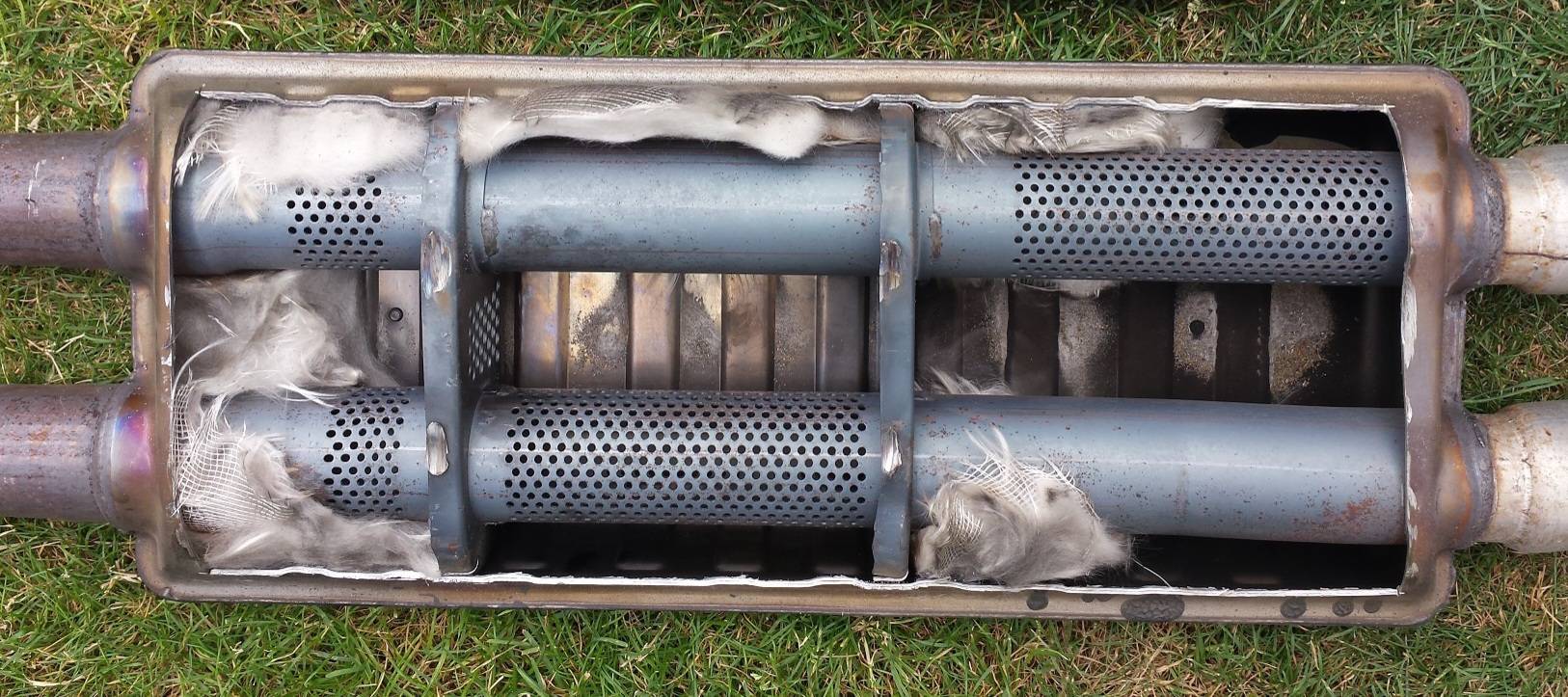

It's misleading without seeing the inside of the case. Someone cut one open and posted here, but I can't seem to find it. The pipes inside the case have vents in a staggered position that create a crossover effect.
I posted a cutaway of I believe a S550.

This is over and above CAI as it was included in all 3. Also it’s a Dark Horse with active exhaust. Again this was additive to that. Not sure how it would be in my base GT without active and only Roush dual tip axle back.
