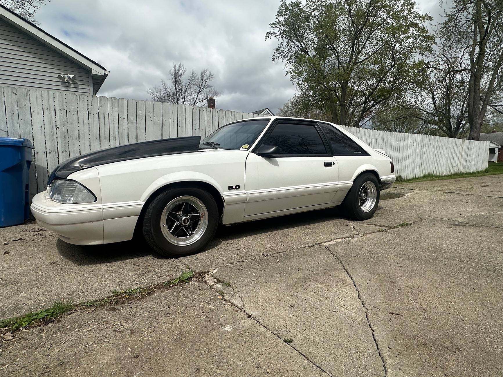

Funny, I actually have jones max flows on my foxbody also… quietest mufflers I could find…
331, dart block, Ti trim… 22lbs of
Boost…absolute animal
when I had flowmasters on it the drone was the worst, rattling all the windows inside me and my neighbors houses… we’re cool now and they know how hard I worked to quiet it down and not be a bad neighbor.
