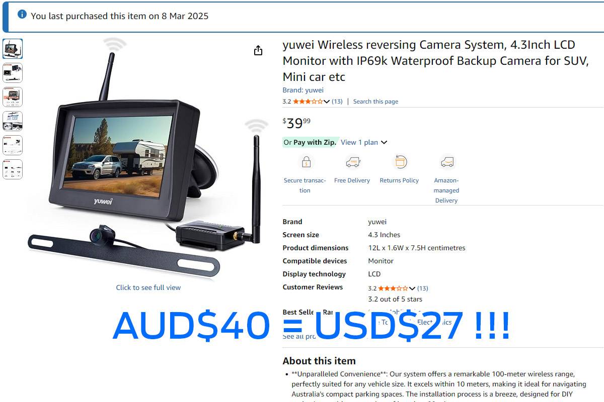

Front Parking Camera
I'm using a wireless reverse camera system as a front camera.
Wireless means there are no hassles getting cable through the firewall.
The camera system itself is inexpensive and works well, but some custom brackets had to be knocked up.
This was easy, using some scrap aluminium pieces that were on hand, and basic handy man tools.
Amazon - Wireless reversing camera kit - affiliate link (I may earn a small commission at no extra cost to you)
https://amzn.to/4kFyzIR
S650 Mustang Inexpensive Front Parking Camera System Amazon-Listing_1200
It was AUD$50 (USD$33) when I purchased it back in March 2025, but is AUD$40 at the time of writing.

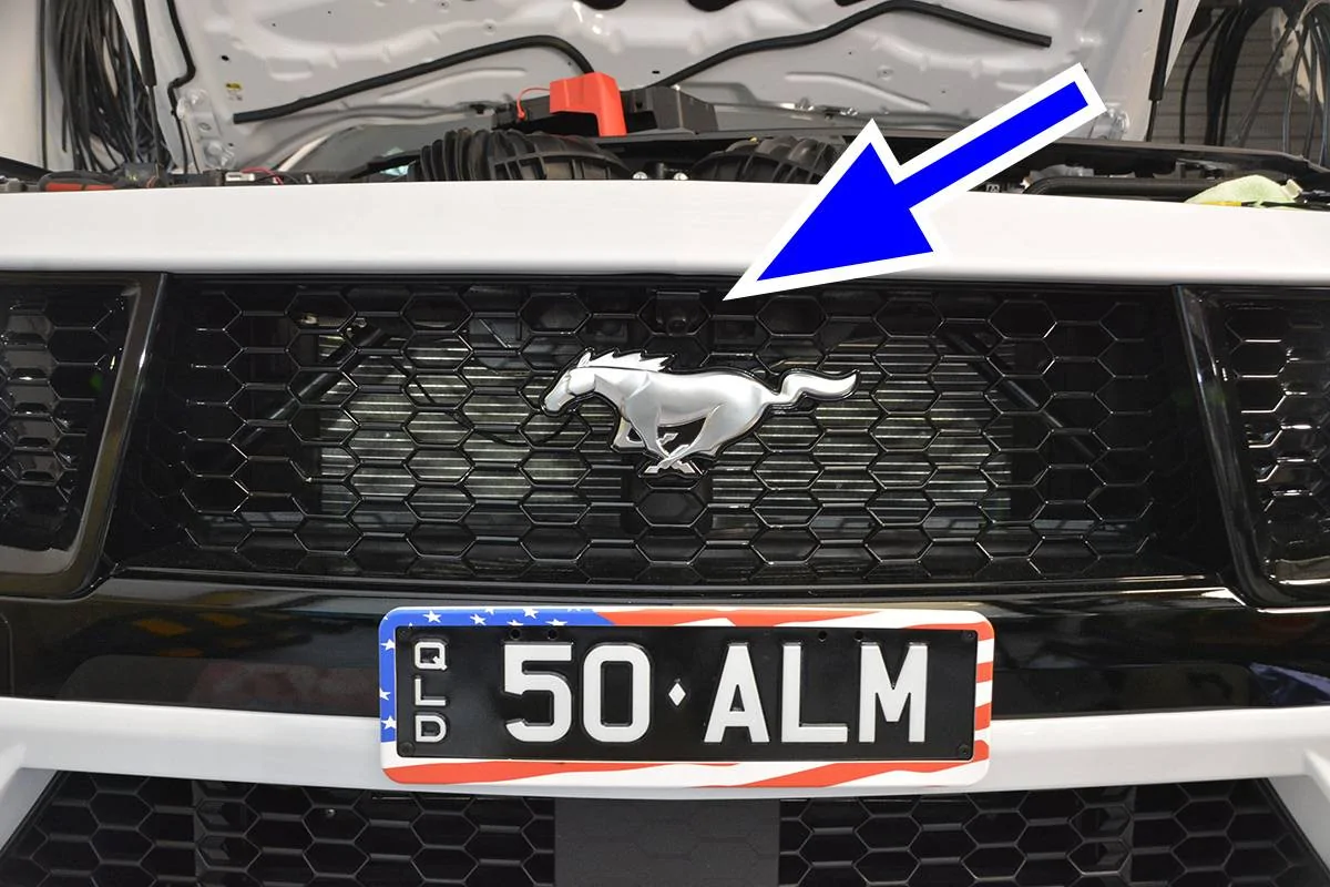

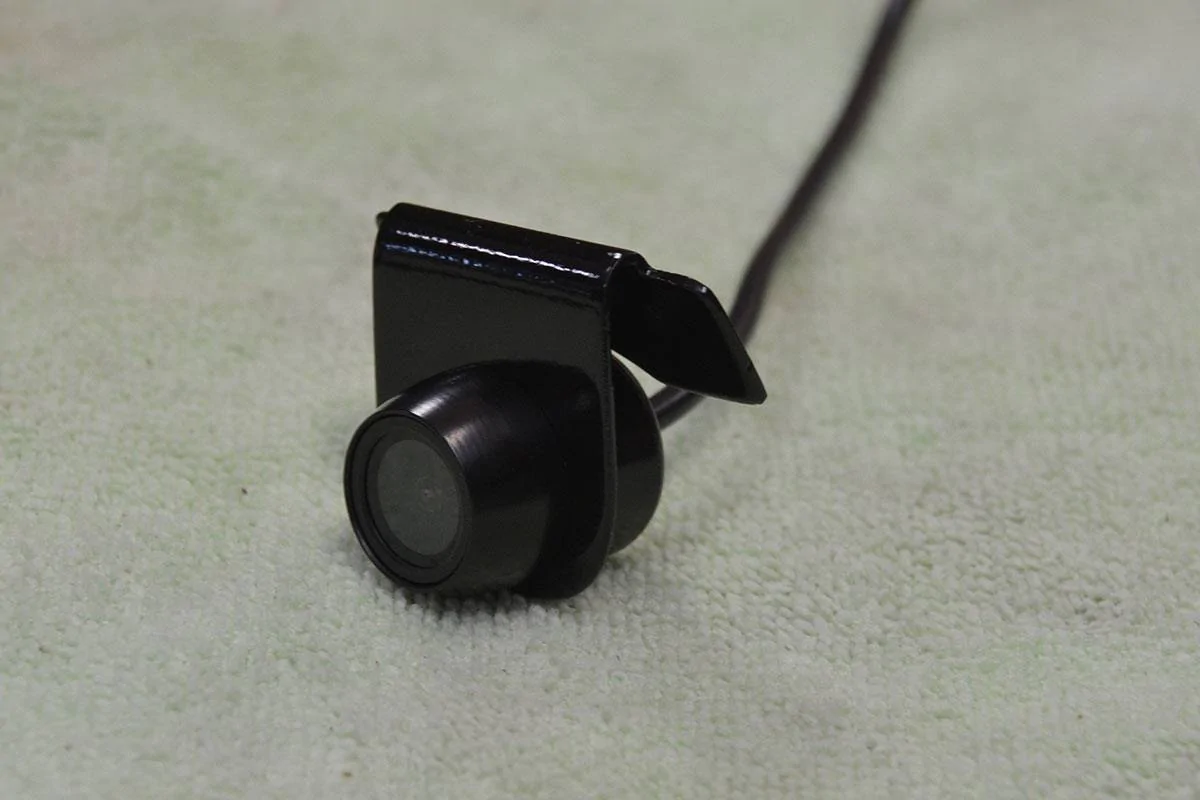

See the camera?
The camera mounted to the home-brew camera mount, sprayed in gloss black enamel.
I think my mount blends in quite well, considering.
It could have been finessed more, but I just wanted to get it done.
It's held in place with 3M VHB double-sided tape.

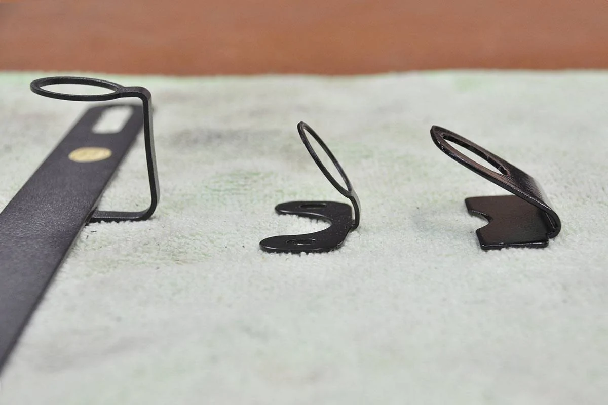

This provides a good comparison between the supplied number plate bracket, their butterfly bracket, and my own home-brew butterfly mount.
You can see the extra down tilt required to get the result I achieved.
Corners could be cut if you can use the supplied brackets, but it's worth the effort making your own and getting it just right. :rockon:

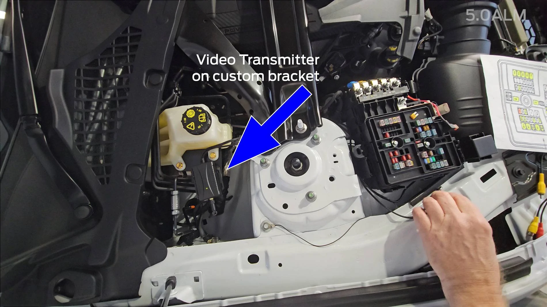

A wireless system eliminates any hassles trying to pass cables through the firewall.
I think the battery is located here on LHD vehicles, so you'd need to mirror this or find an alternative spot.
It is handy having the fuse box nearby to power the camera and transmitter though.

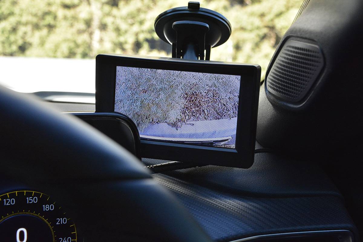

With the number plate at the bottom of the screen, the camera's FOV (field of view) placed the horizon (top of the screen) at about 1.8 meters away.
That just under 6 feet in imperial.
This is a good range for parking.
Granted, not as elegant as an OEM integrated system using the center screen, but it certainly does the job!
And it's better than nothing.

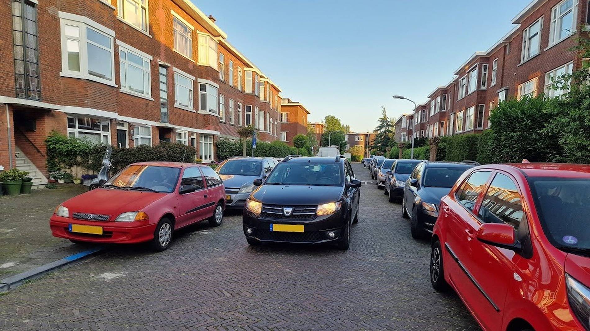

Until you come drive the Mustang in Europe and find yourself having a huge car for very thight spots.
That makes more sense I guess. I'm spoiled living in the country.. That's funny you calling it a huge car.
Definitely two totally different worlds.. 😆

Yup. We have parking spots that don't even fit a VW Golf in Europe. So a Mustang is huge.

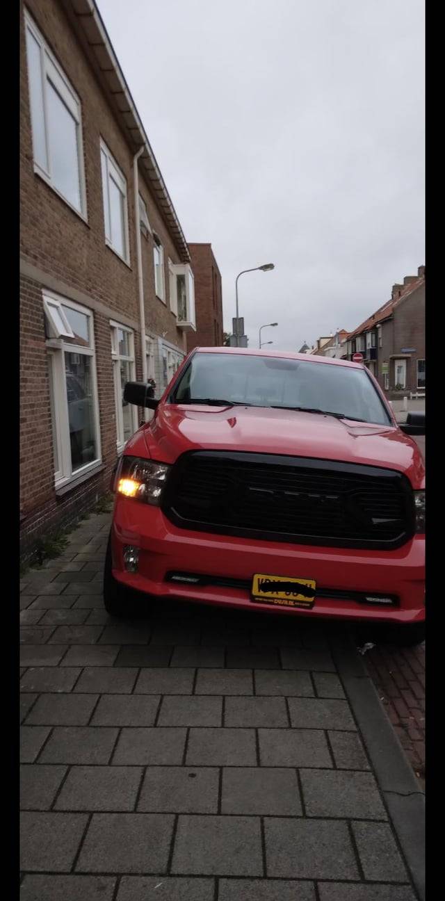

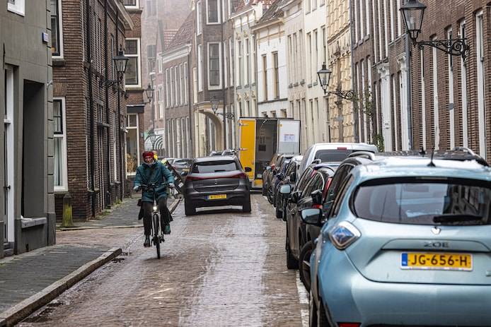

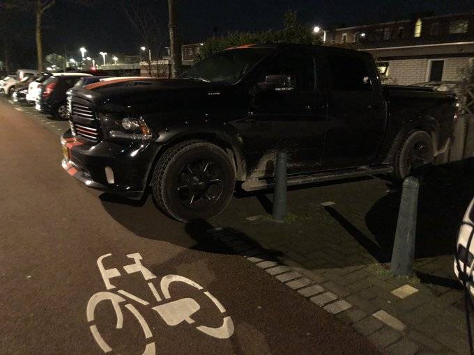

I see that pickup in the background. The government wants to ban those cars from the cities because they don't fit.

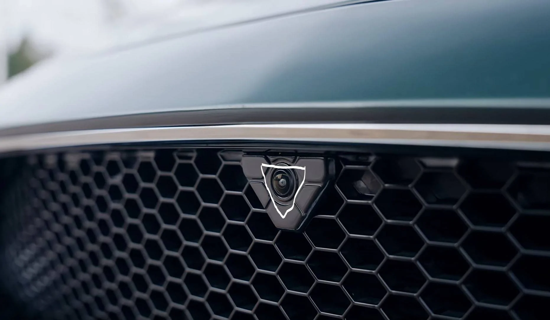

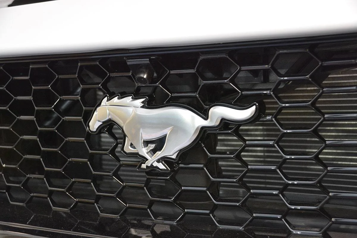

CBS Automotive ( in UK) did a really good front camera instal in a bullitt mustang, made it look part of the grille.( I couldn’t find way to get link here,sorry).
Think front camera be very handy, have a couple places up the road where park up near a wall..sure can reverse in but not always possible..
I think majority of drivers Mustang or other would appreciate front sensors/camera..
5.0ALM
5.0ALM
Oct 31, 2022
85
1,130
1,878
Brisbane, Australia

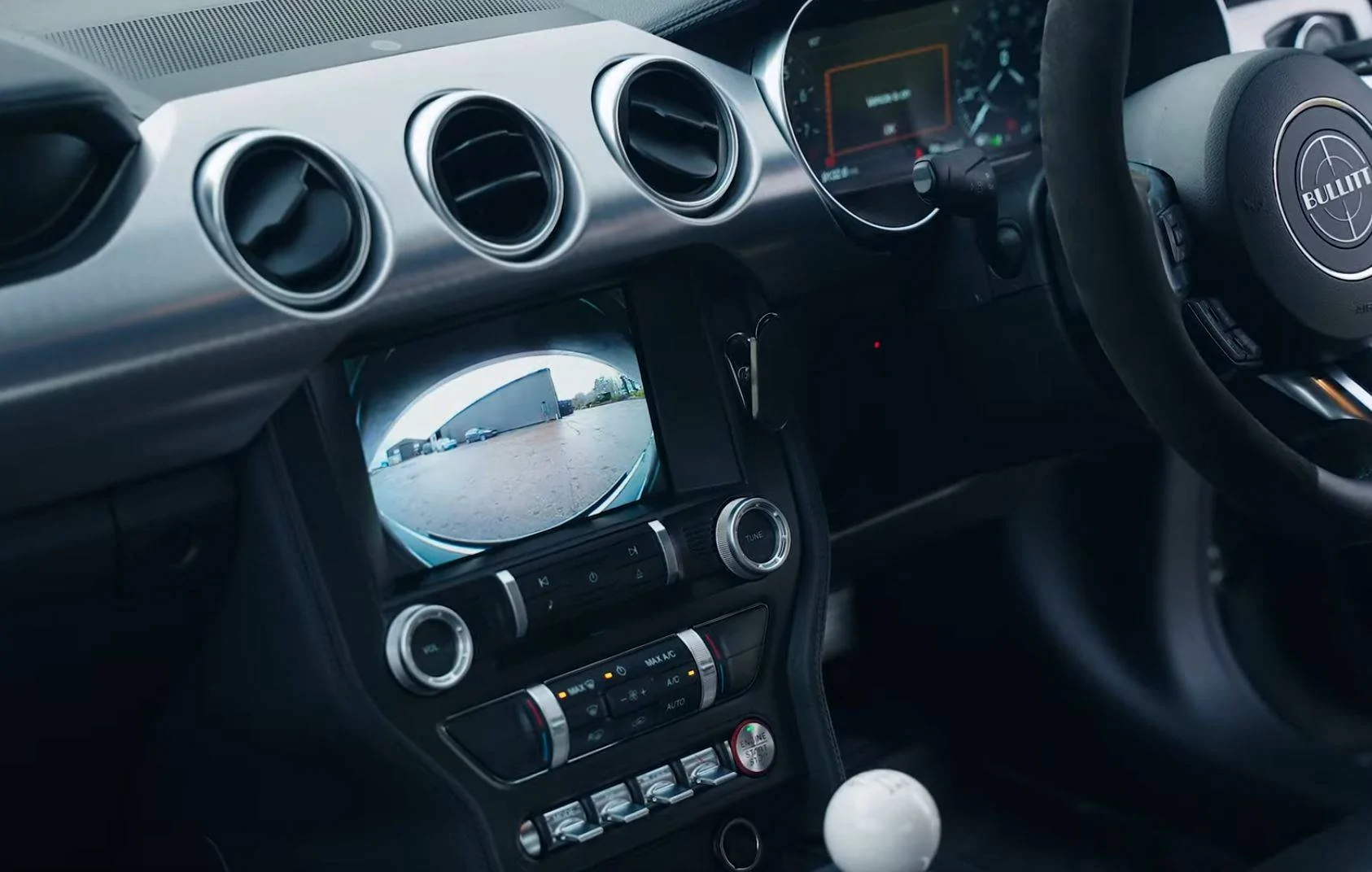

With such a large surround, I suspect they have hacked away at the front grille.
Their camera doesn't appear to have much, if any, down tilt at all:
Call me crazy, but I don't care what's 20m away - you can look out the f'ing windscreen for that!
I want a good view of what is less than 2m away, which is masked by the long bonnet and low drivers position.
The fisheye distortion from the excessive FOV (field of view) means it was a poor camera choice, and the masking effect from their mount is terrible.
For close-in parking use, the whole point of it, I'd be disappointed to have paid a professional for an end result like that.
This is the hidden cost where the priority of making it look classy has severely degraded it's actual functionality. :facepalm:
