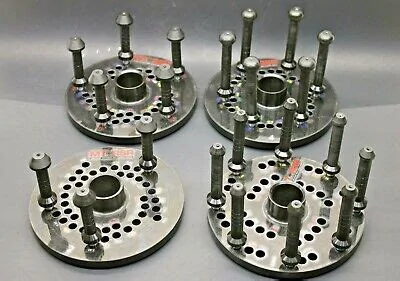

The Ford dealership 18 year employee “his words” didn’t know what a pin-plate balance is. So I went to Costco because I know the crew, I use to manage the shop. From the factory every wheel was off by .50 ounce, which is why I felt the front end was off. Then the tech calls me over and shows me a wheel that’s bent! 5K miles and a bent wheel, not what I was expecting. So in your opinion, I’d it better to get a new wheel or change them all?

If the wheel was actually bent by you (not in shipping or other mishap), then you probably need stronger wheels. Are they factory wheels or ? I must confess, not sure I've heard the term "pin plate balance"... I assume it is to balance lug centric as opposed to hub centric.

About 5100 miles. Took it on a trip to Texas in June, many road issues. That’s my guess for the cause. Really surprised that a OEM wheel would be affected by a hit I should remember. I’m old, so there’s that.
Pin-plate balance is coned on the back side of the wheel with pins that mimic stud/nut connection to the balancer on the front of the wheel. This in turn creates an accurate connection to the balancer, giving a more accurate balance.

Well, I've been in the dealership service business for 48 years and never heard of a pin plate balance either. After reading a bit further down, I see that you are actually talking about a lug centric balance. Ya learn something new every day.

For reference.
Lug centric, we have always referenced as pin plate.
