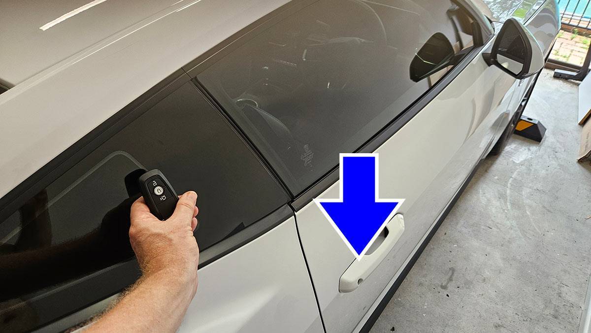

This was driving me insane, especially at 06:30 in the mornings with my neighbors bedroom <10m away. :explode:
I did find holding the fob up against the rear 1/4 window whilst exiting prevented the double-honk 99% of the time.
Sensing the low powered signal through the glass meant it took a few goes to find the optimum spot.
We're RHD down under, but try it on your corresponding side.
S650 Mustang Horn sounds when exiting car 20241229_131735_1200-
Right hand used to take photo, but you would touch the lock touch sensor with your other finger/hand whilst holding the fob about here.
