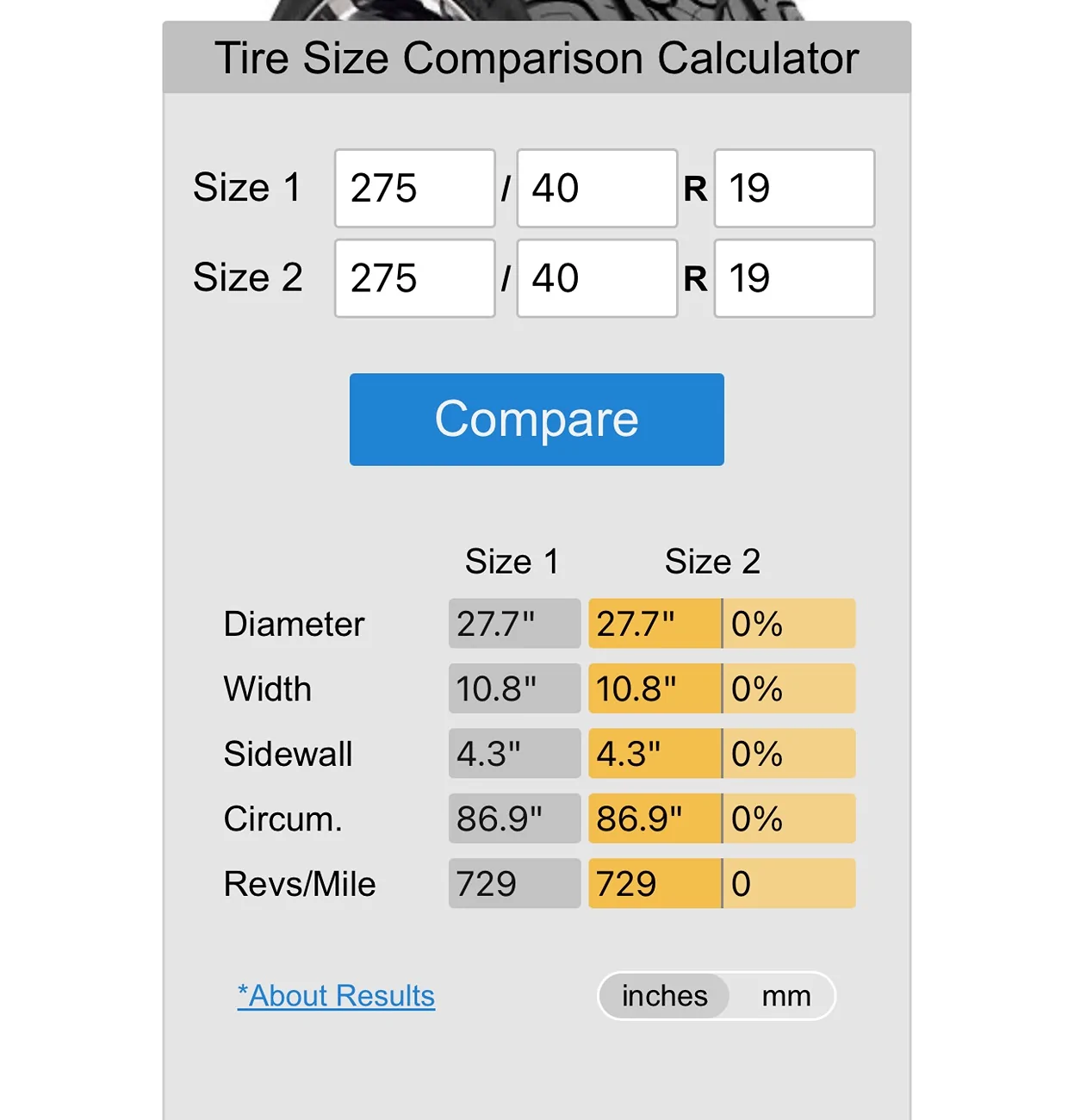

So i just installed FP tune on the car, and i was told that if i changed my wheel size i should change rev/mile with procal 4 device. So i found 6 different calculators, and three of them show 729 other three show 752. My tires are 275/40r19. Manufacturer website shows that tire diameter is 27.7. Tire racks shows tire diameter is 27.66. So im little bit confused, i think 729 is the right number, but any clarification would be welcome. Thanks

Do it yourself? The math is simple...
1 mile Ă· circumference = rev/mi
Convert mile to feet and circumference (diam x pi) to feet.
Tirerack also shows this value in the specs... that's what I used when I did mine the other day...
