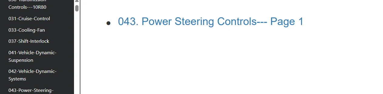

So this is what I have for my 2024 and it's not "official Helm" but that other company.....
S650 Mustang Help with HelmsInc service Manual for '25 DH 1773176610549-r

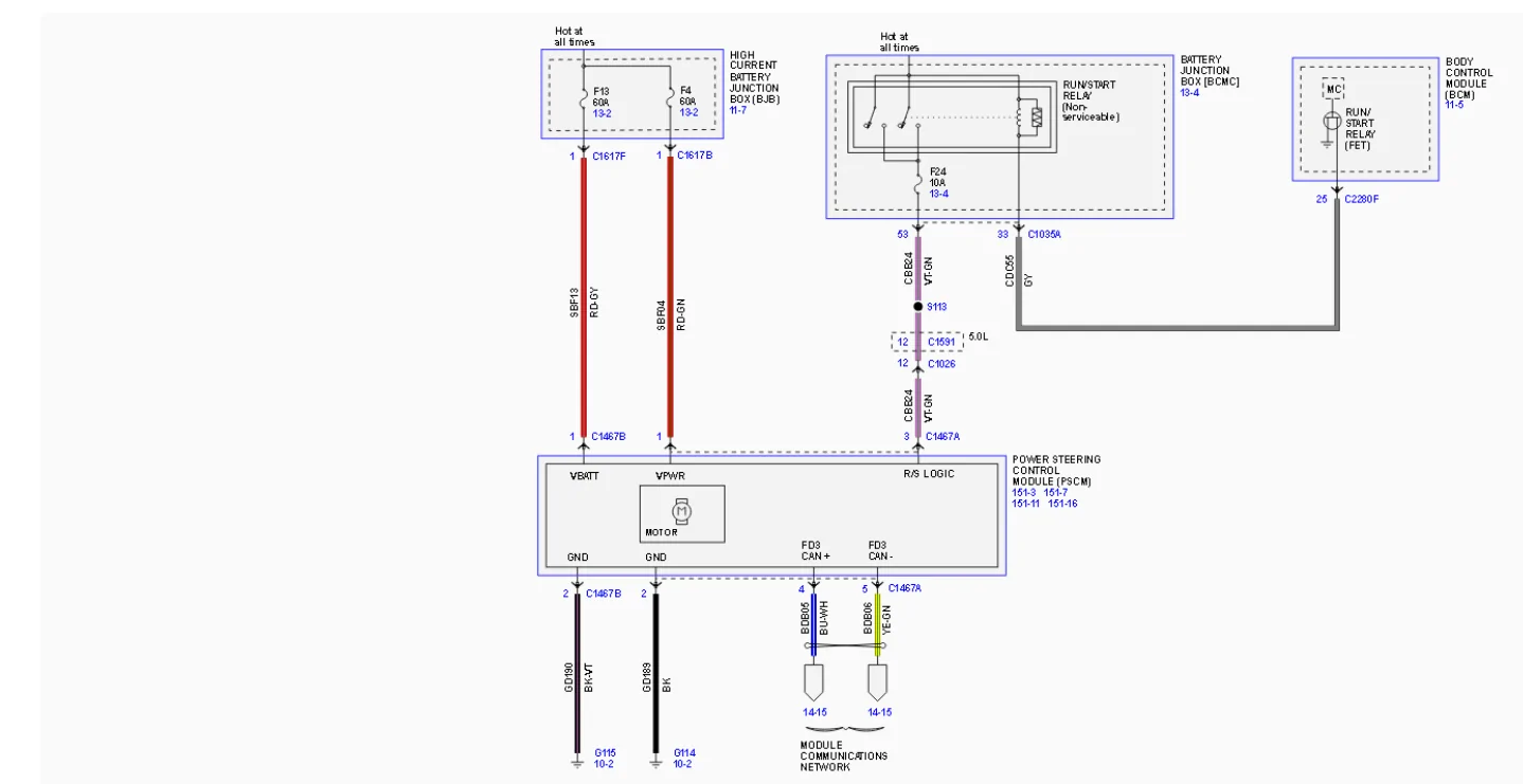

Clicking on the abovegives this:
S650 Mustang Help with HelmsInc service Manual for '25 DH 1773176737143-st

Thank you so much for the quick replies and for confirming my craziness. Now I can get on with trying to understand how to dissect and manipulate some of the electrical systems to accommodate the transformation of the DH into our '56 F100. Never a dull moment!
