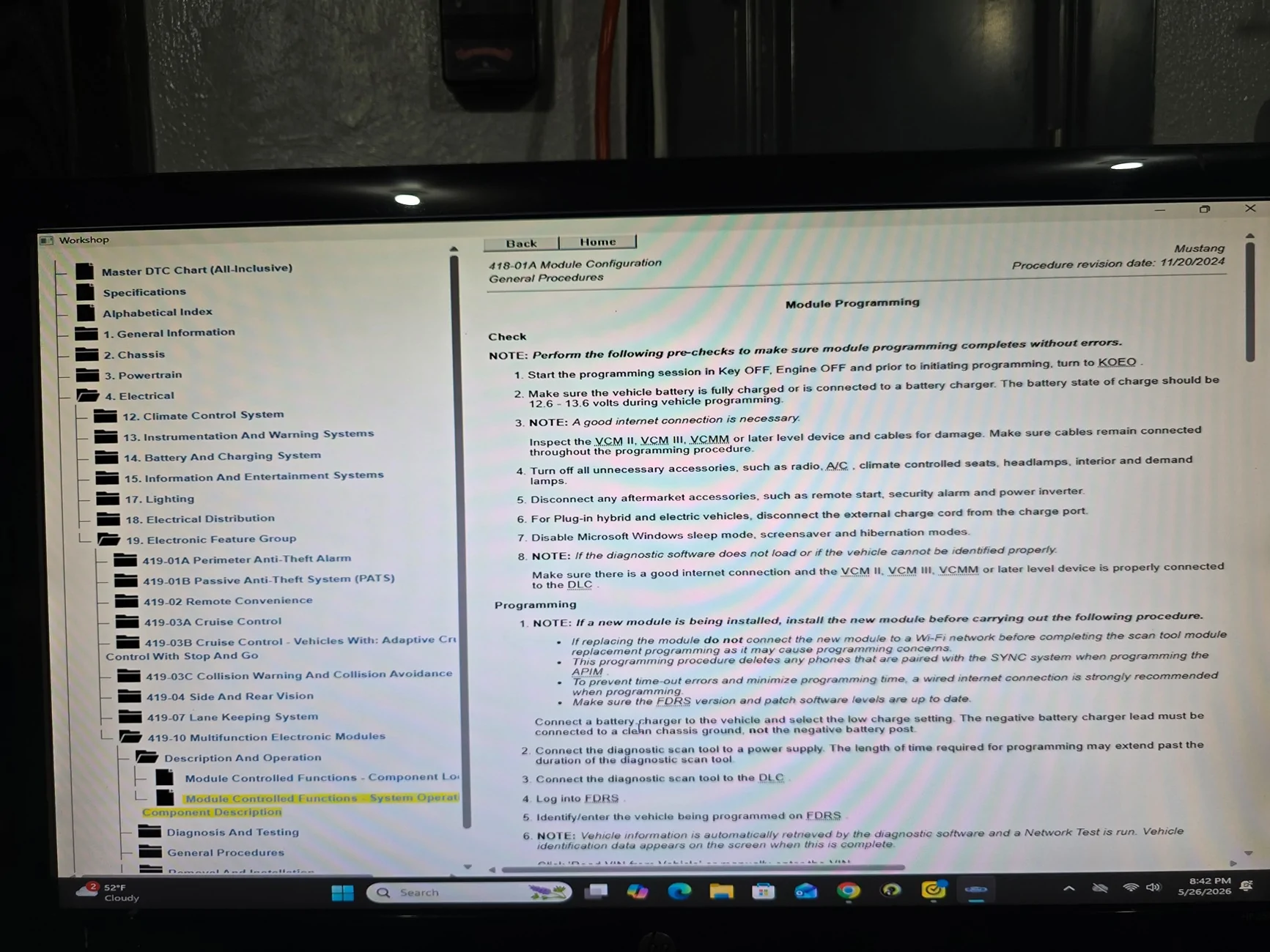

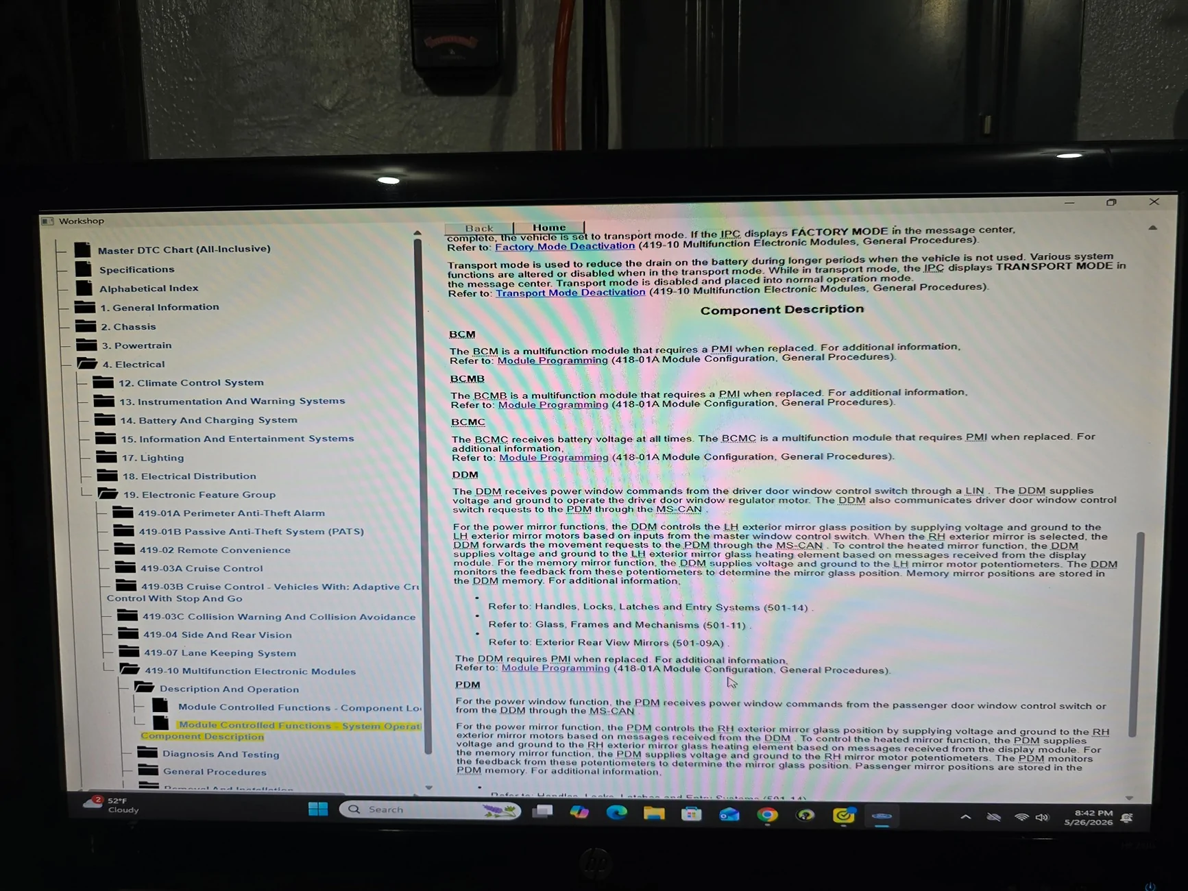

I have an older Lenovo P51 laptop Intel Core i7-7820HQ CPU@290GHz, 32GB RAM, 477GB Storage and Nvidia Quadro M1200 HD Graphics, Windows 11pro. At 73 all I know about what I just wrote is where to find it. That being said the following is one of the paths that boots me out and shuts itself down;
From the workshop manual side click on 4 - electrical/19 - electronic feature group/419-10 multifunction electronic modules/description and operation/module control function-system operation and component description - BCM - click on module programming ---- and we're booted out
As I was writing this I was also tracing it step by step. This time it it froze @ module control function-system operation and component description

You got me curious. I also got booted out of the program following your path thru. OK, forget the cheap clean laptop idea.
