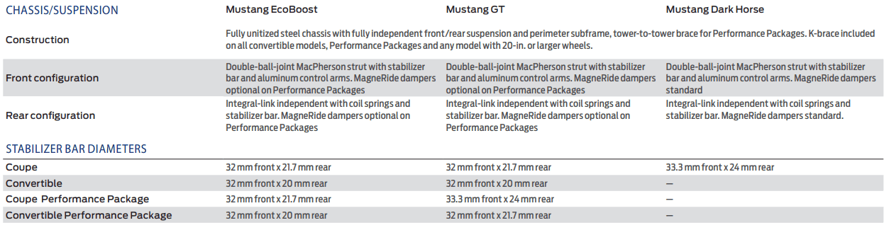

Street hooligan here. I'm wondering if anyone has swapped the front performance pack sway bar out for something heavier/stiffer.
I'm already lowered on Steeda progressives so I'm concerned about making the ride too harsh for a daily driving, but I've noticed it's not quite as planted as I'd like on hard turns
Thoughts? Pfa

If you got Steeda Progressives already then stick with Steeda Sway Bars as they're meant to work in tandem as a system.
I agree it's under barred once you start to find its limits. I started with Steeda Progressives and Sways and worked my way to Ford Performance Track Springs and Sways as I preferred the linear response on the track and on the street. The Ford Performance Track Sway Bars are 37MM in front and 25.2MM in the rear.
