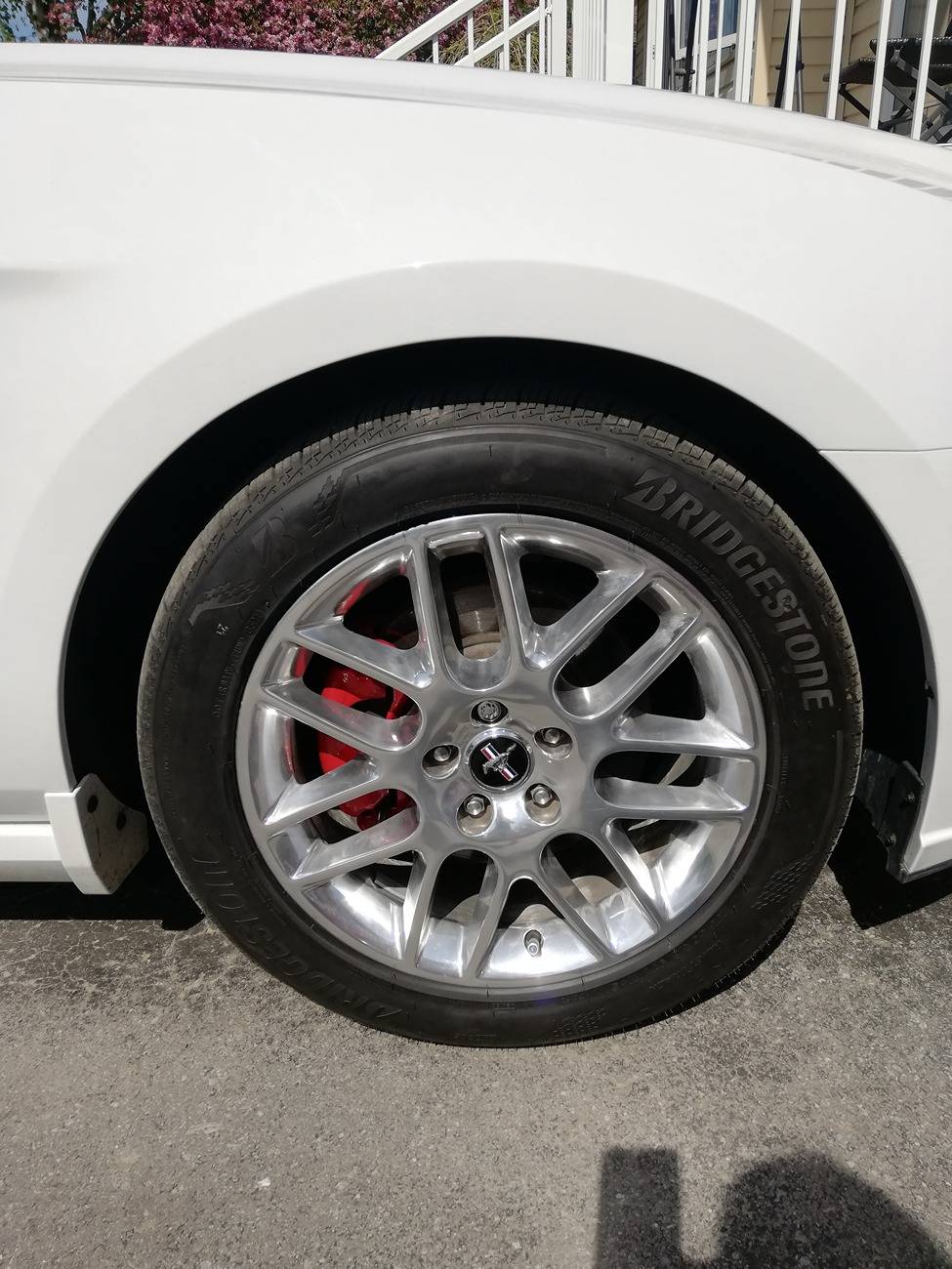

@20ducks ..... @cosmo73 is not only correct but to do the job correctly you will need muchos dinero. There are several DIY coatings you can apply after you degrease, sand and clean with acetone then alcohol. Those coatings will not be affected by heat but brake fluid will dissolve them. The only slightly permanent solution is to take them apart and have them ceramic powder coated. A time consuming and very expensive procedure. I have attached a picture of a former car of mine a 2014 Mustang that I used aftermarket epoxy coating. I did not take them apart but used tape to tape-off all parts and tiny professional artists brushes. I did this because the boss (aka the wife) wanted red calipers on her car. Never again would I do that - and certainly not on a new car. I am not a big fan of the blue either but if I were you I would "learn to love" the blue color, at least it will last.

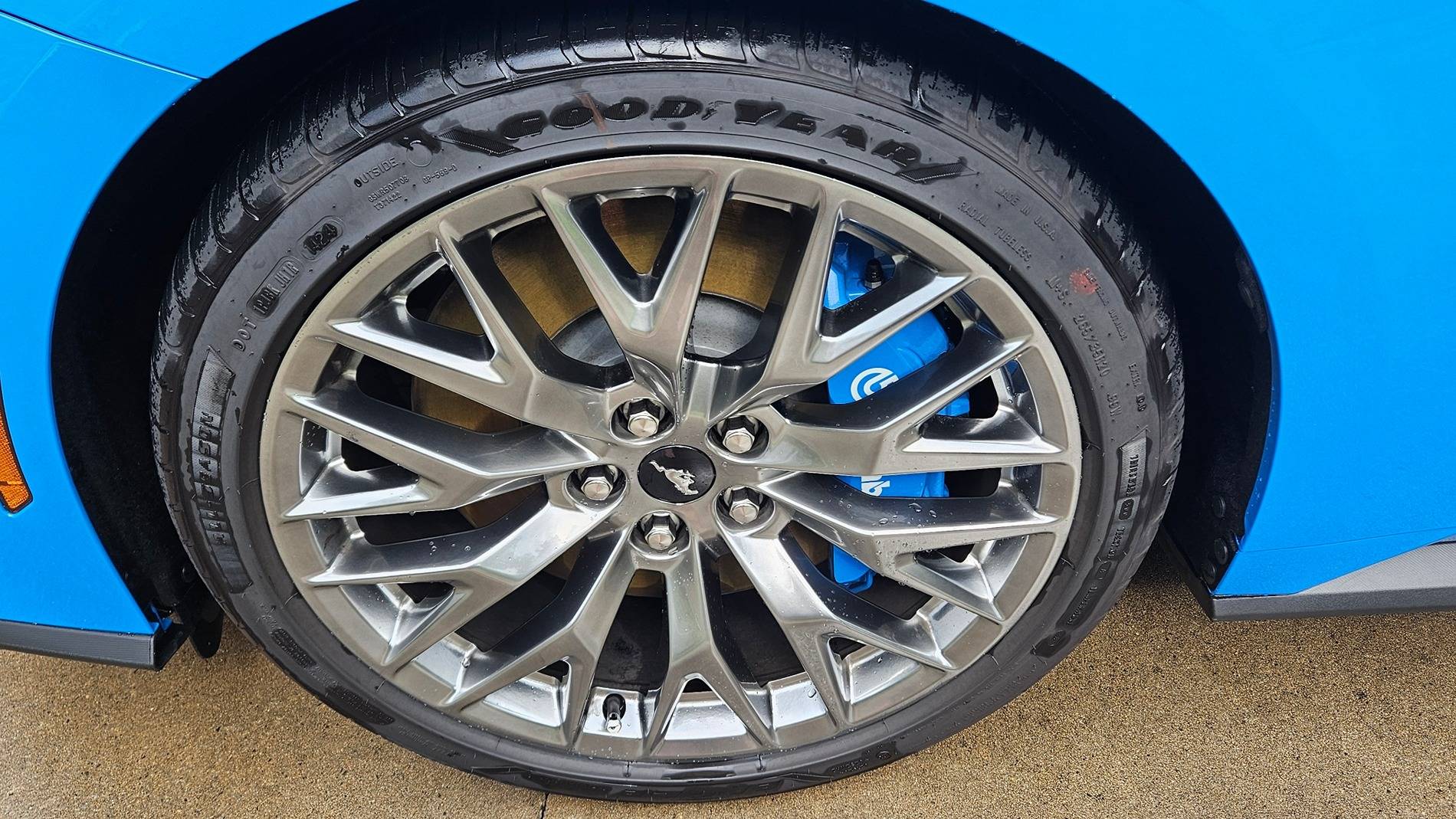

Grabber blue on Grabber blue. I love em. Sorry you are disappointed in yours.
Same here and I proudly state it in my sig.

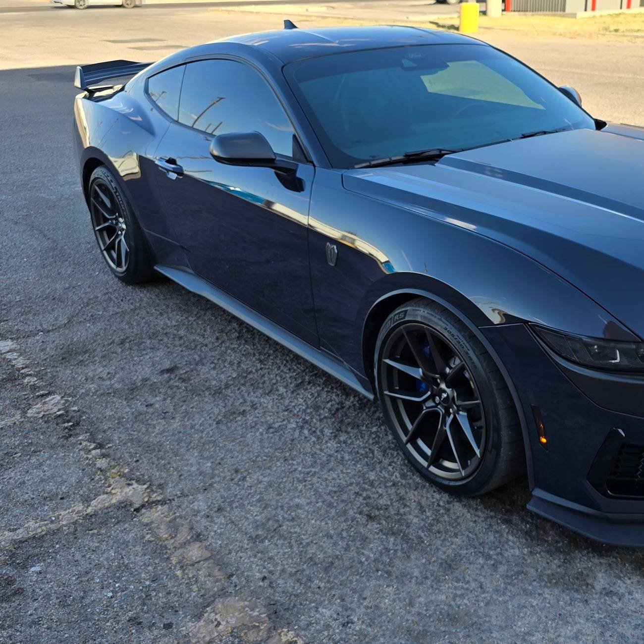

My DH/HP came with the same GB Brake calipers, but The Dark Horse has the Deep Blue interior accents so it makes more sense on here, unlike a randomized by some Ford employee that didn't give a sh** what other people want.. anyway, at least you won't have "red-bo's" like literally EVERY BODY ELSE...
Not to mention.. Blue on Black is the New Red on Black these days!
Good Luck!
P.S. remember you'll have to paint the ENTIRE Caliper Assembly because these aren't just covers!
