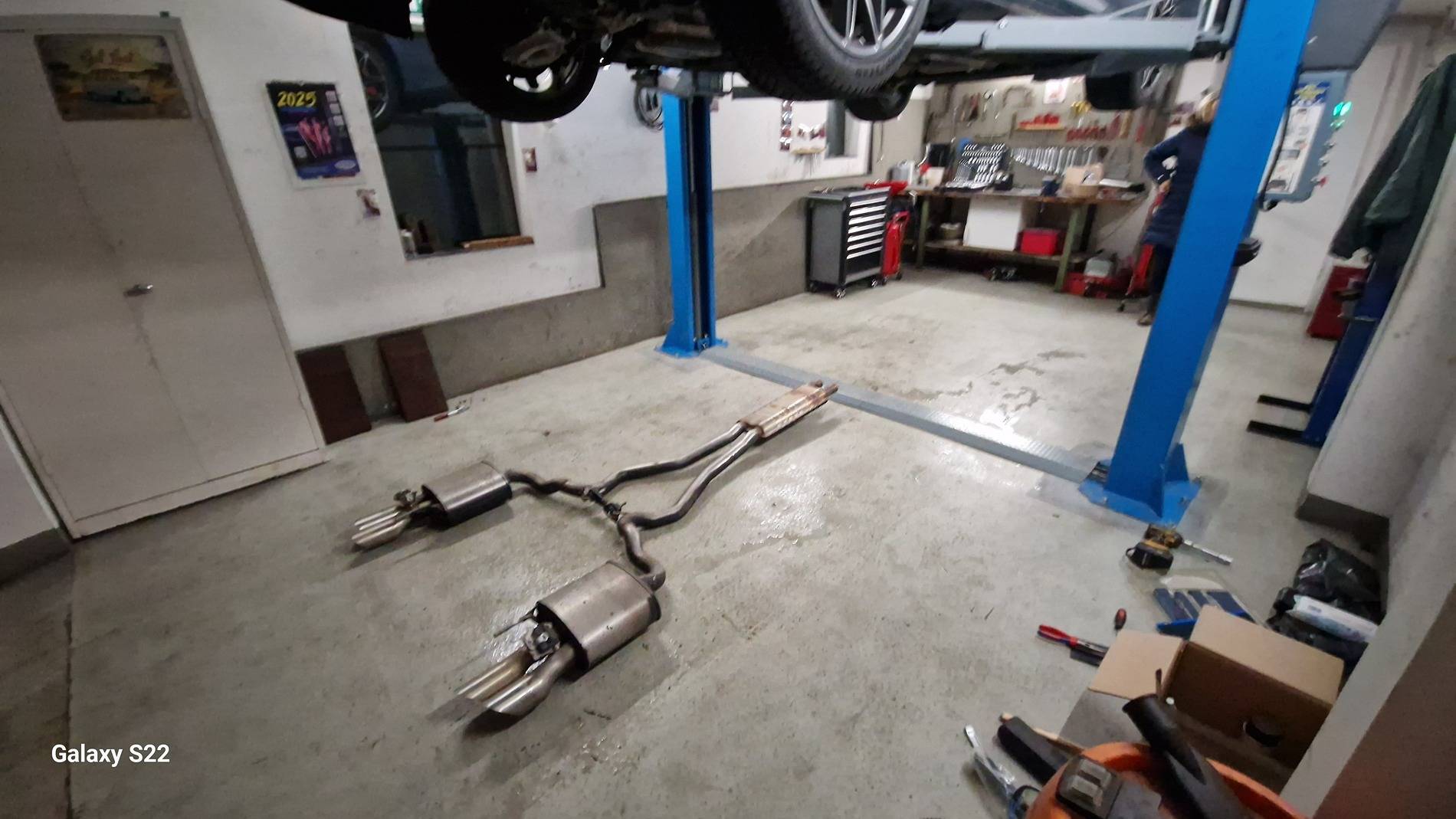

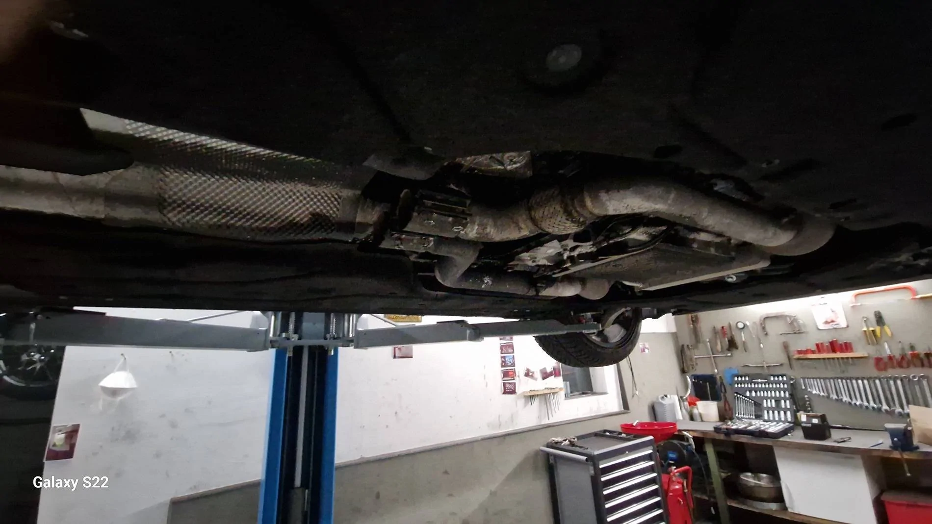

I live in Switzerland and will delete the resonator today. Unfortunately it's cold and raining and I'm coming down with something and it's gonna be late and dark. Also, since I neither have a helping hand nor a tripod, I'm not gonna be the one providing a before/after-video of the EU Gen7 with the H-pipe.

I can confirm that it is a significant improvement. More bass, more rumble, clearly louder. No drone. I'm quite happy and don't think I need aj aftermarket cat-back exhaust. Especially not one that some call quiter than factory.

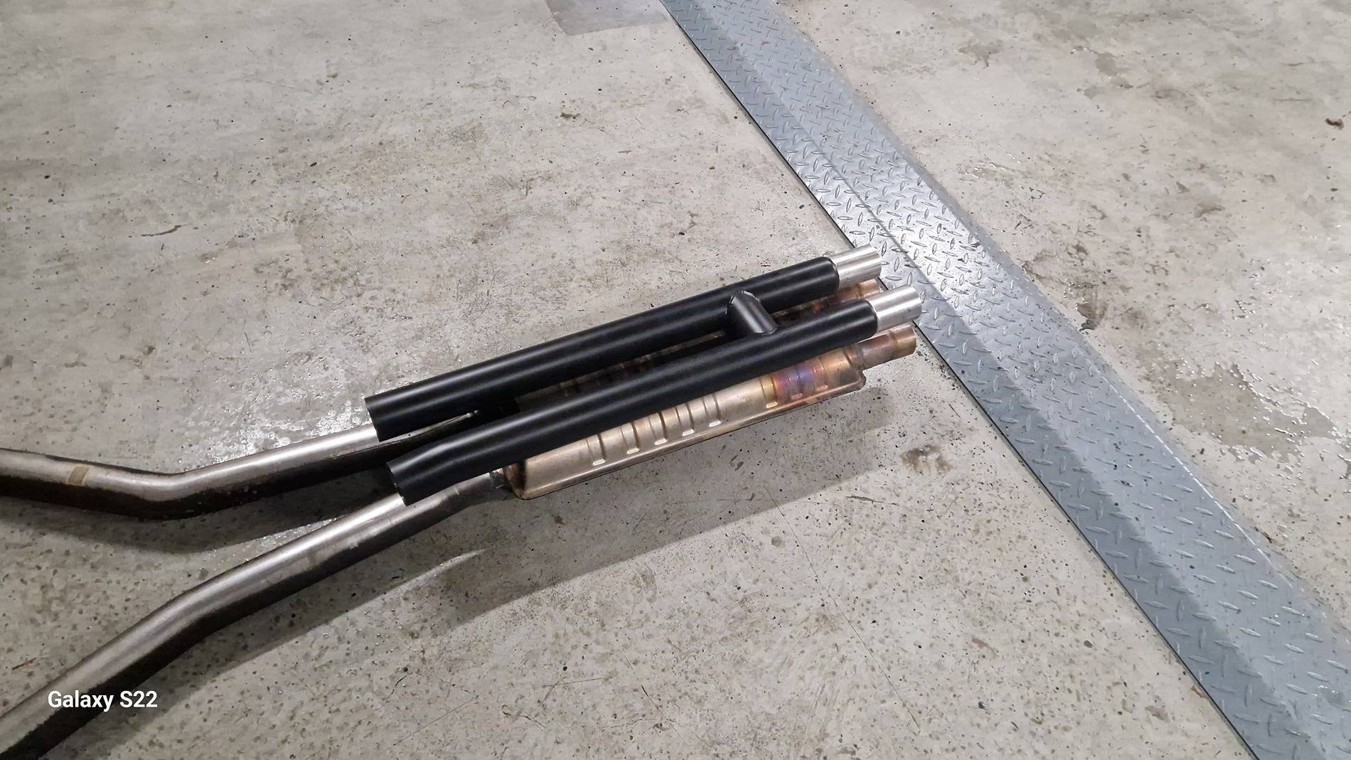

Thanks! What's the reason you removed the whole thing? To cut it easier?
And what brand is that H-pipe? Did you painted it black?

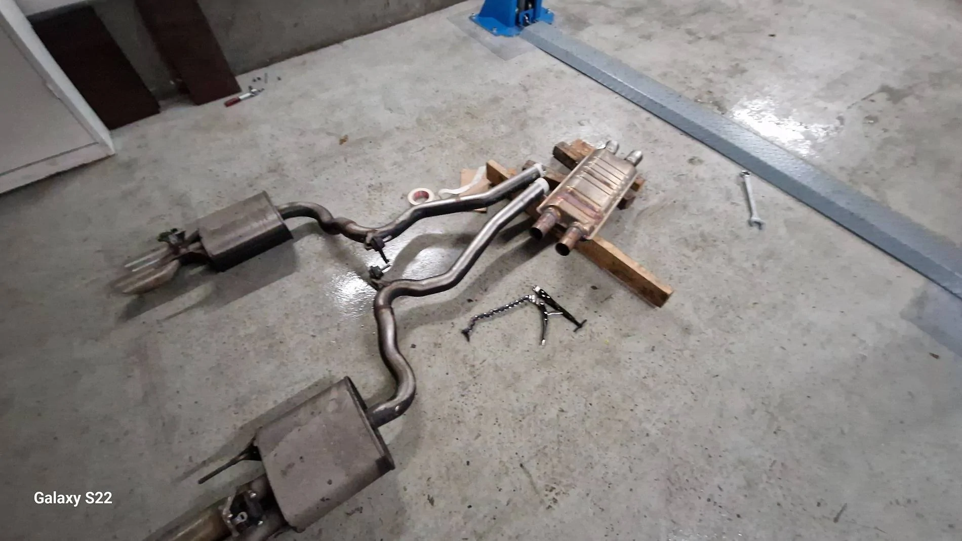

I used a chain cutting tool and wanted to meassure the length of the cat-back remainder as presise as possbile. I thought this would be easier with the resonator inlet exposed and the whole thing on the ground.
It is a Steeda H-pipe which connects butt-joint style. I chose it because I think (but I'm not sure at all) it can be welded easier if necessary (muffler rotation). It is painted black because the new car already came with an almost entirly black-coated underbody and I wanted it to blend in.
I used this clamp to prevent problems with muffler alignment:
Vibrant Performance 1171 TC Series Heavy Duty Exhaust Clamp - 2.5in
