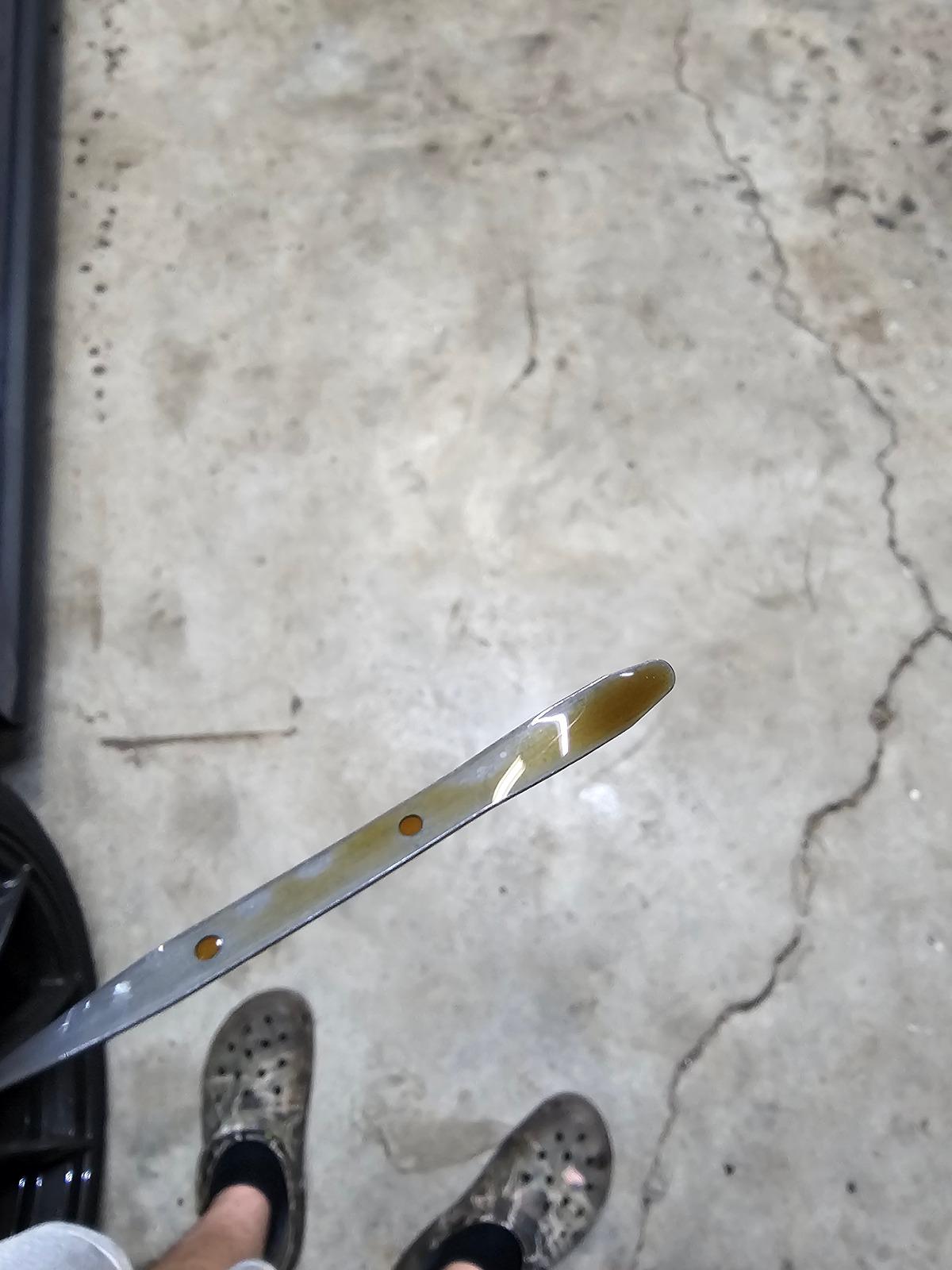

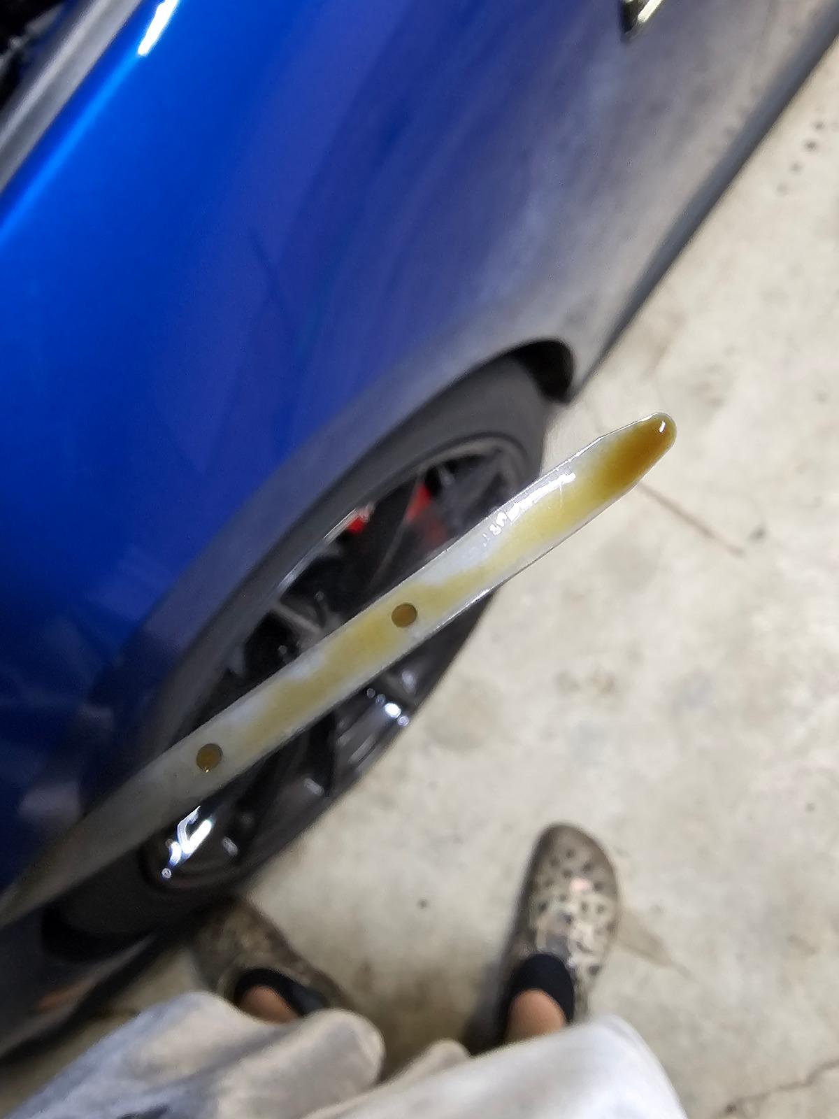

Does this look normal for 4,000 Miles, full synthetic?

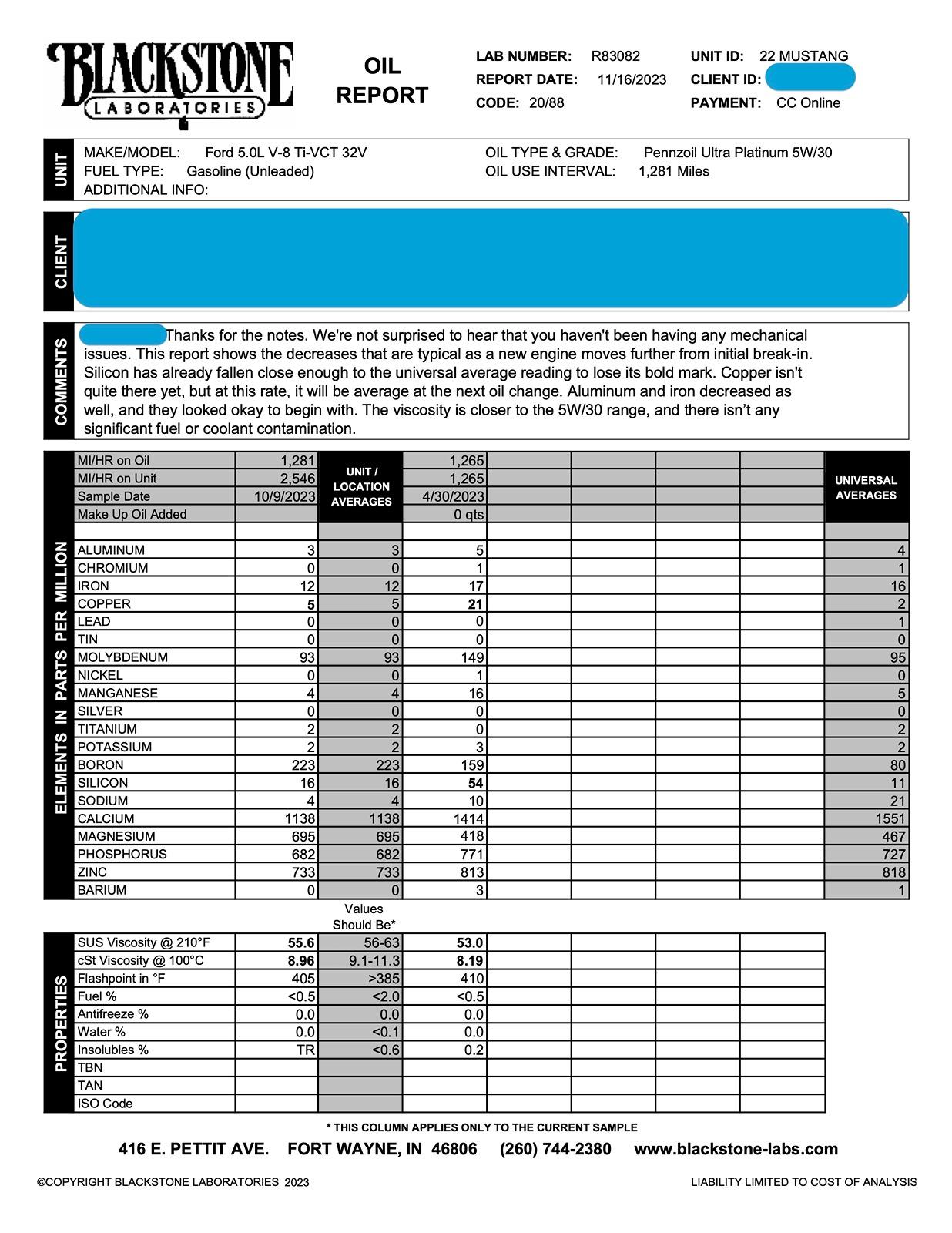

I plan on sending a oil sample to Blackstone on my next oil change to be sure nothing is happening internally.
I saw this before. It's all good.
Yes, they can quantify water, coolant, fuel, etc. The attached is an example. See the bottom section.
A kit request and shipping are free. A person pays when the sample is sent in.
https://www.blackstone-labs.com/products/free-test-kits/
The sample is returned via USPS, in the received pre-paid envelope.
Edit: I don't think there is a limit on kits. Maybe request two? You'll run one sample and hold the other for Ford.

I’ve seen worse. For 4k not bad. imo, If it was an active ā€˜seep’ a bit more milk would be in that shake.
That was after a 8 mile drive home from work, checking it completely cold make a difference?
4,702
2,564
Wouldn’t hurt to do one of each so you can see the diff. Kinda like knowing what it should look like even though she’s sitting at an angle.
although in this case, not really. You’re looking for the tell tell signs of mix not results of usage/combustion but the addition of water/glycol ….
