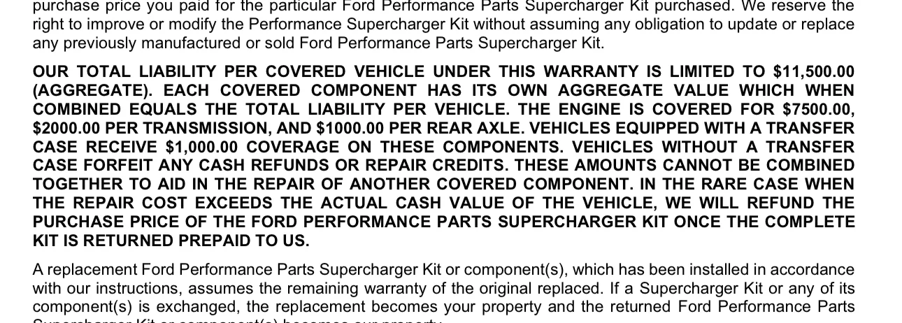

I thought the limits on Ford Performance's warranty had some piss poor low dollar amount for max payout. I think 6 grand was way over that figure.
Depends on what breaks. This is from the previous model.
