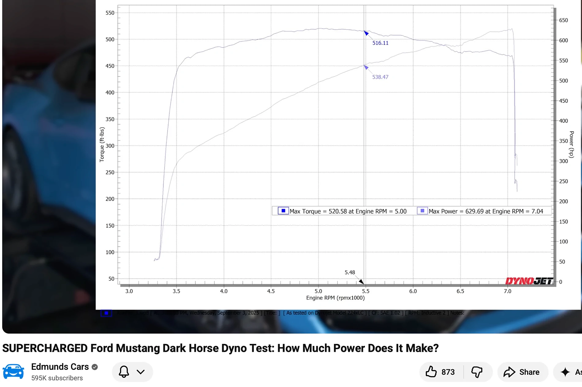

If the plugs weren't gapped right and it was misfiring they would have felt it and known something was wrong. It's very obvious when it happens.
It doesn't sound like it's doing it in the video and the dyno chart would be all choppy if it would have been misfiring.
