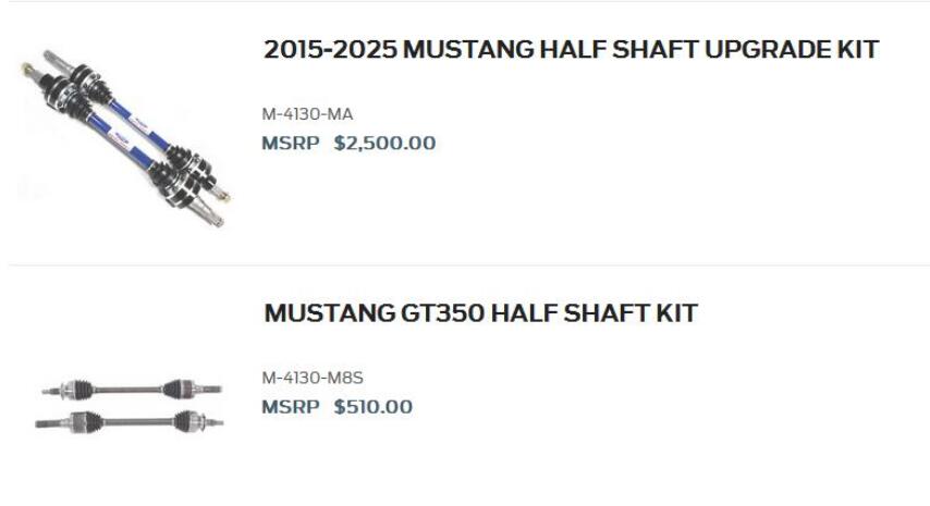

Should be able to get better price, 510 seem high unless MSRP went up 25%
Have you seen the prices of anything lately? Eggs, need I say more?
Also that's the price from Ford performance directly. It seems like CJ Pony Parts has them for 407
