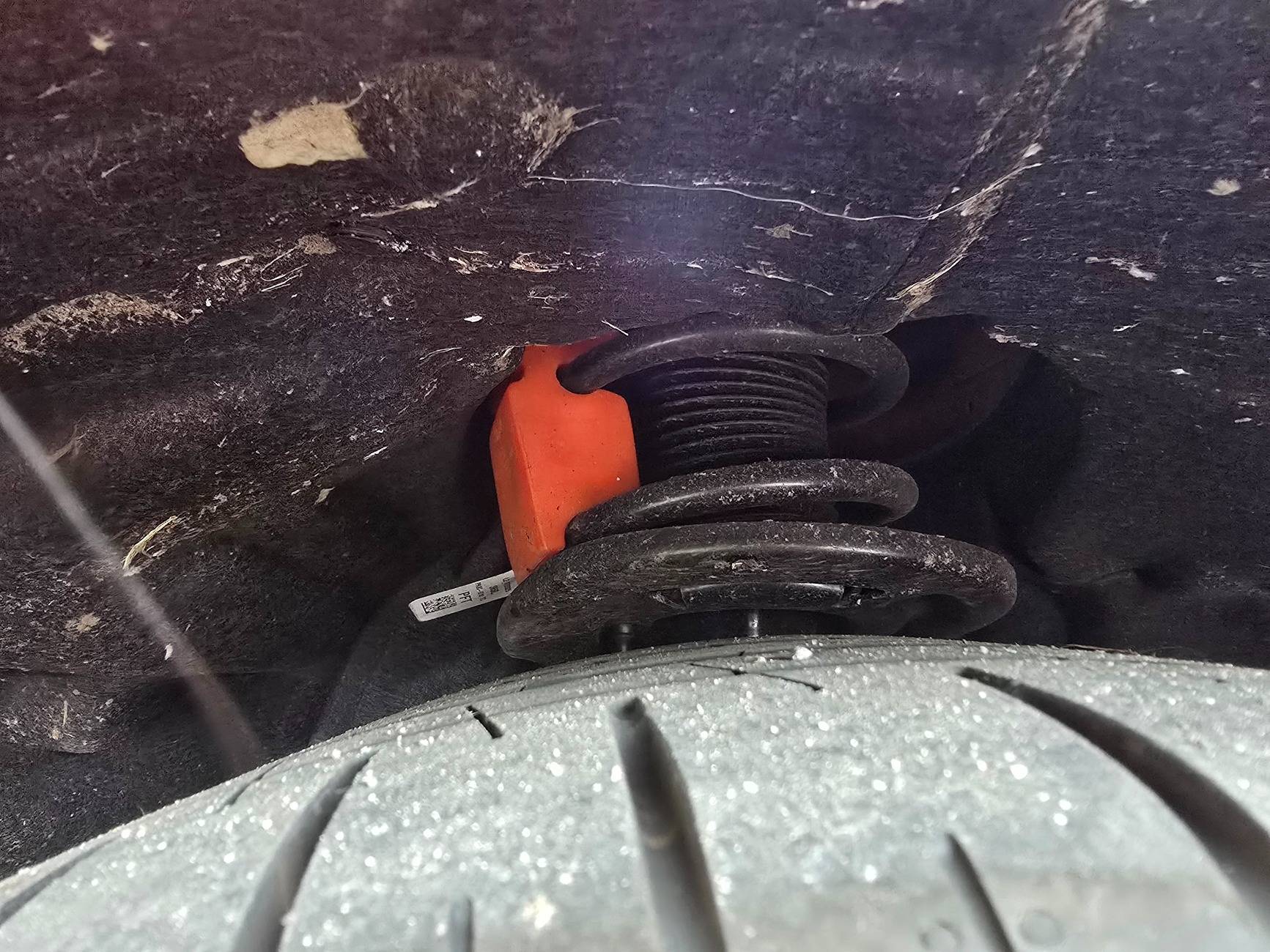

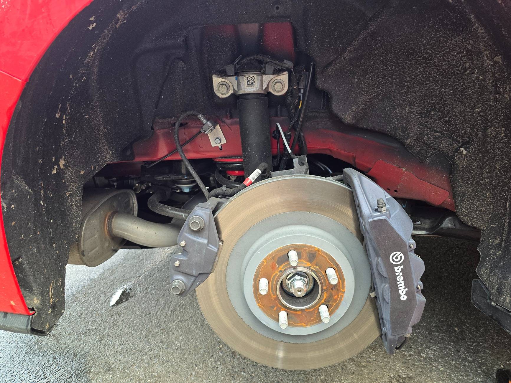

I just noticed my DH still have the rubber suspension shipping blocks on the passenger side.
Question is do they have them on the rear also?

I think only clearance issues in the front for loading and unloading. my car was not set up at the dealer did it myself. i did not have blocks in the back. kind of weird it's only on one side though

2024s did not come with rear shipping blocks. It appears to be the same for 2025.

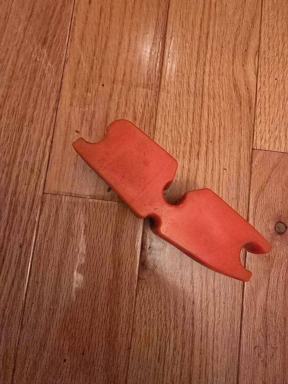

From the attached:
"If equipped, remove and store the yellow or orange spring spacers from RH and LH front coil springs in the red plastic bag included with the Ford Performance customer packet
(Dark Horse). (See Figure 1)
If equipped, remove and store the white or orange shock spacer blocks from RH and LH rear shock rods in the red plastic bag included with the Ford Performance customer packet
(Dark Horse). (See Figure 1)"

I took delivery of a 2025 DH w/o Handing Package in Dec 2024. It only had the suspension shipping blocks in the front. My Ford service advisor said that the rear suspension shipping blocks are only on DH's with the Handing Pack. Can anyone with a Handling Pack DH confirm this?

I took of the wheels and didnt seem like the blocks are on it. I haves DH non -HP
