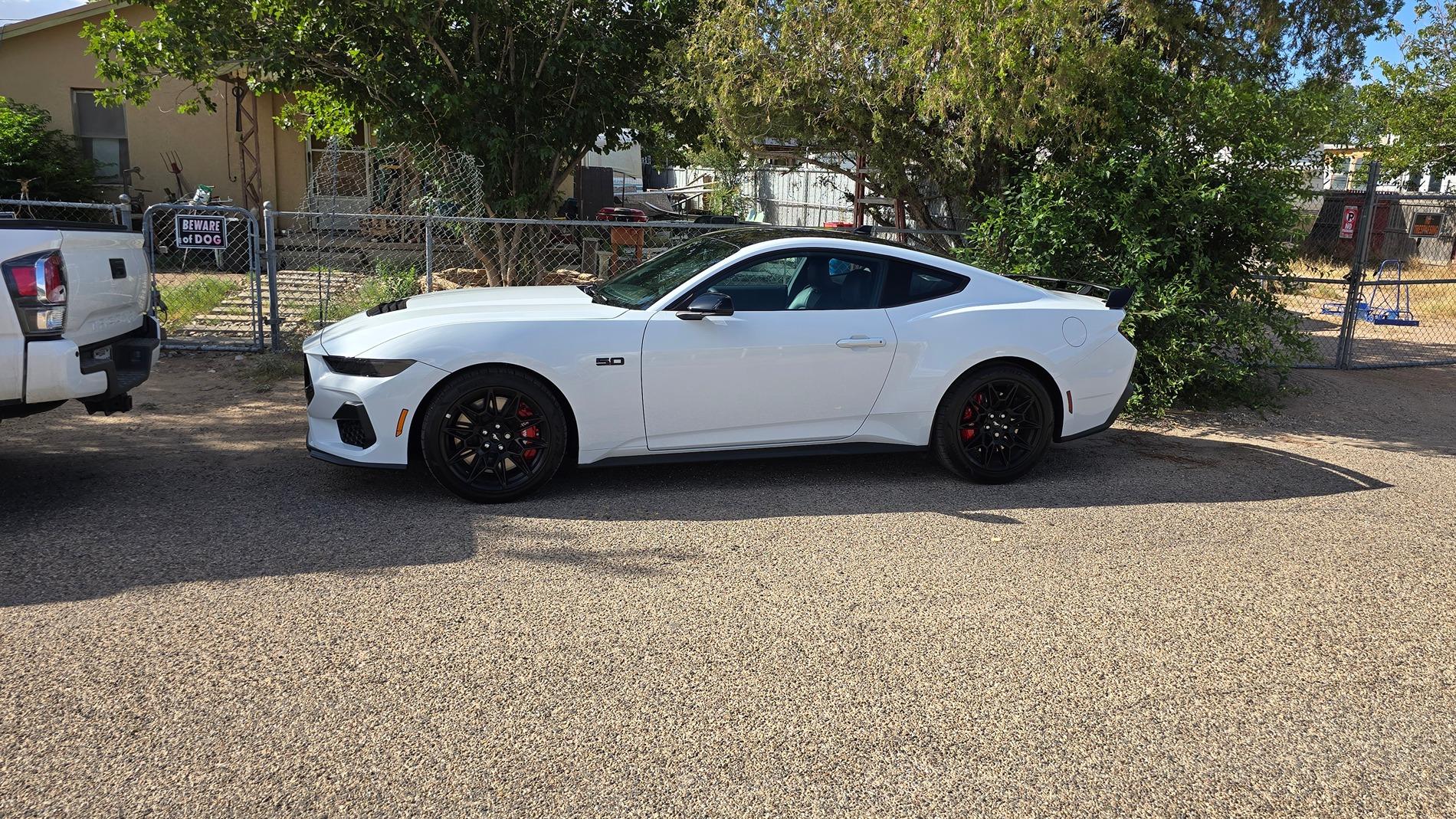

Bought a Custom ordered S650 that someone else had built and deal fell through on, was told that the ONLY THING MISSING was Magneride.. I didn't need that! I was so happy and then I got home, decided to look over my Custom Moroney Sticker/Window Sticker and saw that despite having the 401A package, I was missing a few of the pinnacle items of that package, such as; 12Spkr B&O, Ford 360+, ADV Cruise, Memory seats. BUT! it has lane keeping, Heated and cooled passenger and driver seats that are both power, heated steering wheel, Nite Pony Package & The Performance Pack! 9 Speaker premium audio, the big connected screens, no NAV though...
My point is I got most of the 401A package but the person who did the ordering must have removed some key features.. My sales lady said it's the performance oack that made it end up missing a few of the features buy kept the important stuff.. to have lane keeping with frontal crash avoidance but not have 360 and advanced cruise control seems ridiculous asf to me... js anybody else get stiffed on features?
