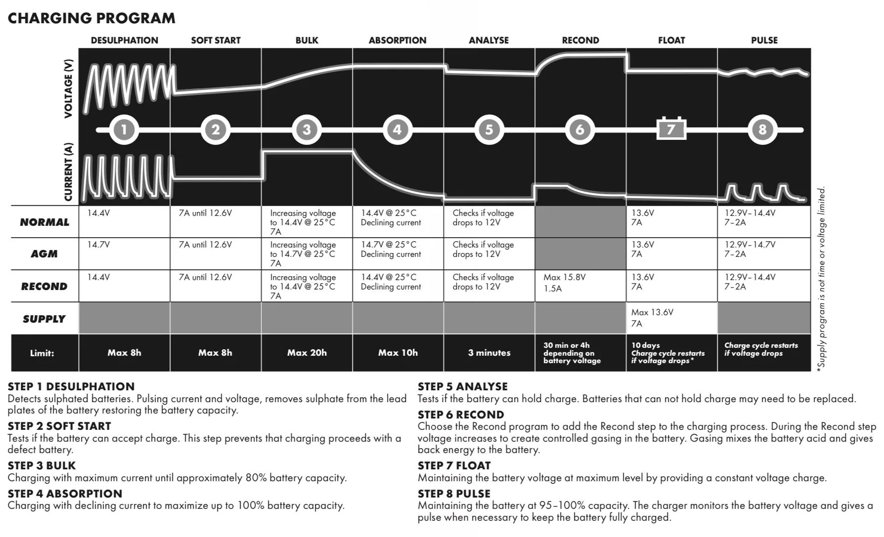

Like many, I've installed a battery tender and conditioner to the car's fuse box under the hood. When I park the car in the garage, it's a simple matter of hocking up. The plug is external.
I'm grateful with the setup. After 4 1/2 months of Winter storage, the car started as if I'd turned it off moments before. Others have commented how their batteries have lasted quite a bit longer (not having to replace).
* Tender or not, the car will still enter Deep Sleep mode. I just ACK the alarm and leave it connected.
S650 Mustang Deep sleep mode battery tender stages
