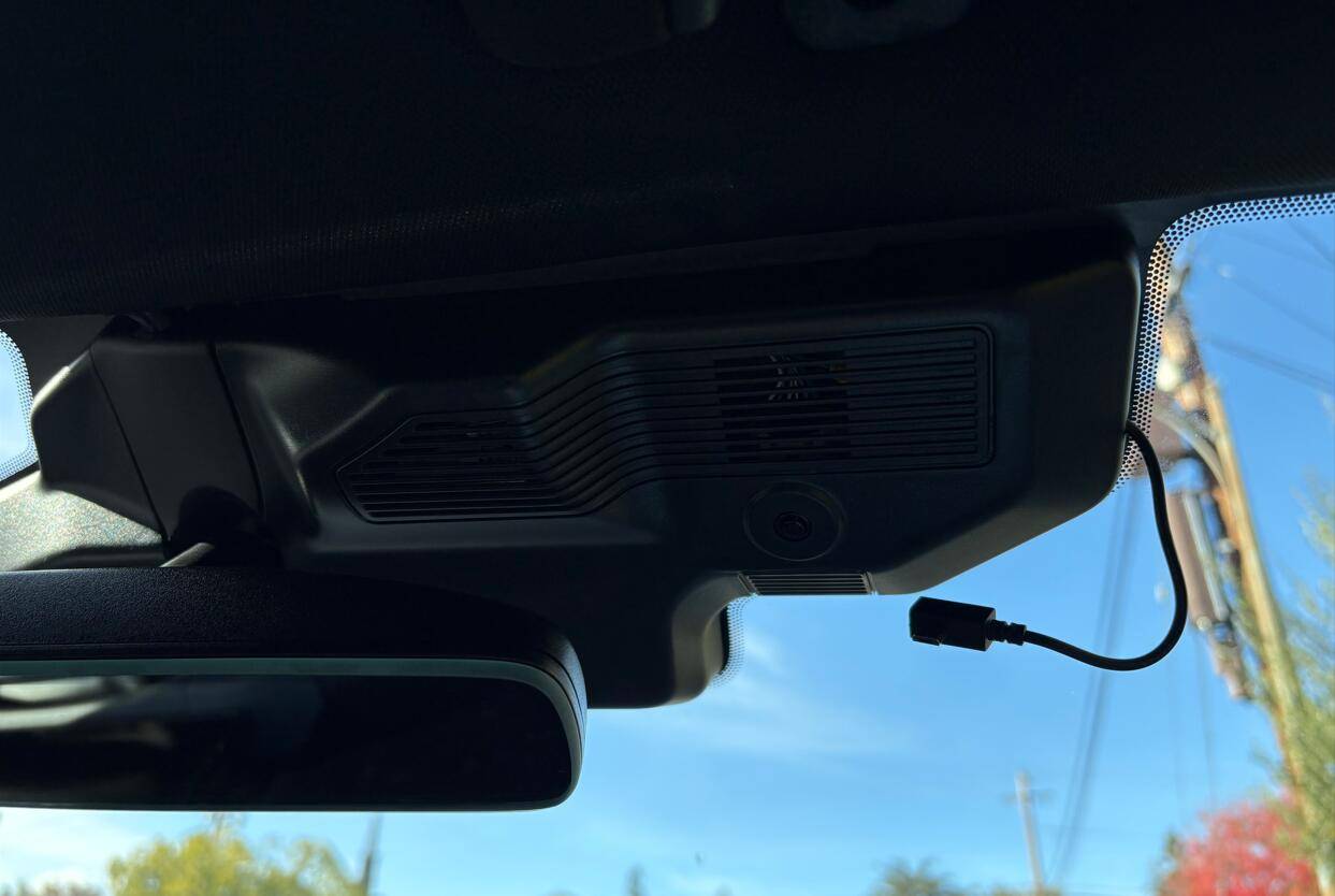

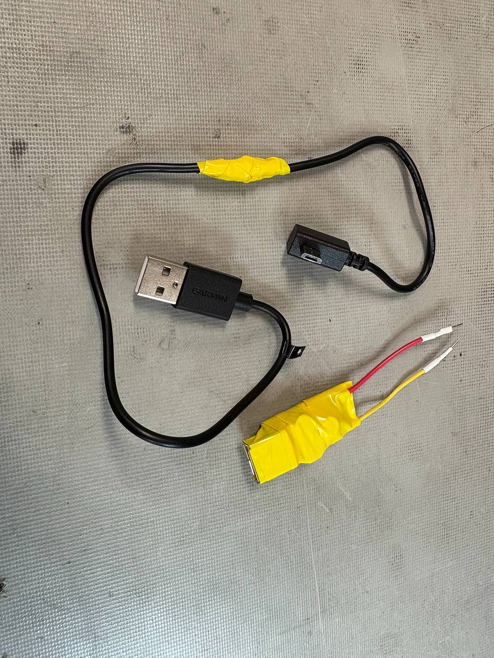

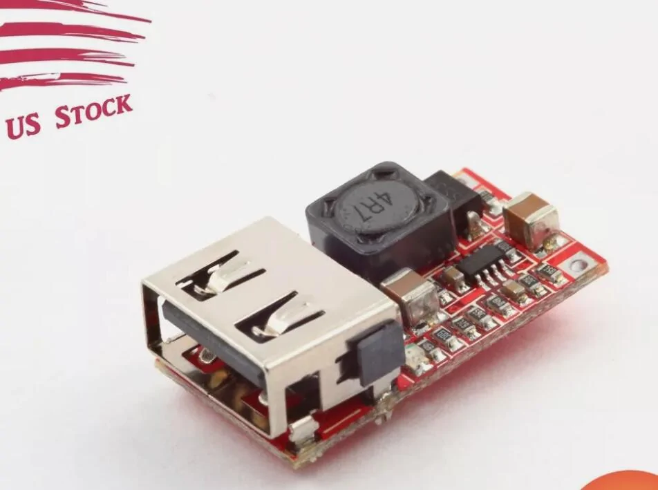

I purchased a tiny 12V to USB 5V adapter from eBay for less than $2. Opened the cover behind the mirror and installed it there. Then shortened the dashcam USB cable and plugged it there. Turns on when car on, and turns off when car off.

So I did not get it power from PP USB port. I bought a 12V to USB adapter shown above for I dunno $5. And the pictures tell the rest of the story.
