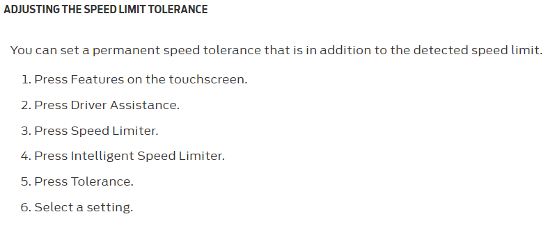

So, The Dealership called me today and ran through a few settings, and one that is new and I had never heard about previously. There is a Tolerance setting and my salesman set it at +20 when I got the car. Even the dealership has no idea why anyone would need this setting. If I want to drive 68 or 85 on adaptive cruise, that is where I want to be. I do not want to go 20 mph over that.

the "tolerance" setting allows your adaptive cruise control to do up to 20 over or 20 under the speed limit it's seen. it also takes the tolerance into account when it sees a higher or lower speed limit and adjusts

So is this tolerence setting something that we (the owners) can easily adjust?

Don’t have my Mustang Dark Horse Yet but on my Mach E GTPE when you have speed sign recognition turned on with adaptive cruise control you can set a tolerance (normally I drive 5 to 7 over the posted limit) so when the zone is recognized by the cruse instead of 70 it will do 75 or what ever you have set. It seems to work well but where I live a lot of the side roads are not correct in the Ford System it is not seeing the sign it is going by the data that is submitted to the mapping company. The street leading up to my street is marked 35 and my speed limit sign on the dash says 55.

1. Instead of being quick to blame the victim, who we should be criticizing is the Salesperson who was jockeying around with the OP's settings (unbeknowst to them) and delivered the car to him in that fashion. It's perfectly reasonable for the OP to have the expectation that they're receiving a retail order with factory settings without having to micromanage every nook & cranny of the vehicle with a fine tooth comb.
2. The manual isn't really all that clear with respect to how the "Intelligent Speed Limiter" (which is apparently the official name for this "tolerance" we're discussing) interacts with the Adaptive Cruise Control. This is all relatively new technology and it's understandable that some wouldn't be able to easily make the connection between the two.

S650 Mustang Cruise control out of control, found possible issue! Tolerance set to wrong value 1695319808548

If you always go 5 MPH over the speed limit and don't want to adjust when you go through a small town on the interstate, it can read the 45 MPH sign and drop down to 50MPH, then back up to 80MPH when the sign says 75MPH. I'm sure it's not perfect though and I haven't had a chance to use it, but it's a smart way to combine the intelligent cruise feature with your own preferences. If you don't like it just simply turn it or both off and set cruise manually
