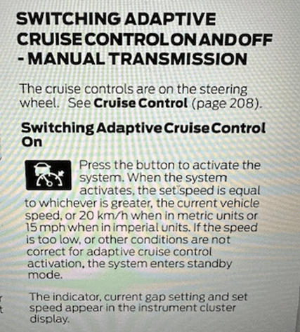

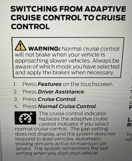

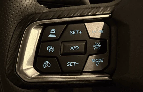

Is there a way to switch between regular cruise control and adaptive cruise control on the steering wheel? I found a way to do it in the menu after reading the owner's manual but I could swear I have used both without using the touch screen before. Keep hitting or hold the gap button maybe? I keep getting adaptive cruise control not available messages but it doesn't tell me why. It seems to just work at random. I'm wondering if I should try cleaning the radar it uses with anything particular. I just cleaned a couple bugs off of it, cleaned the forward facing camera and I'm going to test it again later tonight but I'm wondering if I got some detailer on if I should clean it off with anything particular. Apparently the button right below the adaptive cruise control button it is just a speed limiter and you have to keep your foot on the gas for it to work.

I just press the adaptive cruise control button on the steering wheel and it works as intended.

And be careful about the intelligent speed limiter button. I accidentally hit the button one day and was trying to merge into traffic and couldn't figure out why my car wasn't accelerating. Luckily, there was no one behind me while I was trying to switch lanes and merge onto the on-ramp. I didn't even realize an intelligent speed limiter was a thing until this vehicle 😂
Me either. I'm coming from an old 2012 Cruze with cloth seats. I was trying to use it thinking it was the normal cruise control instead of adaptive cruise control, it automatically set a speed limit in accordance with the posted speed limit and I thought the car was stalling on the highway.

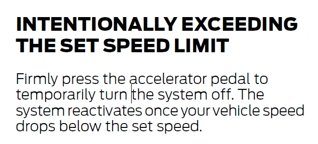

The gas pedal always overrides the cruise control. Not sure I would even attempt to merge into traffic while relying on cruise control. Merging means you adjust your speed to match traffic.
This was not cruise control, but the speed limiter function itself, which means giving more gas will NOT override the feature. I know you can override the cruise control feature.
3,260
3,709

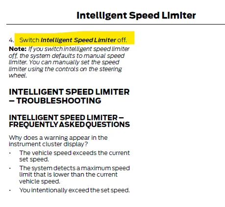

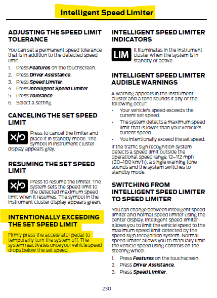

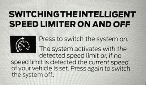

In the owner's manual on page 229-231 (Intelligent Speed Limiter):
S650 Mustang A Couple Cruise Control Questions 1711469375378-g1
S650 Mustang A Couple Cruise Control Questions 1711469331414-f
Tolerance for the Intelligent Speed Limit is covered on that page as well.
Eurasianman
Jan 8, 2024
342
264
Alabama
Good find. I'll have to remember that next time. I wonder if there is a way to just disable that button altogether 😅
