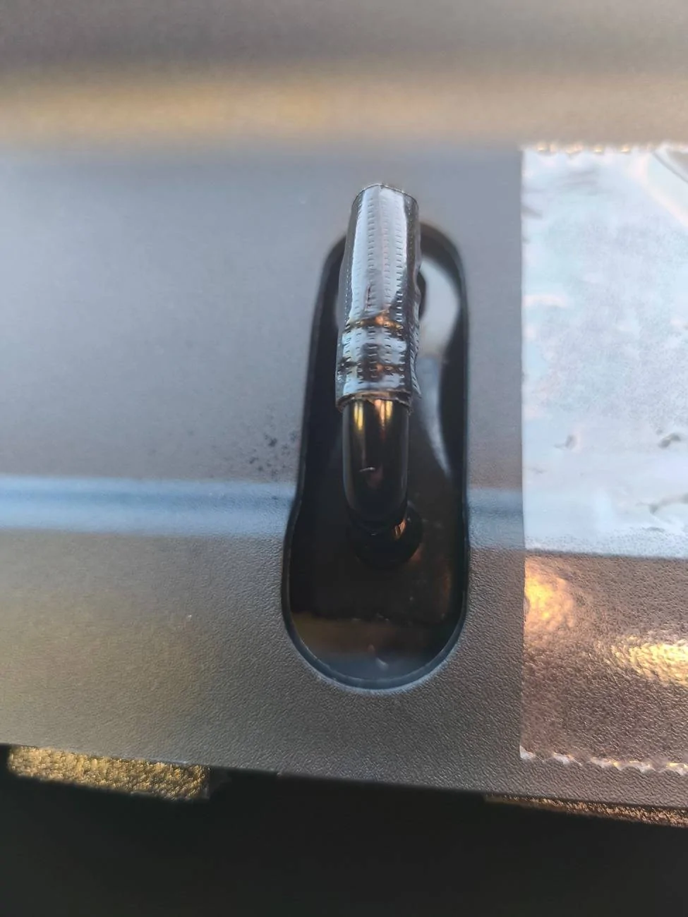

Mine had the creaking sound which sounded like the suspension at low speeds. Lowered both rear seats down and the creaking went. I wrapped some insulation tape around both of the latches where the rear seats clip into and no more creaking.

There are 2 adhesive pieces of insulation/foam to the left and right of where the seat clip is. They are between the plastic and the metal leading into the trunk, to dampen vibrations or whatnot.... Those pieces of foam got unglued, and shifted downward, and were now squeaking. All I did was re-glue them with Gorilla glue for left and right seats, and the annoying squeaking went away.
It sounded like 2 pieces of Styrofoam being rubbed against each other under certain conditions. Ultimately it was caused by the ... 2 pieces of foam rubbing against the plastic/metal, since they had shifted.
