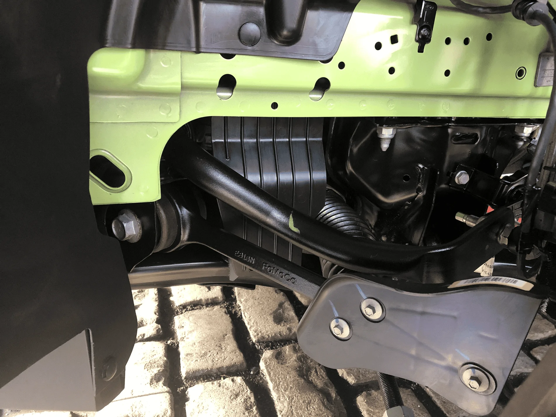

I had the same on my S550 and it turned out to be part of the front wheel arch liner was folded up over the suspension.. It was the ridged plastic bit in this picture.
thanks for sharing. I have a feeling it could be this. Are you talking about the plastic on the left? How did you access in there and what did you do to fix?
The ridged bit (centre screen) was flipped up over the lower suspension arm - just pushed it back into position. Done with the wheel on full left lock
