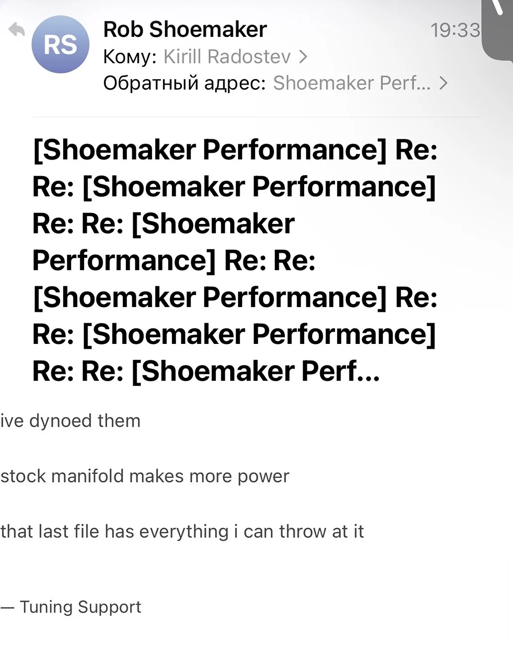

Your 7.7 run was on a cold day. 5 Celsius is 41 degrees Fahrenheit. You can't really compare that to a run at almost 80 degrees Fahrenheit.
Rob, do you mean Rob Shoemaker? He put it in writing that it makes less power than stock?

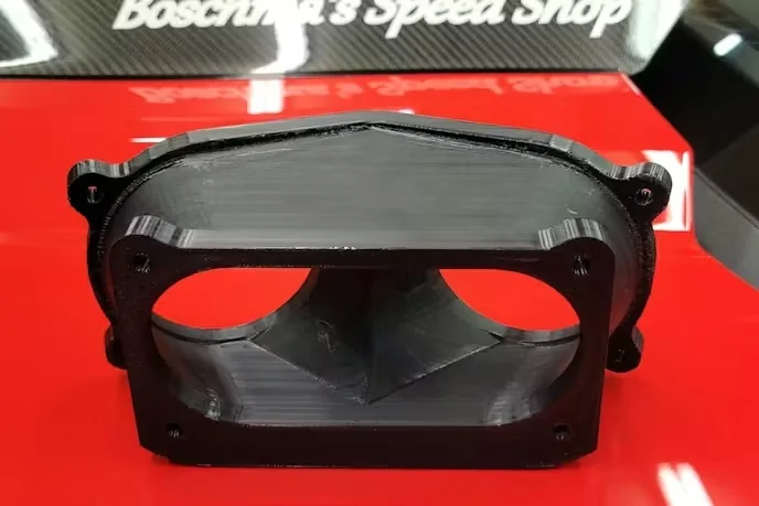

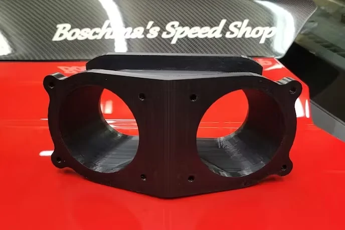

I mean, Boschma's car was tuned by Shoemaker. (Boschma is the maker of that adapter you installed with the two throttle bodies).
I have not seen anywhere that it loses power compared to stock.
robvas posted the dyno curves above. But click on the link and read the caption under the dyno curves.
please send link on Boschma’s tune that Rob made
screen of reply below

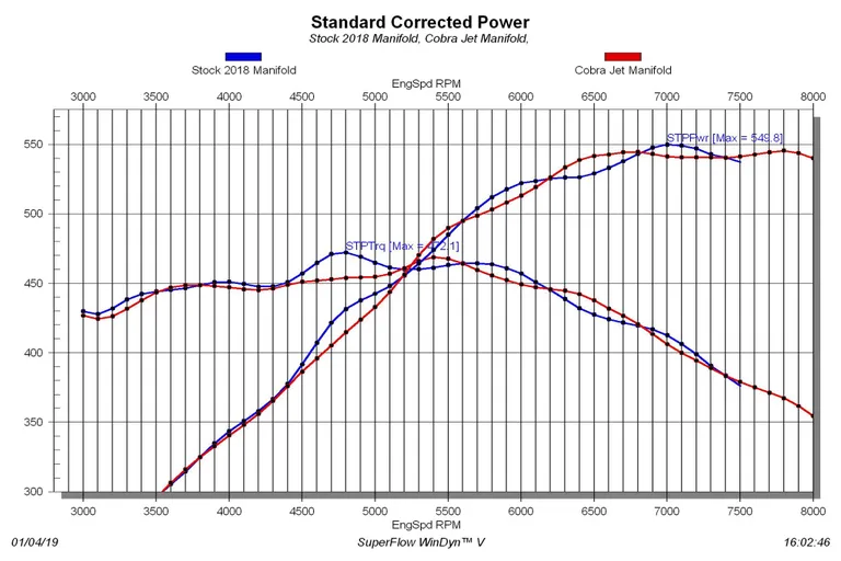

The Cobrajet is going to give you more usable RPM, not necessarily make more power at the stock RPM ranges. It may not make more power on stock cams (or if it does, just a tiny bit more near redline)
Do you have dyno charts of your car with both intakes?
2018 intake vs cobrajet but the idea is the same

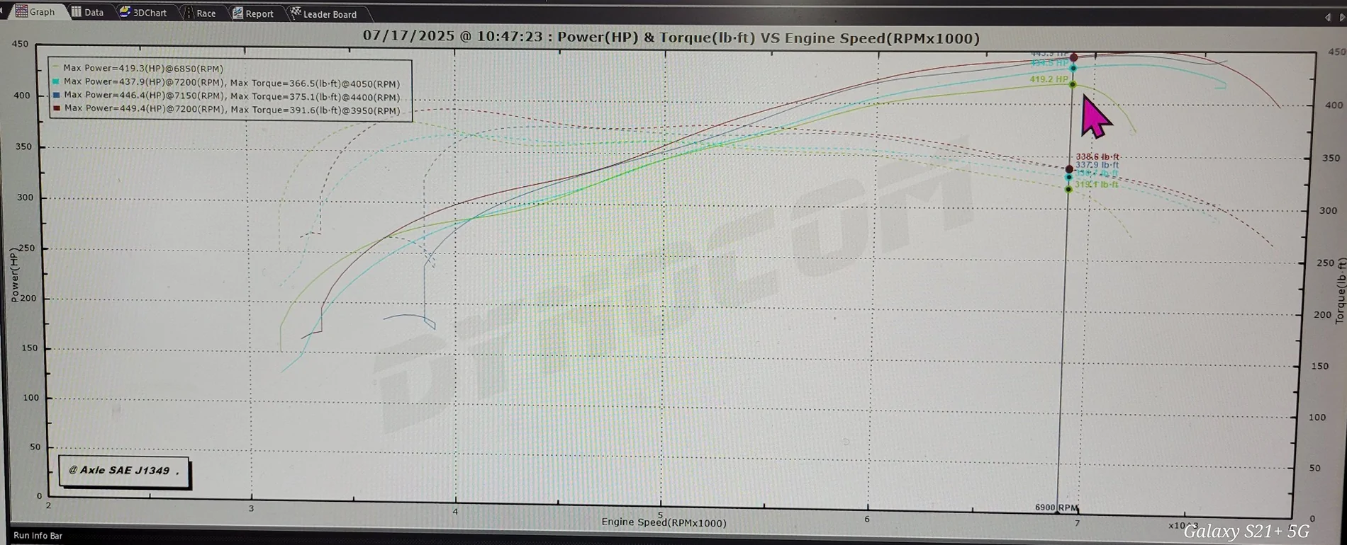

No, I have only stock manifold 540whp
Today installed Cobra and ran to highway for better numbers 🏃‍♂️

The stock intake performs really well, it’s not like the gen 1 coyotes, where we could slap a C.J. / mono and turn it up to 8500 rpm on E85 and see serious gains.
you really need to add cams to wake it up, but you’re basically gonna end up with “boost money” into a much slower N/A setup.
i would sell the intake and just run stock/E85 tune until you’re ready to add boost

When we did the Boschma's Speed Shop dual throttle body, GSC cams, and cobra jet intake manifold, we increased around 50 hp and 11 ft-lb of tourque. This was also on a Lund tune.
