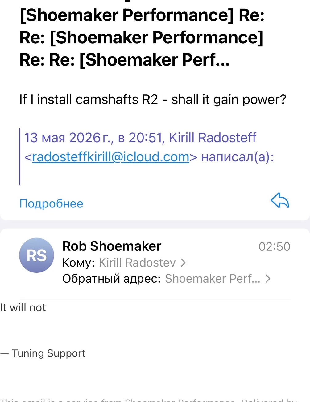

sir, please let know, if Install them
1. Shall I gain some power? How much? I have cobra jet and Steeda CAI + LTH
2. Will it be comfortable for daily use?
3. Do I need additional spare parts for this? Spring or smth?

I am not the rep, and I do not even have an R2 camshaft, but, yes, you need springs and titanium retainers (both springs and retainers are available for less than 800 American dollars), and, of course, a tuner who is familiar with the camshafts and the VCT system and how to use VCT to gain a smooth idle and the most power in the rpm range you are going to be using when accelerating. They recommend:
  • RPM (active VCT): 5,800-8,500 (~8,100 peak)
