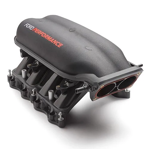

Ford has released a new Cobra Jet intake manifold featuring dual throttle bodies to support the S650 mustang!
The retail price is $1500. Porting options are already available from 1320 junkie.
Ford states the S550 may need hood modifications or aftermarket lower engine mounts to fit with the stock hood (no word on fitment for S650).
It will need custom vacuum line routing to fit auto transmissions (at least for the s550), but this was also the case with the previous cobra jet.
This intake has been redesigned and will support 20+ PSI and has been tuned for 7,750 rpm peak power.

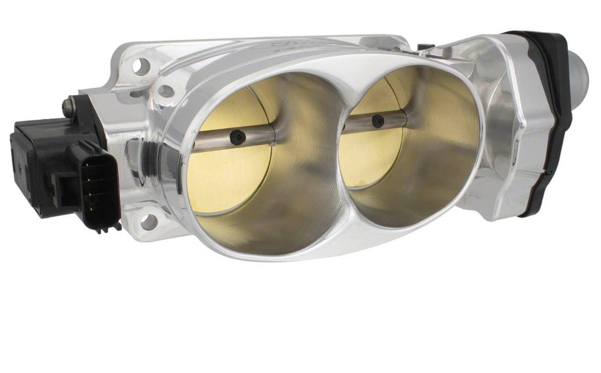

That is for the mono or the twin blade oval throttlebody not for two throttle bodies. Look at the mount, it only has four mounting bolt holes

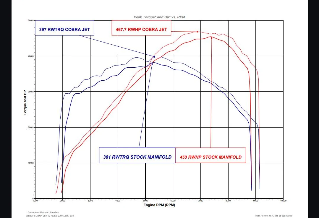

This is with headers and a flex fuel calibration.
Check out the video and watch where on the tachometer the car is shifting!

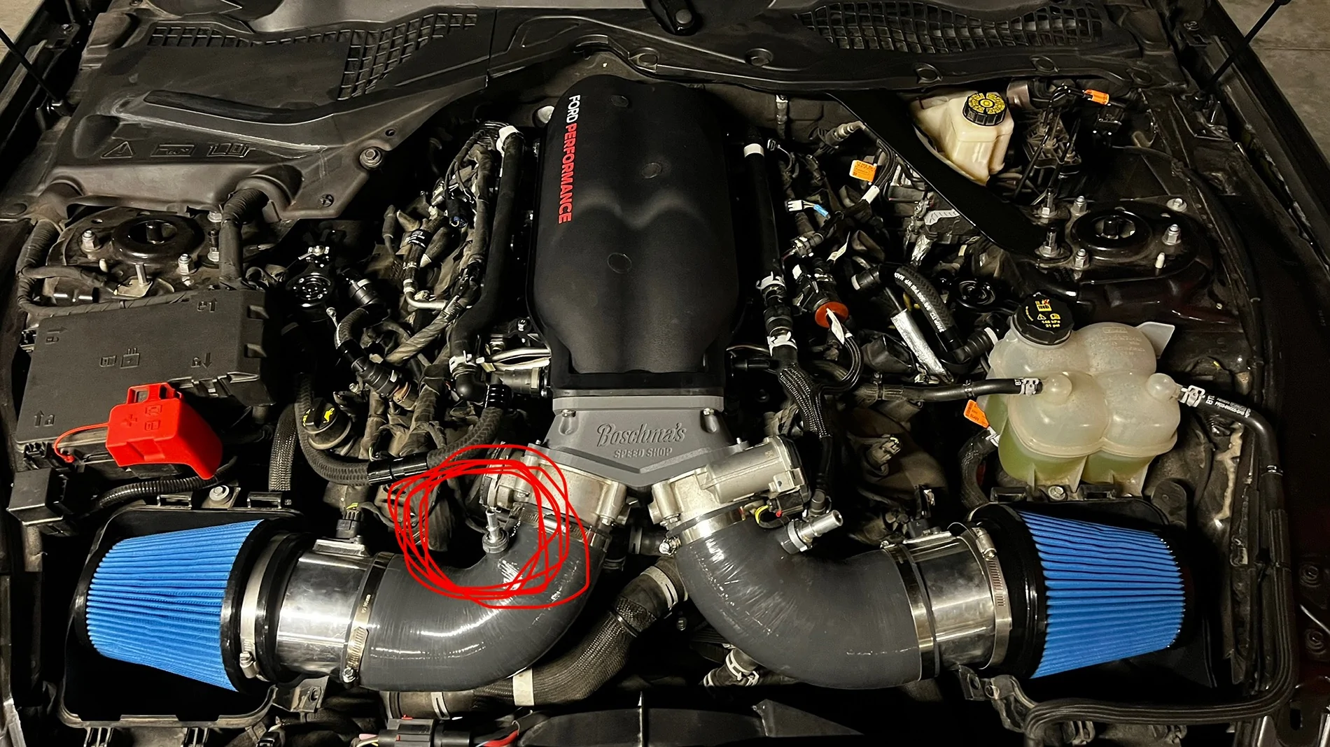

Dear Colleagues,
Help please
today installed CJ intake and have some questions
1. I don’t know what to do now with this hole?

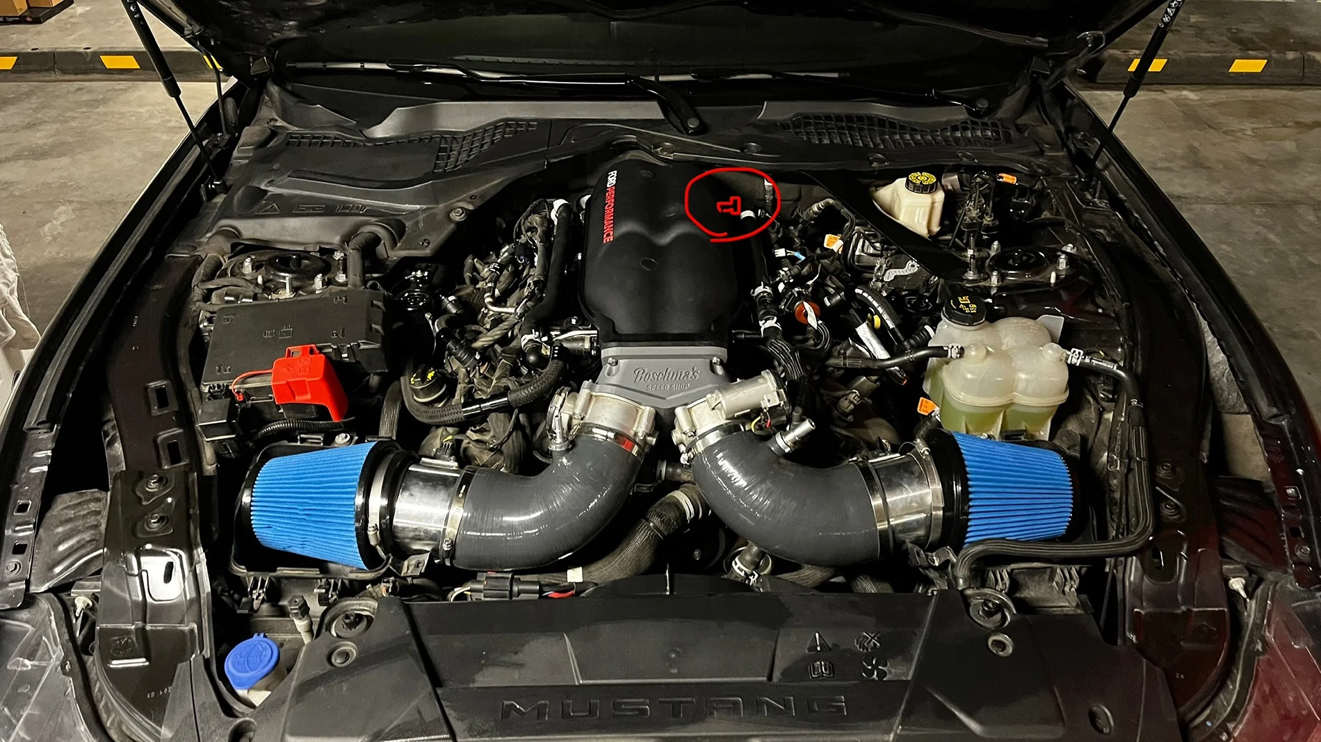

2. And with this one?
