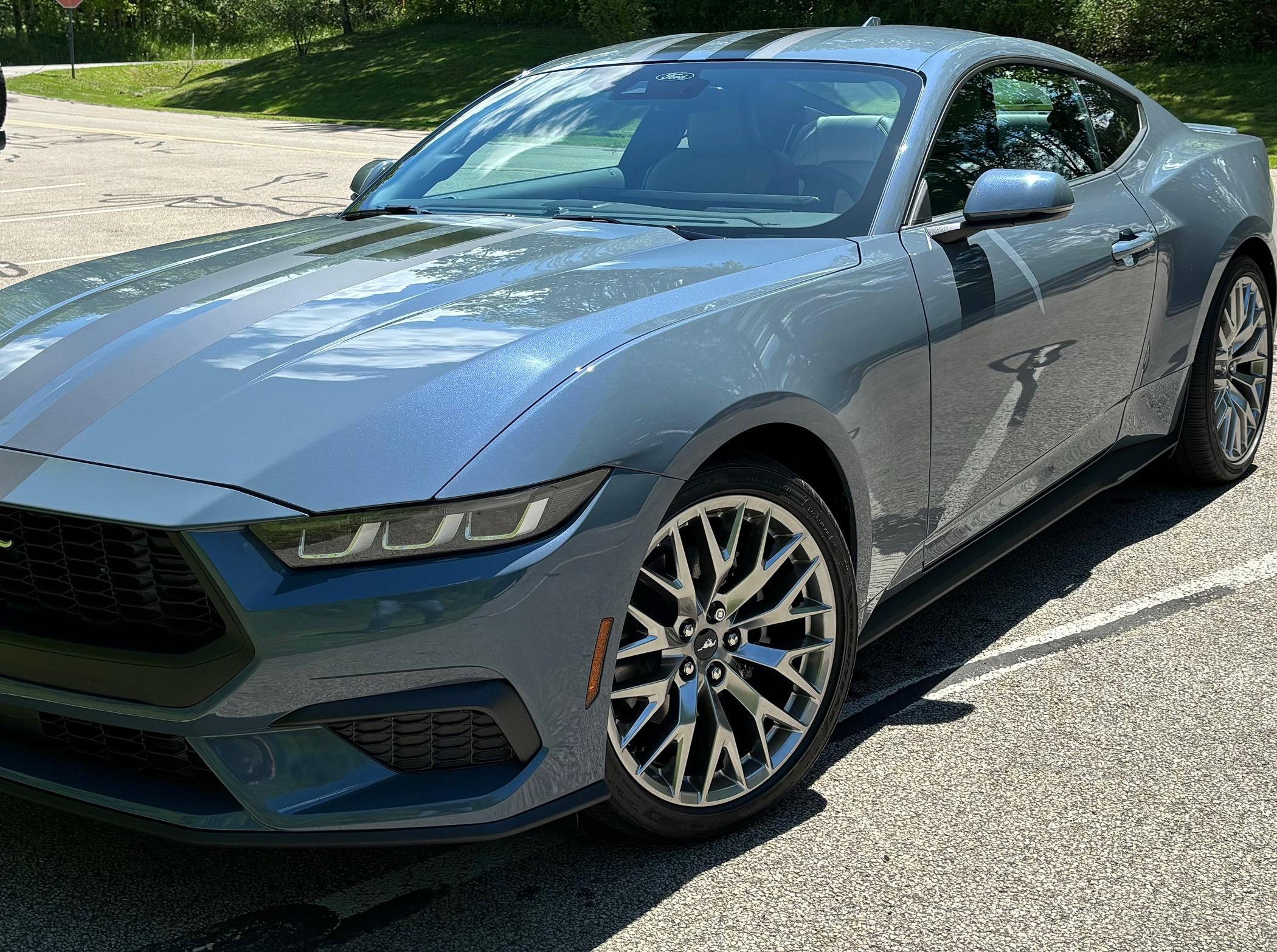

Here is a picture of the car
i can see the windshield is more cloudy than side glass but not sure if its normal
