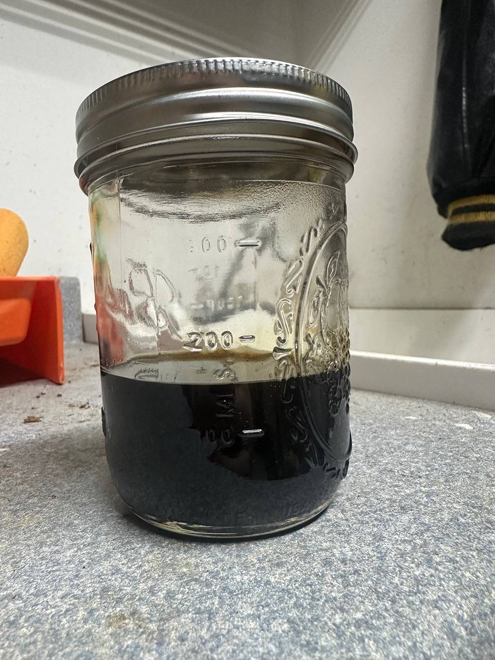

To give some additional context to how much oil my car is catching. This is an accumulation of all the oil out of my catch can at 25k it has been on my car since approx 250 miles.
That is an insane amount and I question if it's even connected properly, you really shouldn't see any more than a tablespoon or two in a couple thousand miles
Your engine would not be sucking in that much oil under normal circumstances

This is just under 11 tablespoons of oil (160ml). That’s 25,000 miles / 11 tablespoons of oil = 2,272 miles per tablespoon. Same as your description of what it should be.
The way you worded it I thought it was only 250 miles
What kind of freak saves all that?

That’s a good question. 😂 This freak I guess.
I’ve never had one on a vehicle so I thought I would put it in a jar I had around and see what it was actually catching. In the end it amazing how much oil it is capturing.
