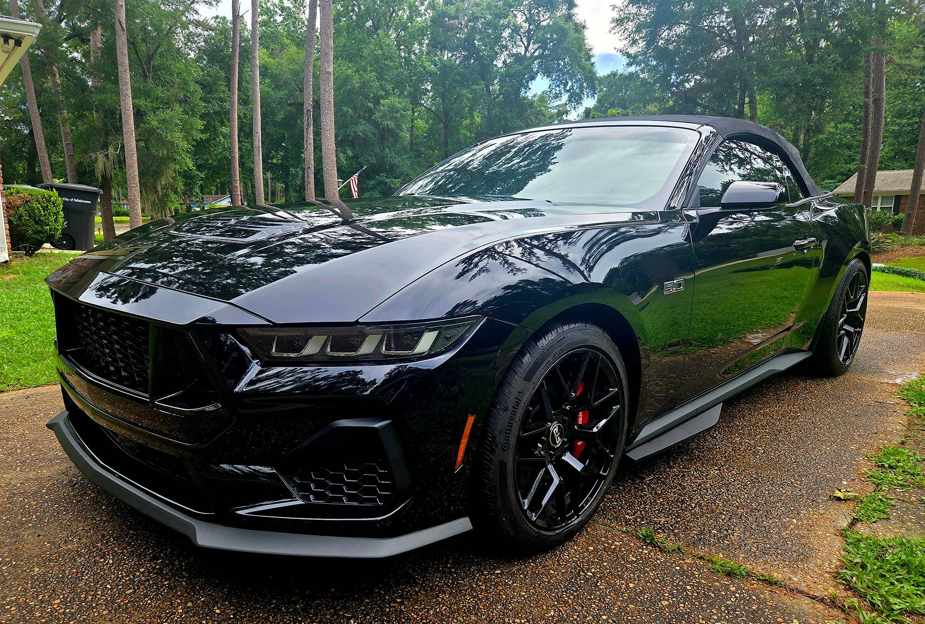

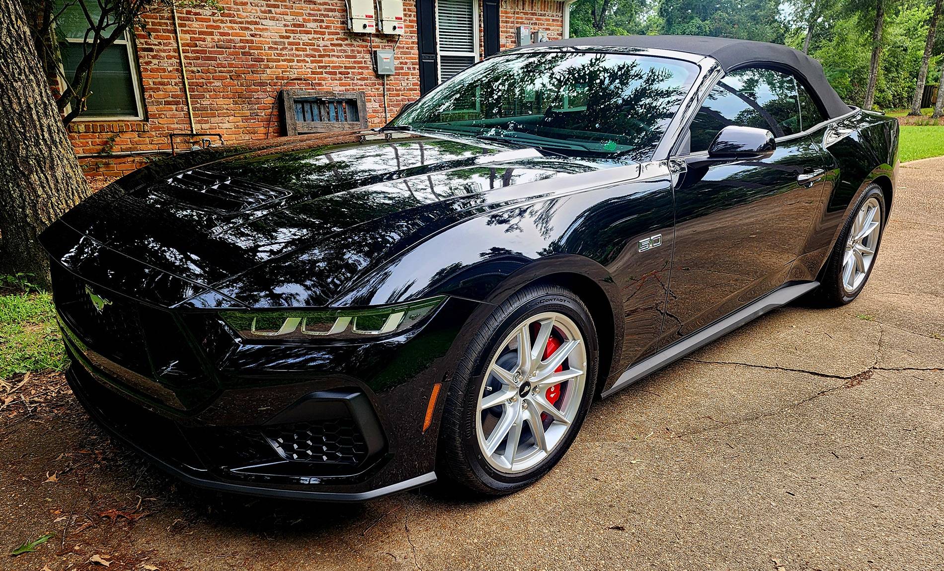

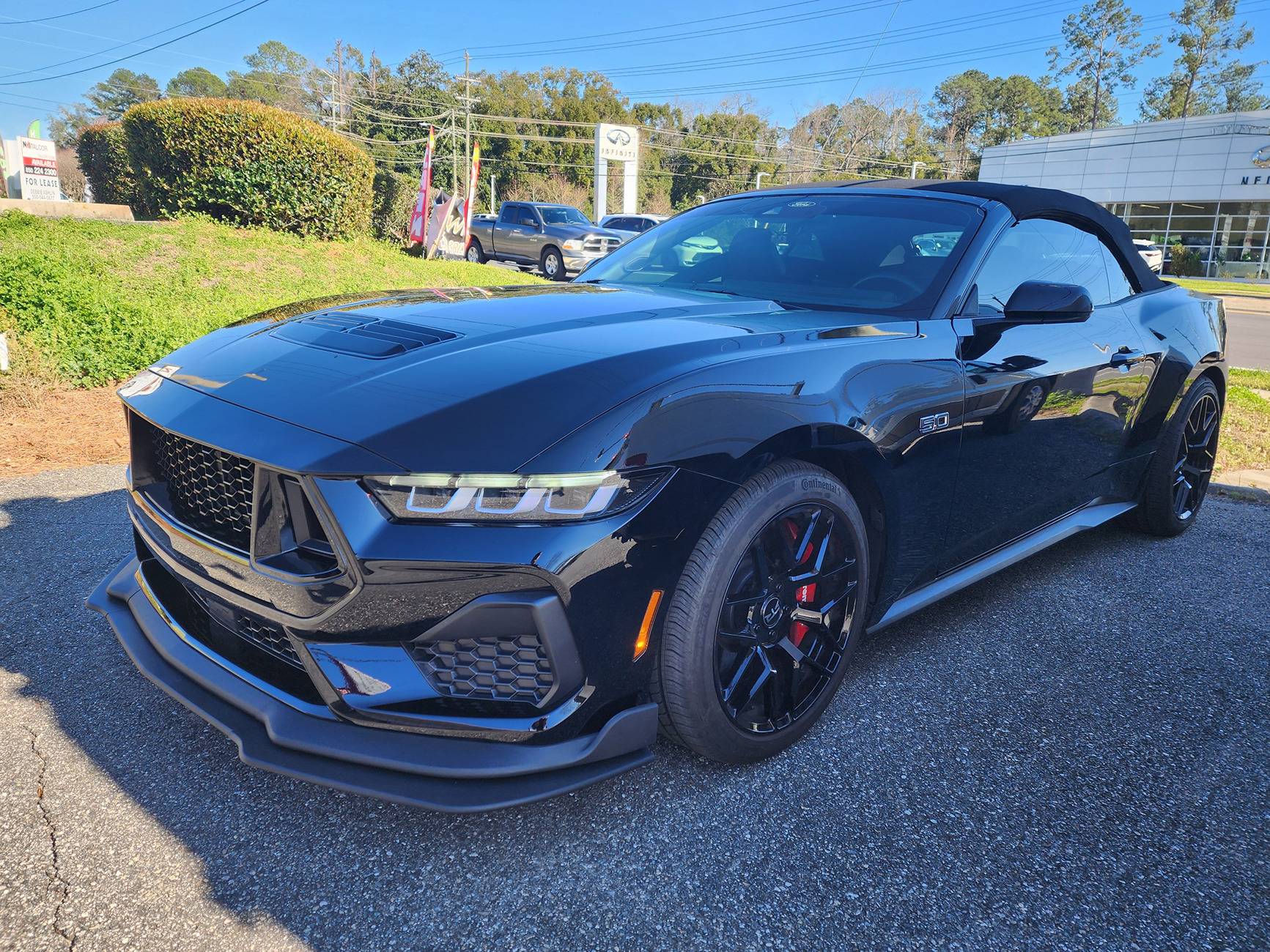

Started out with nothing since mine didn't come with the performance pack. Thought it needed one since all the best looking mustangs that I've seen (in my opinion) have them.
Ordered and installed an MP Concepts chin spoiler/splitter to have at least something there. Decided it was too aggressive looking, and used my FordPass points to order and install the Air Design version instead, which I really like.
I considered the RTR spoiler, but it sticks out too far for my liking, and the Air Design has been a perfect fit for me. I think it's the same exact one that comes with the performance pack anyway; if so, kudos to Ford for using it.
My wife likes the Air Design option best too, although I can't take her feedback without a grain of salt, because she likes how Lamborghini Murcielago looks, and dislikes how the Ferrari California T looks 🤣
Here are photos of all 3 from a similar angle for comparison purposes:
Before (stock):
S650 Mustang Chin Spoiler/Splitter Options 20240601_172724
After (MP Concepts):
S650 Mustang Chin Spoiler/Splitter Options 20250220_154310 copy
After after (Air Design):
S650 Mustang Chin Spoiler/Splitter Options 1000027838

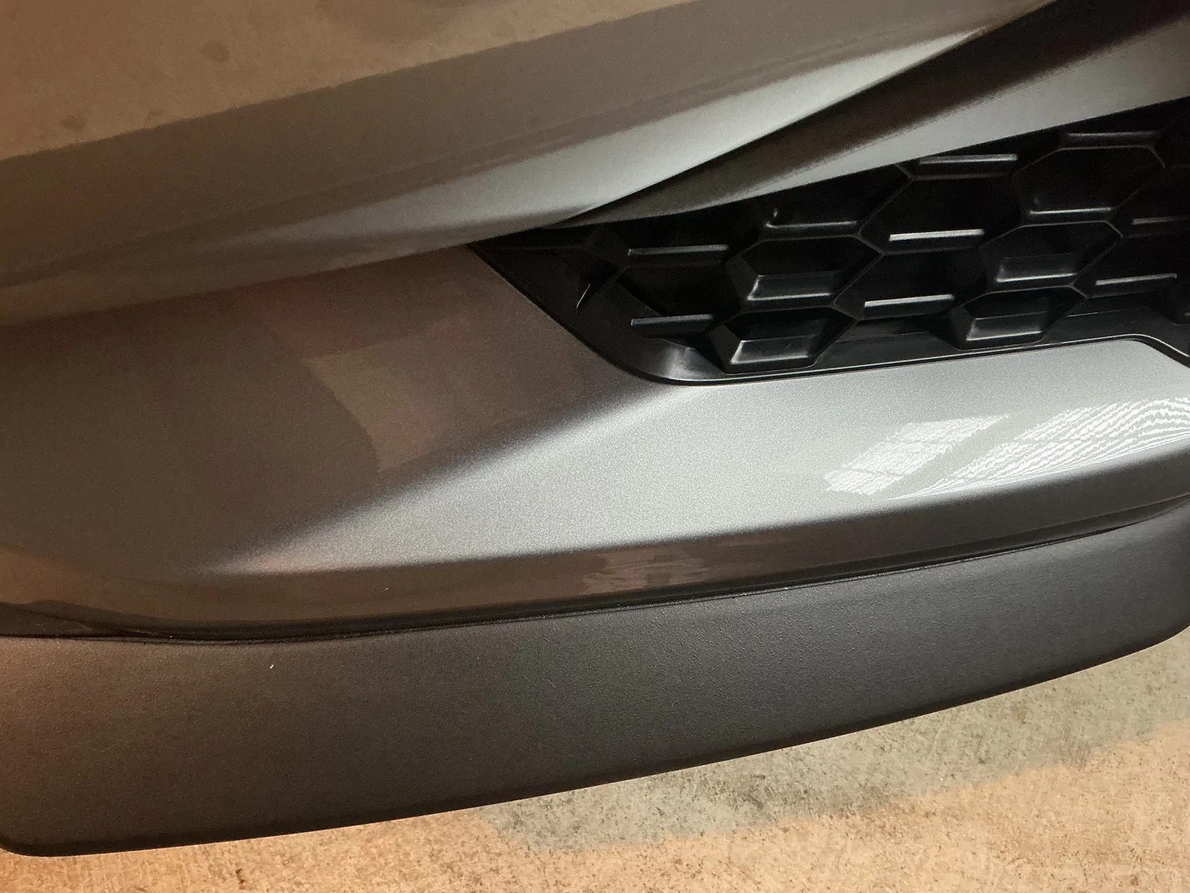

Looks good! I have the same splitter on mine. Just dissapointed it’s only held on by tape and silicone. Oh well, it’s holding.

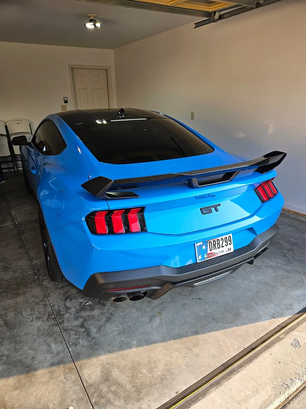

Awesome. Thank you for all the advice. Installing spoiler was a little bit of a pain in ass. Getting all the old tape off was ridiculous, actually gave me more confidence in the Air Designs splitter. Lol

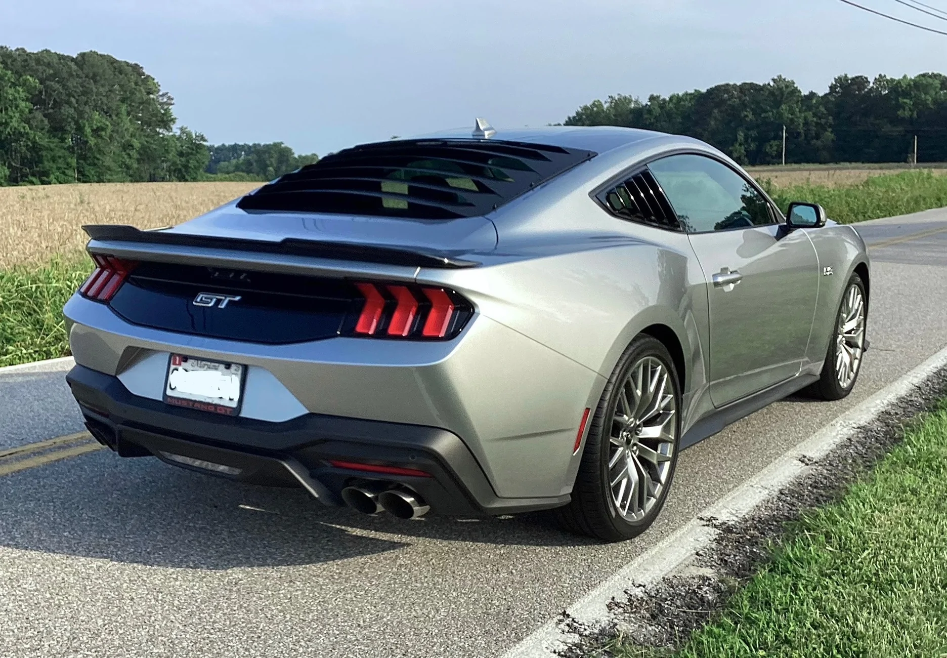

Oh man, getting the original tape off was awful. I tried floss but it kept breaking, so I tried string trimmer line, and it worked, but even though I taped off all around it I burned through my brand new car paint in 2 spots with the line. Ugh. I touched it up, and it’s OK.
The worst was lifting up on the stock spoiler and I heard a loud clunk. I later realized I had broken the 3M tape seal that held down the rear trunk module flush with the trunk. Ugh X2. I left it since I had already mounted my black out panel between the taillights…and would have to remove that to remove the trunk module to lay down fresh tape. I gave up. Good enough…

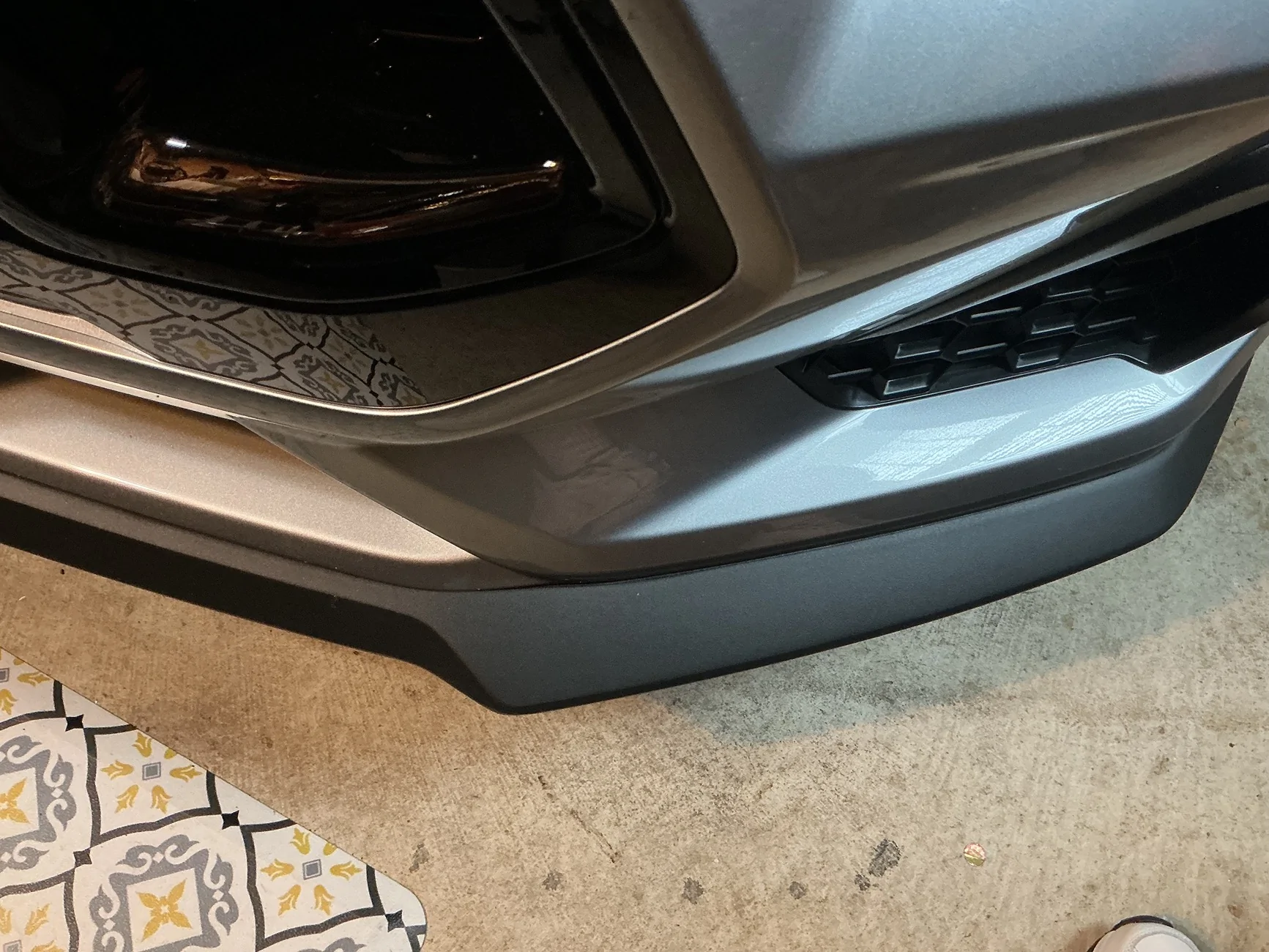

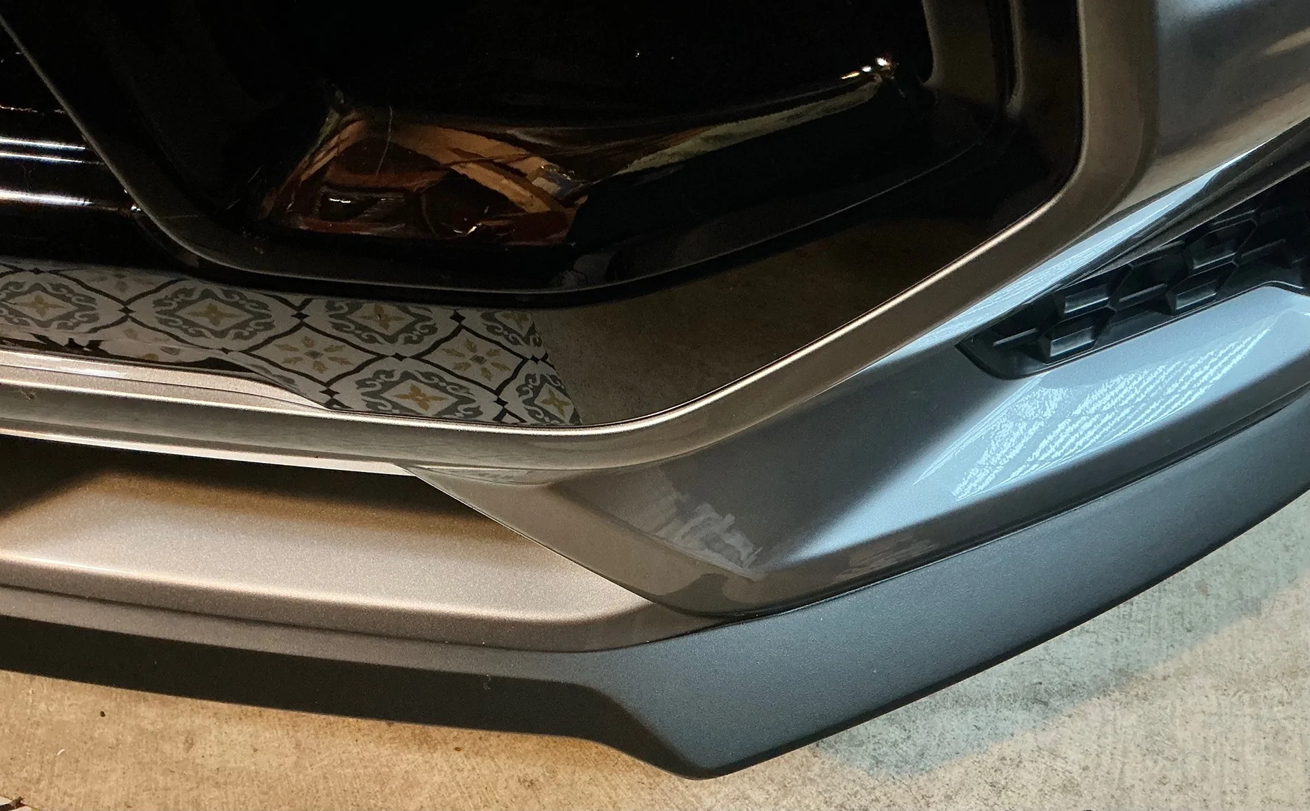

When you mount the front splitter, it should hit flush to the front bumper.
