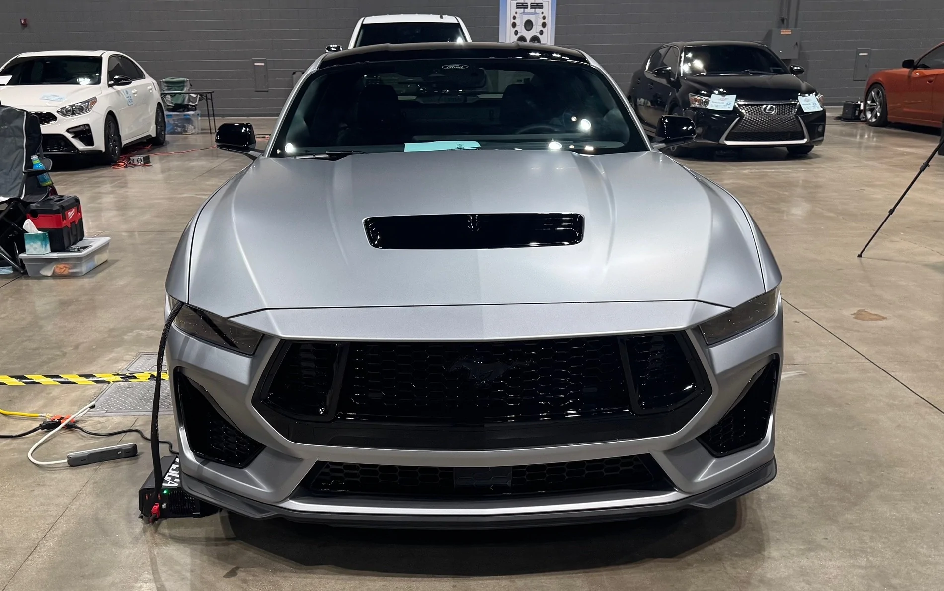

Hello Friends,
My GT came with a gloss black grill, but the lowers were matte plastic with a texture. I asked 3 autobody guys to paint them and they said they couldn't because of the texture. They said they would need to sand them down and/or skim them with body filler to make them smooth.
I just bought a new lower grill, and the two side corner grills from RTR and had them paint them.
I want the front splitter, rockers, and rear bumper to be gloss black so everything matches. Has anyone either painted theirs, had them wrapped, or know of aftermarket pieces that come already gloss black?
Thanks!
Andy

Man I have a DA but I doubt I could make them perfect. I can buy the front chin and sides from RTR and paint them but I can’t find the bumper. I prefer to buy them all gloss black and ready to install
