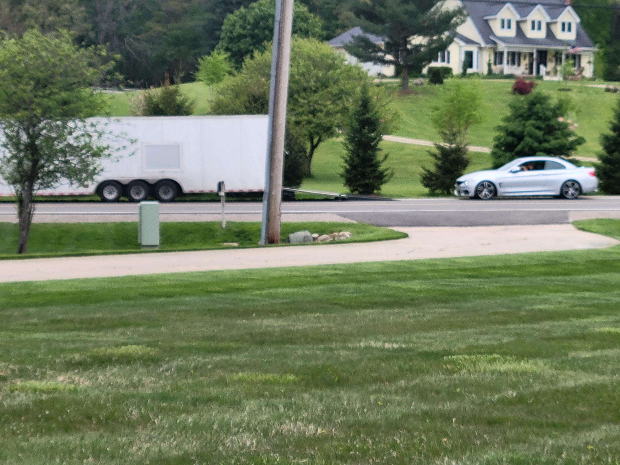

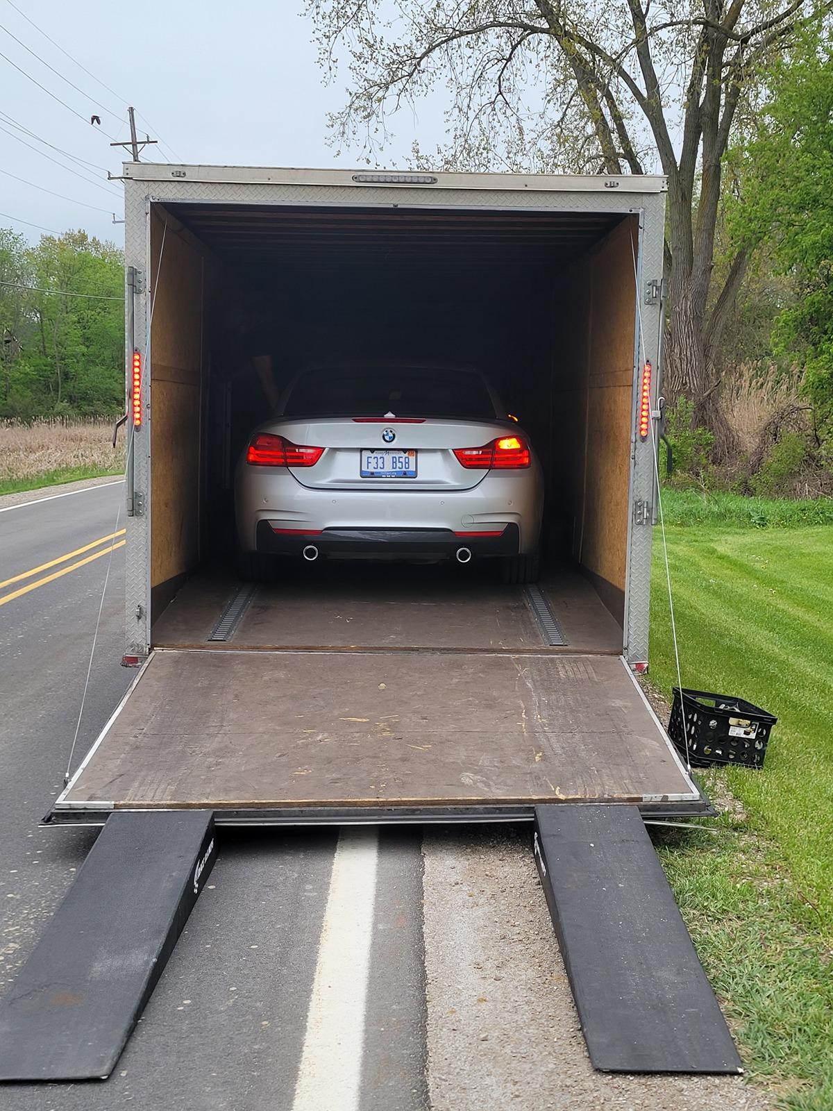

I was suggesting that having the trailer door right next to the car door is unlikely since the car door will be somewhere right about where the trailer wheel wells/tubs are. The guy that transported my BMW to it's new owner climbed out the window NASCAR style. I believe it was an 8.5 wide (maybe 8.0, but even so) trailer and you couldn't really open the driver's door since the wheel tubs make in more like 7.5 or less wide in that area.
