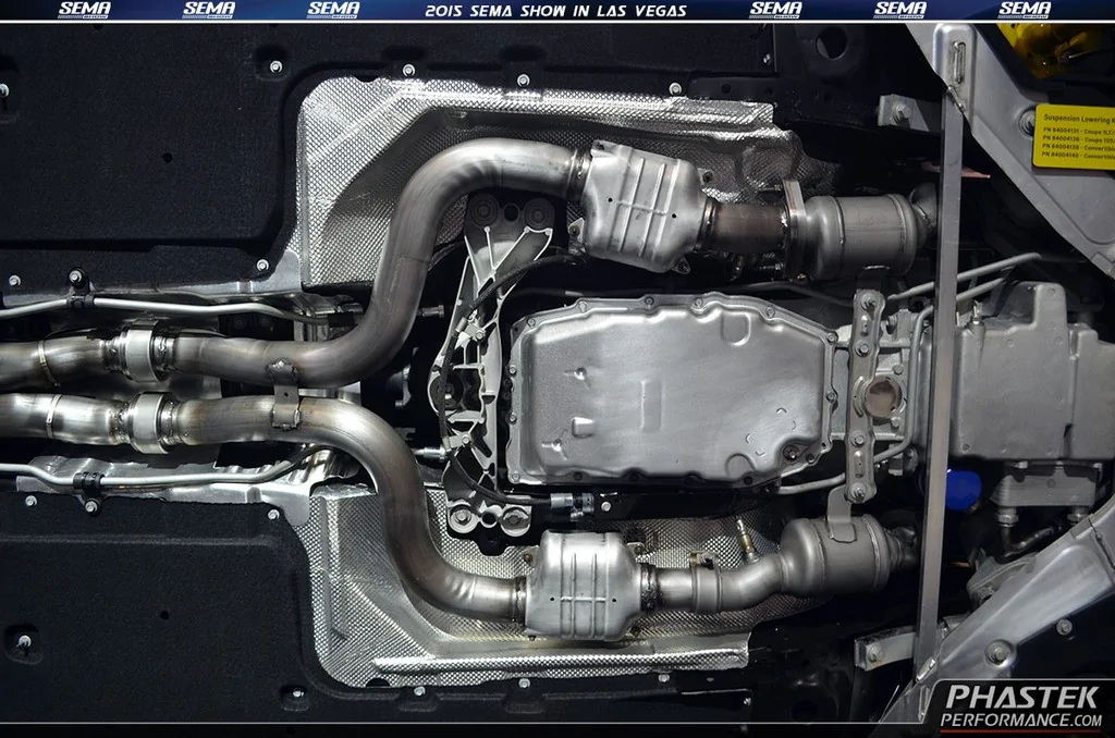

Ok, I think I have some extra data here. I checked my stainless works cats and they are made by GSport / GESI, part number HPPL-00100. According to the vendor, they're supposed to be good for 500 hp per cat. Sounds cool, right?
How much hp does your whipple Coyote make at stage 2? 700+ with headers, easily. How much is that at the crankshaft? about 825-ish? Figuring about 18% driveline loss.
Now I understand why my shop was saying don't do it. At stage 2 + headers and 1 other mod-give or take, you're easily pushing the limits of those cats.
They do have some cats rated to significantly more - 1k per cat and they cost about $1k per cat.

I took the easy way out and gutted the cats. Wow what a massive difference in power now. Not too much louder too.

The one side that is connected one piece to the header how did you gut that one? Did you cut it off then weld it back on?

Yeah, the whole manifold had to come off. Then you cut the front of it off and it’s a straight shot right into the cat. Lots of work but worth it.

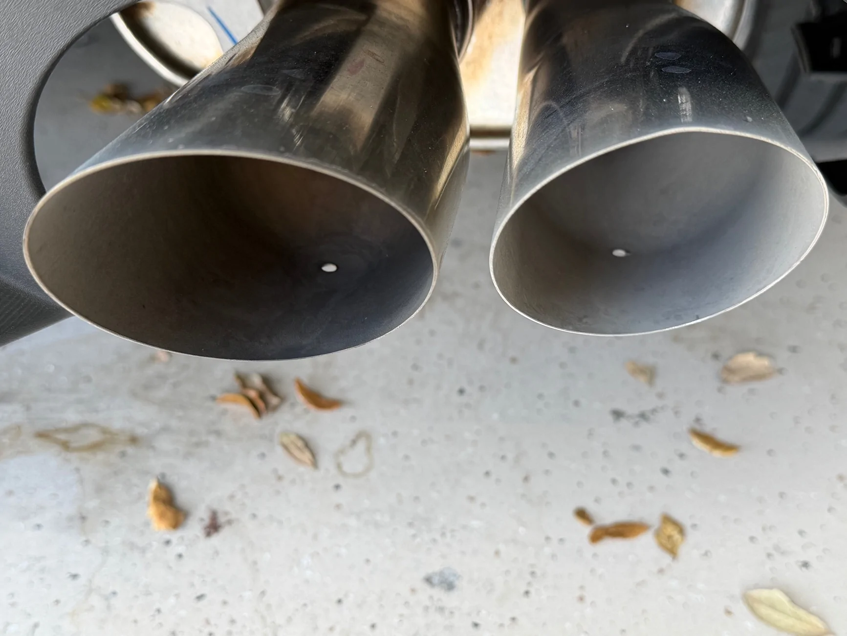

I took some db readings yesterday. Stainless Works headers, no cats, stock resonator, stock mufflers. I have her set to start on quiet mode 24x7.
Cold start: Spike to 105.5db, settles to 92-94db cold idle and idles down to ~75db.
in cab, windows up quiet mode. idle 56db, 75db at in town speeds.
take off and accelerate to about 65mph 84db. This was gently applying throttle, max 6k rpms.
76db at speed. this is smooth asphalt.
rough pavement and it increased to around 78db at speed. This section of road is just abrasive asphalt.
Sport mode: 79db at speed.
The at speed numbers are only a few db higher than stock. The real noise comes in when you're taking off or caning the car. I put it in track mode after getting fuel, and saw 95db just leaving the HEB parking lot and a moderate take off from a light was over 100db
Quiet mode definitely takes the edge off that attention grabbing noise when you stab the throttle, but it's still plenty loud.

Yep thats what mine did with my ESS car after about 800 hard miles. RIP stock cats.
Mine are hallowed out now. Car sounds good with the complete stock active exhaust. Stinks, but sounds good and isnt as loud as headers with no cats.
