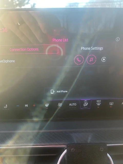

I have occasional Carplay issues where my phone shows up on the main screen but when I select it I get sent to the menue with Favorites and a bunch of other options but I never lets me select apps like Waze. So usually playing around with the posted screen fixes it.. So what are these 3 options actually for? I'm not finding it in the doc... I play around with various combinations and eventually things work. Sorry for the bad pic but I was facing into the sun..

The first two are Bluetooth phone and audio the 3rd is CarPlay I think
