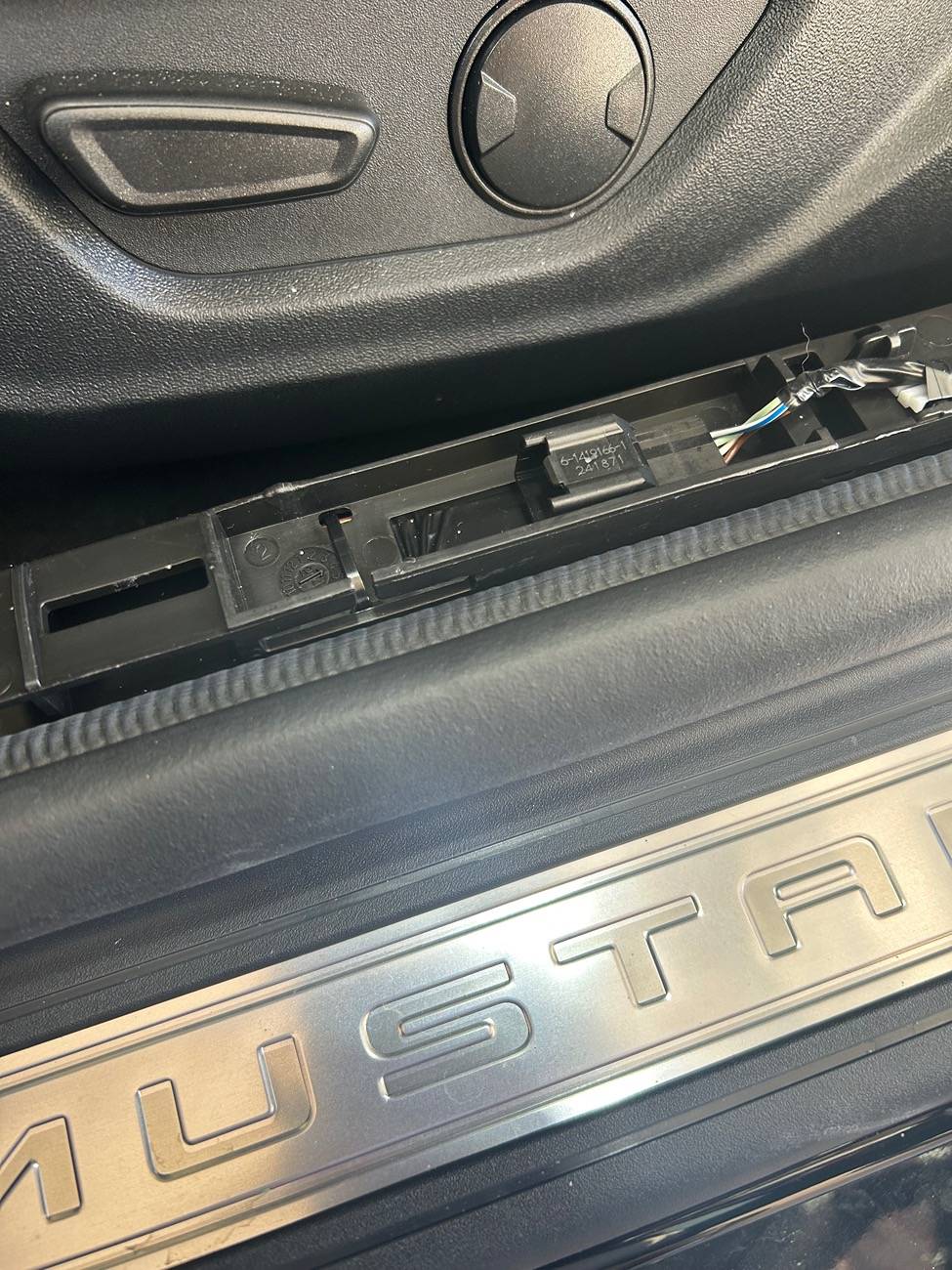

I finally ordered these and checked for the connector. There it is, waiting to be hooked up! I know I’ll probably need to use FORScan to turn it on, but at least the wiring is already in place.

Did you have to remove anything other than the trim to find that? I have a 400a package and ordered the illuminated sills as well.

just for Tracking purposes for others in the future these Door Sill will 100% fit all 2024's But my 300Package does not have the connector to plug them in..
but other then that they snap right on
Did you ever get this plugged in does it light up ? Update please
