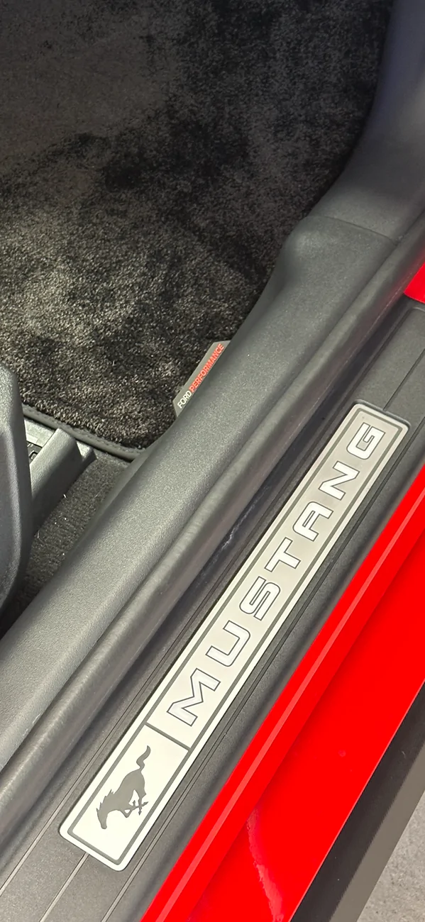

I finish wiring everything and it work! FYI S550 MyColor plate will work on the S650 as well. They are the same.
