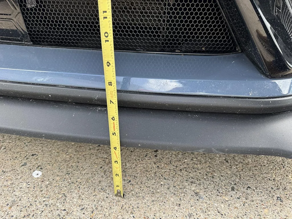

MY FRONT END (with 19" and Steeda Sport Progressives)
Guess I need to re-check mine...
Last I looked, I was right at 4" on the Sport Progressives.

My clearance with my HP splitter, 20" wheels and factory springs is just below 5 1/2". Figured to share.
