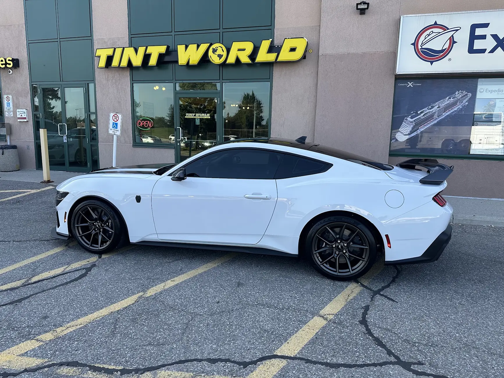

I had to do some digging but I found some pics of my car the week I got it and before any mods were done. Bone stock handling pack.
S650 Mustang Calling all suspension experts to reverse engineer a Dark Horse suspension setup 1776906247962-j3
I suspect that you have some stock HP spring sag due to the added weight of the supercharger? That may also be what is happening with my car. I wonder if the Sport Progressives were intended for use with Magneride + Forced Induction cars? I'll have to look into that.

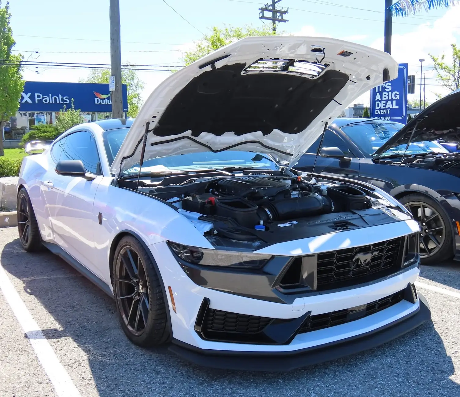

Here is a pic of my car at a car show last year with the Supercharger, Sport Progressives, 19" DHP1 wheels and 305 & 315 / 30R19 tires. The Dark Horse beside me is a bone stock Handling Pack car. It may be hard to see from the angle but I'm pretty sure he has about 0.5" of a gap in that front wheel well and his chin splitter sits maybe 0.25" to 0.5" highter? When I see him next month I'll have to bring my tape measure and see what is what on his car vs. mine.
