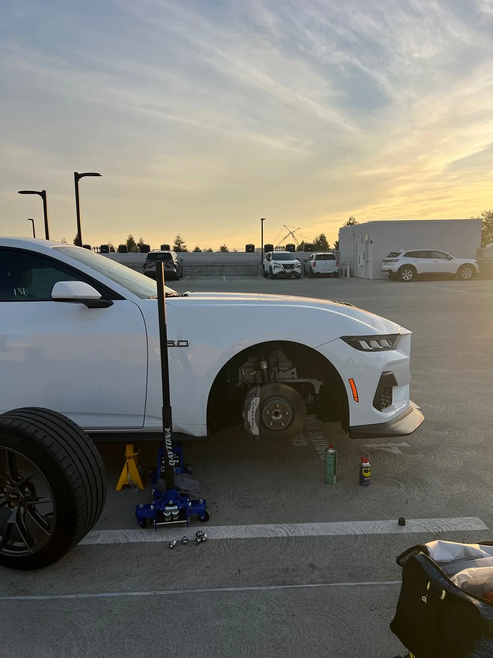

Base GT. I installed the brake air deflectors from the performance pack.
You need to thread the already existed holes with M6x1. Control arms are aluminum so threading is not hard to do.
This is what I used
Bosch BTH014#0-1/4 Inch T-Handle Tap Wrench with Adjustable Self-Equalizing Hardened Carbon Steel Jaws for Accurate Hand Threading (Includes: 1 Wrench)
Bosch BPT6M100 6mm - 1.00 High-Carbon Steel Metric Plug Tap

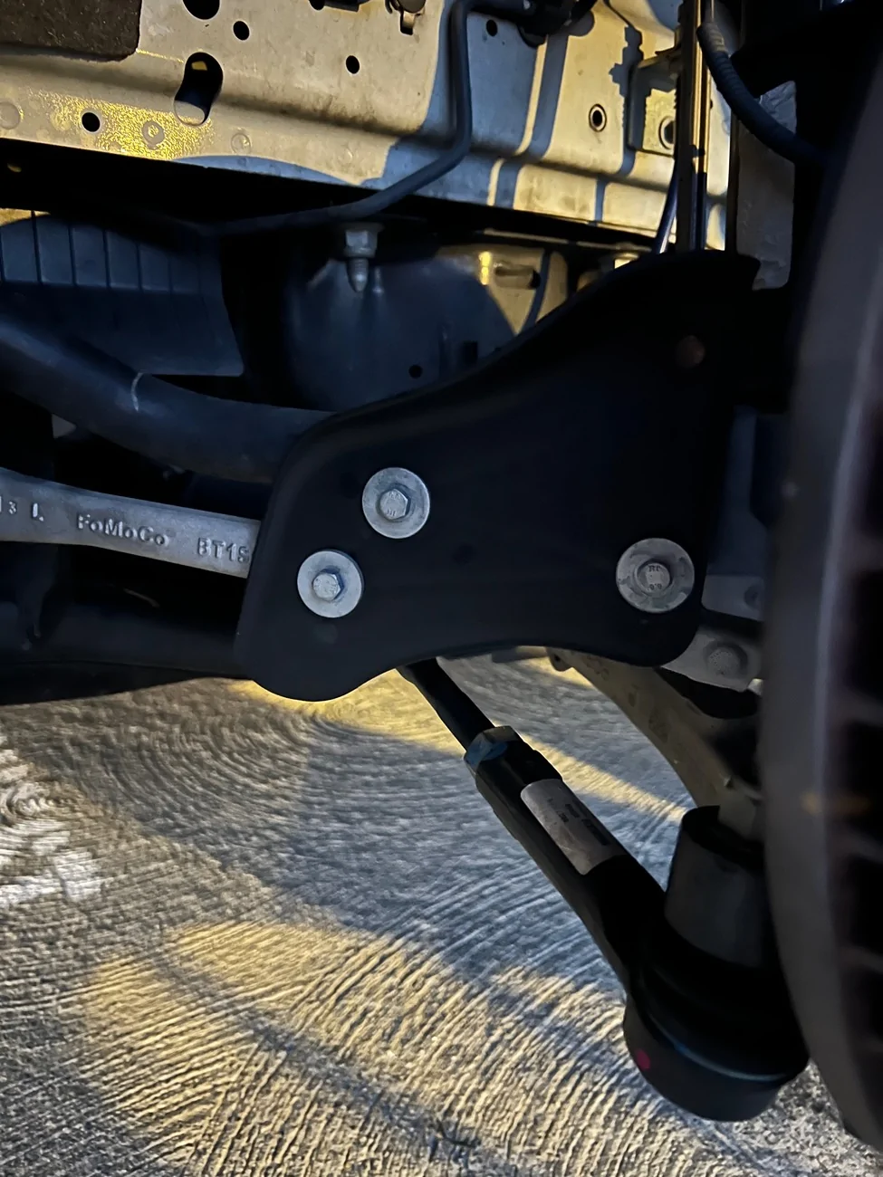

S650 Mustang Brake air deflectors IMG_7447
Wd40 and brake cleaner and removable loctite
S650 Mustang Brake air deflectors IMG_7448
