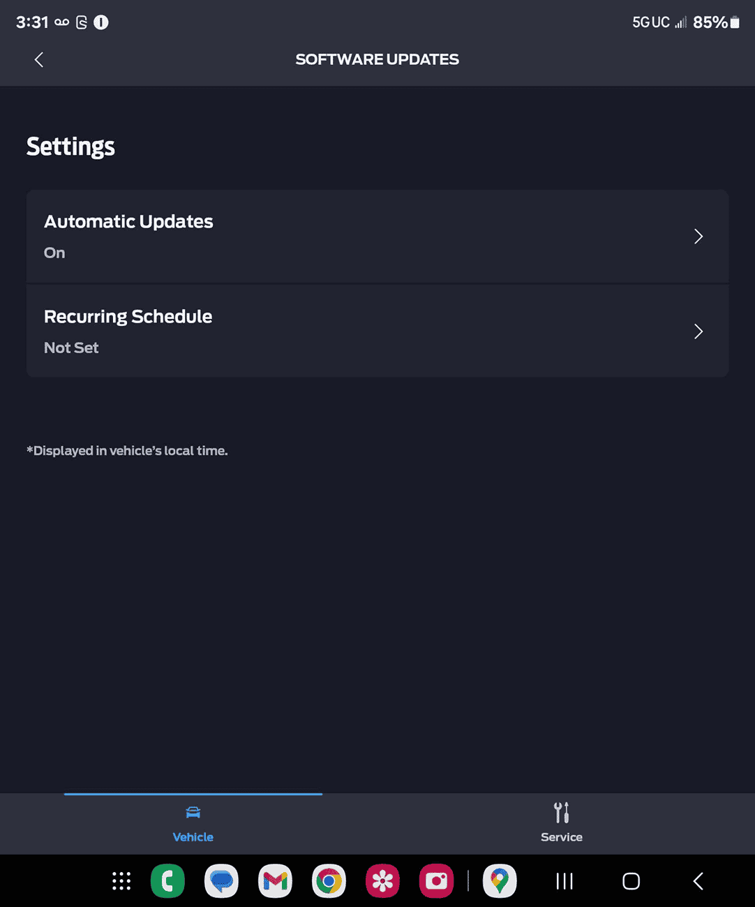

Where to see update version in the App? All I see is software update settings. Cannot find it.
Unfortunately, the app doesn't always record the updates you get and cannot be relied upon for this all the time.
