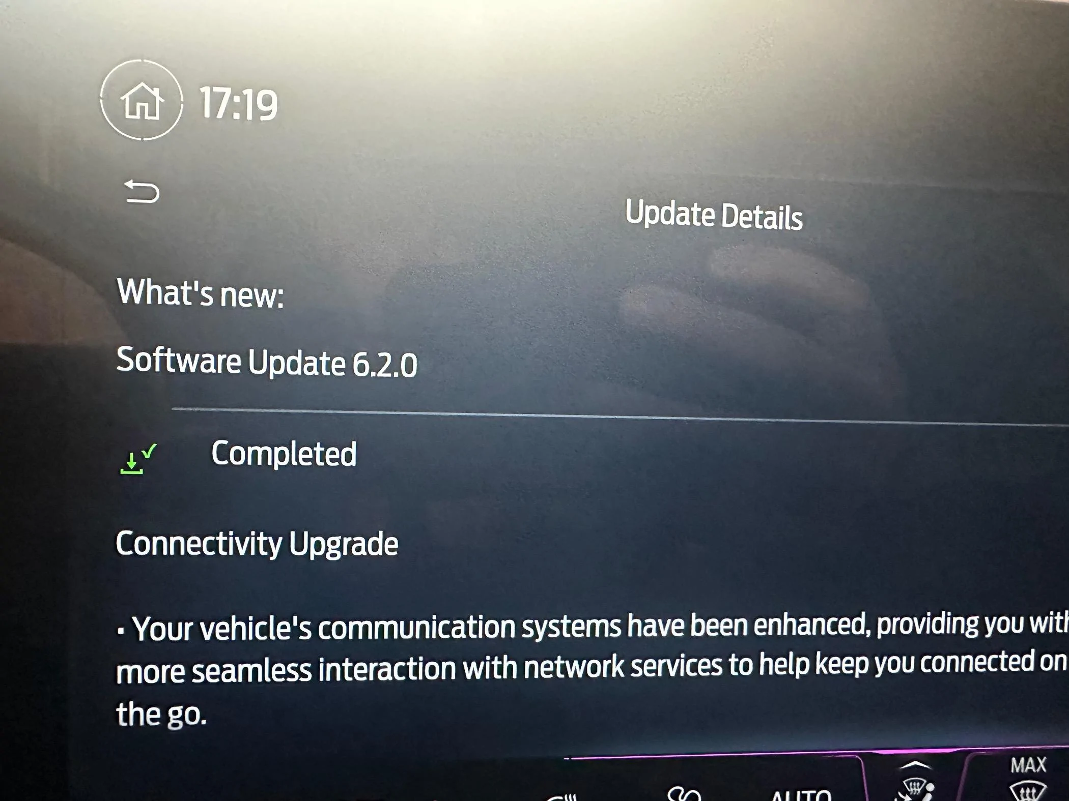

6.2.0 is what I am still on. I’ve had the car for a month and I can’t get it to update.

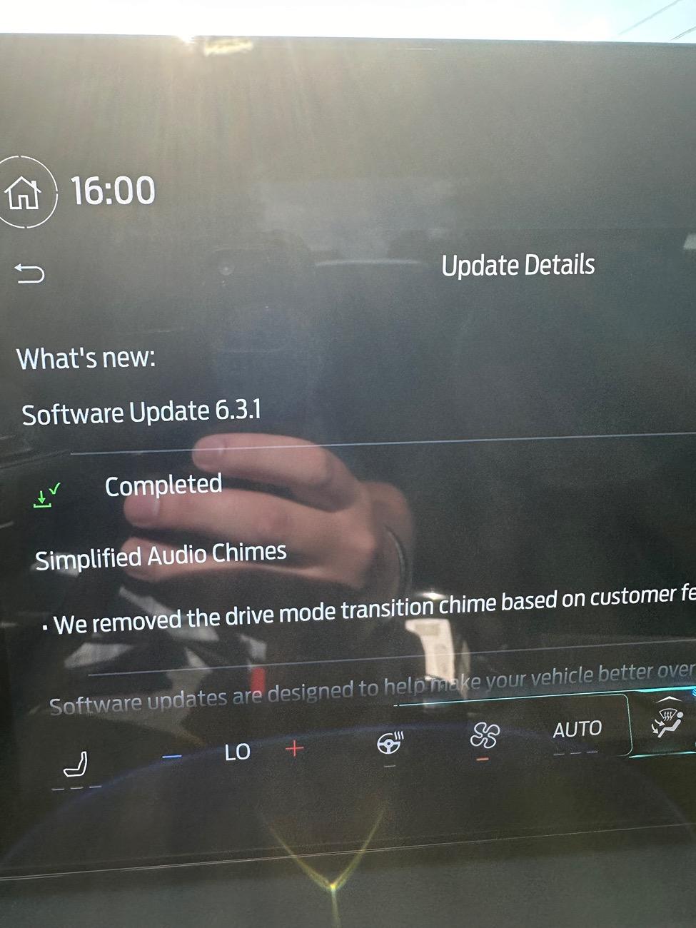

lol baby steps I guess, just got the 6.3.1 today on the way home from work. It’s sooo far behind, I don’t get it.

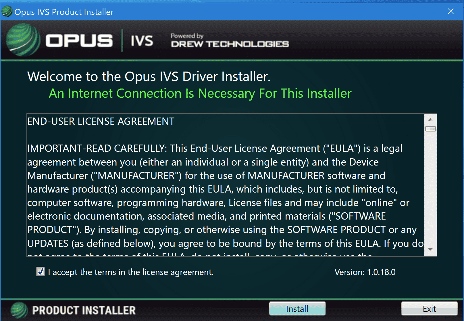

Installation and Setting up Mongoose-Plus J2534 VCI interface:
NOTE: Follow the steps below ONLY if you own the Mongoose-Plus J2534 interface

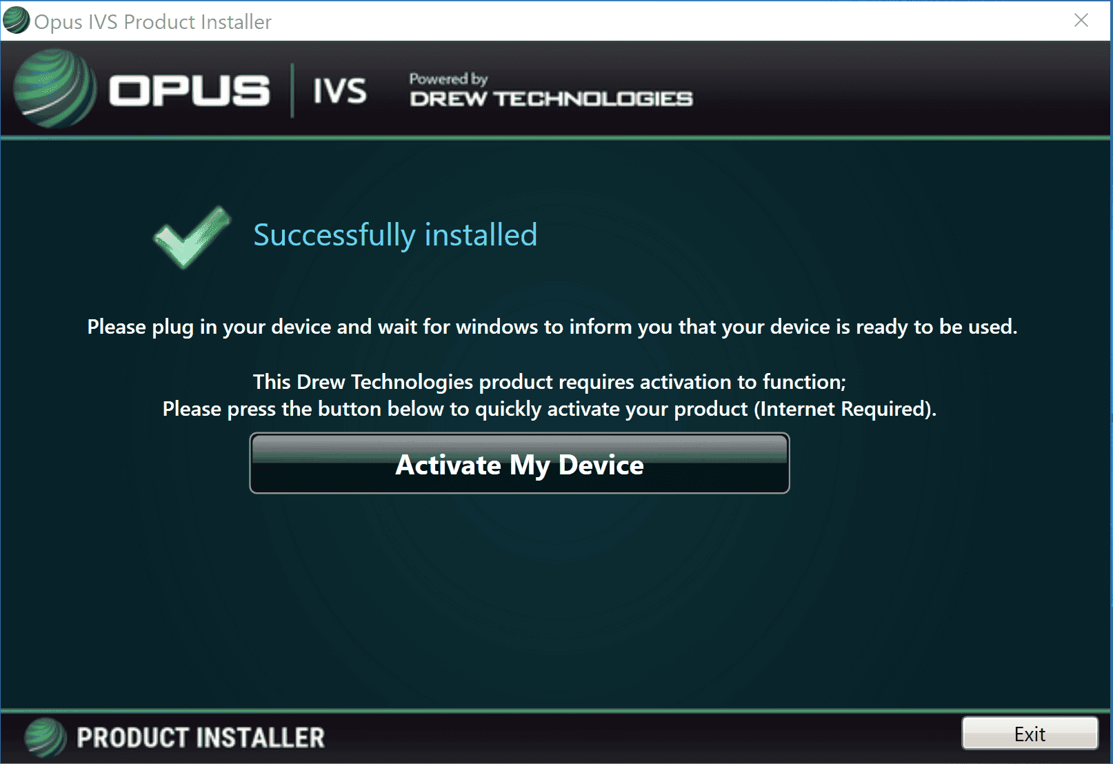

1) Download the OPUS IVS driver for your Mongoose-Plus device from here.
2) Connect your Mongoose-Plus device to your PC and launch the installer. You should be presented by the following screen:
S650 Mustang Another Software update is here. 6.4.0 1647049166155-
3) Hit Install to start the installation process, when prompted, activate the device!

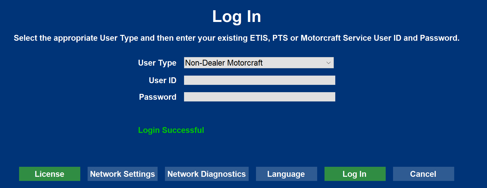

1) Download and install FDRS software from here. You will need a license to run this software and can be purchased here (2-day FDRS license cost $50)
2) Launch FDRS, you will be prompted to enter the license that you have just purchased.
3) Register an account (if you don't have one) on Motorcraft website here.
4) Log into FDRS using your Motorcraft credentials. Make sure you select Non-Dealer Motorcraft as User Type

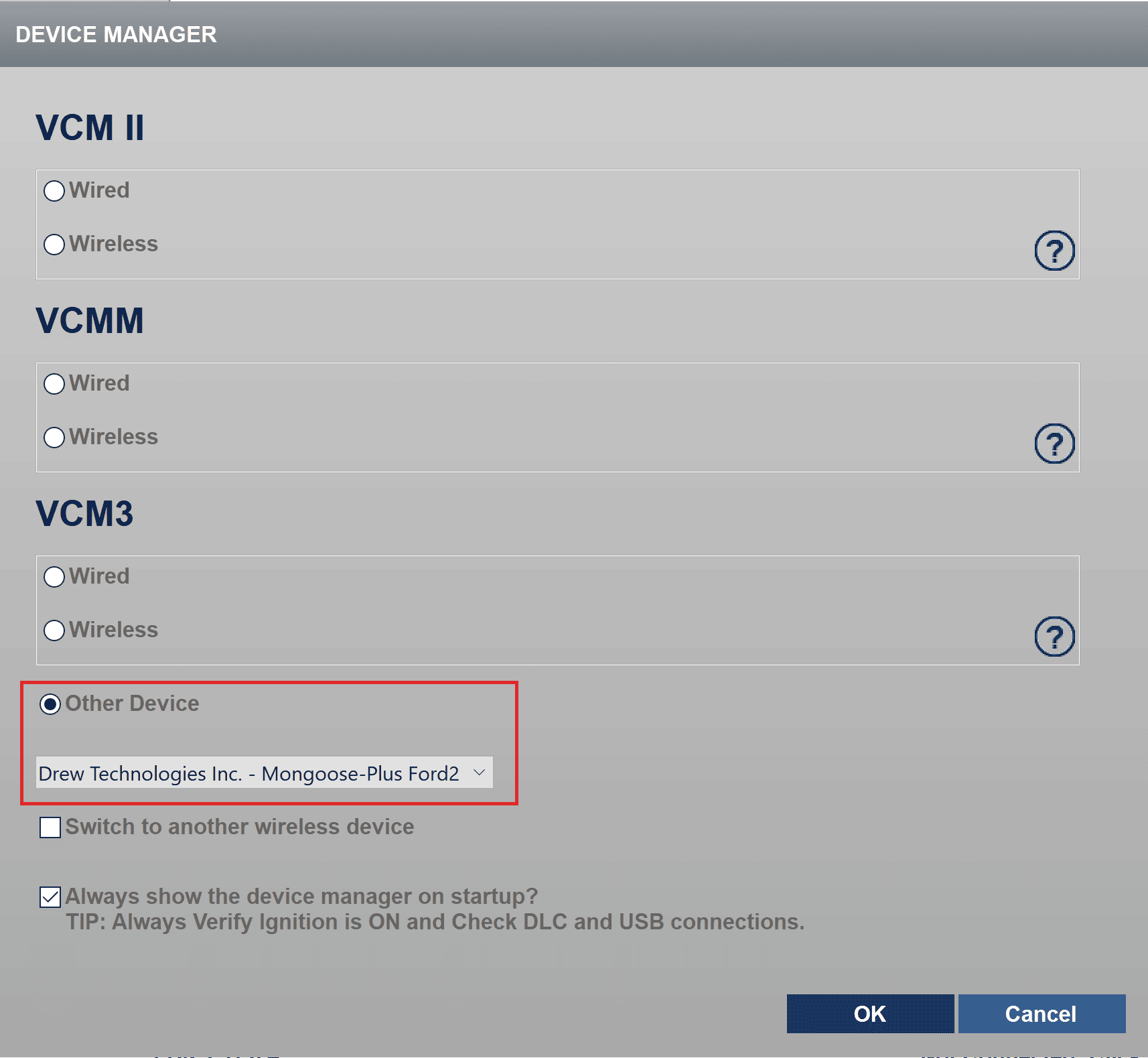

5) Connect your VCI device to your truck's ODBII port and connect the USB cable to the PC running FDRS. Once FDRS Device Manager pops up, make sure you select Other Device, in the drop-down dialog:
Select Drew Technologies Inc. - Mongoose-Plus Ford2 if you own the Mongoose-Plus VCI device

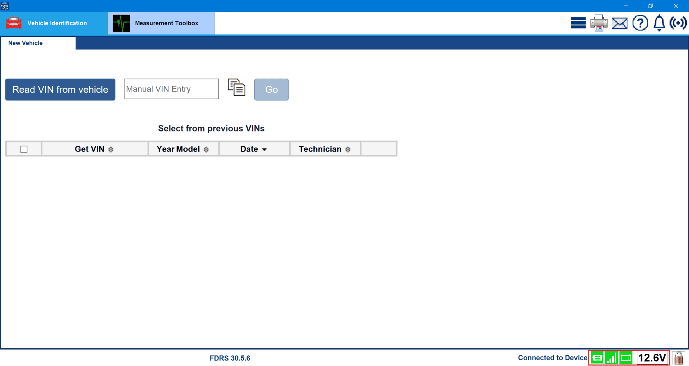

After this you should be greeted with this screen, meaning you are ready to go!
The icons at the bottom should be all green with battery voltage shown
S650 Mustang Another Software update is here. 6.4.0 vinread-

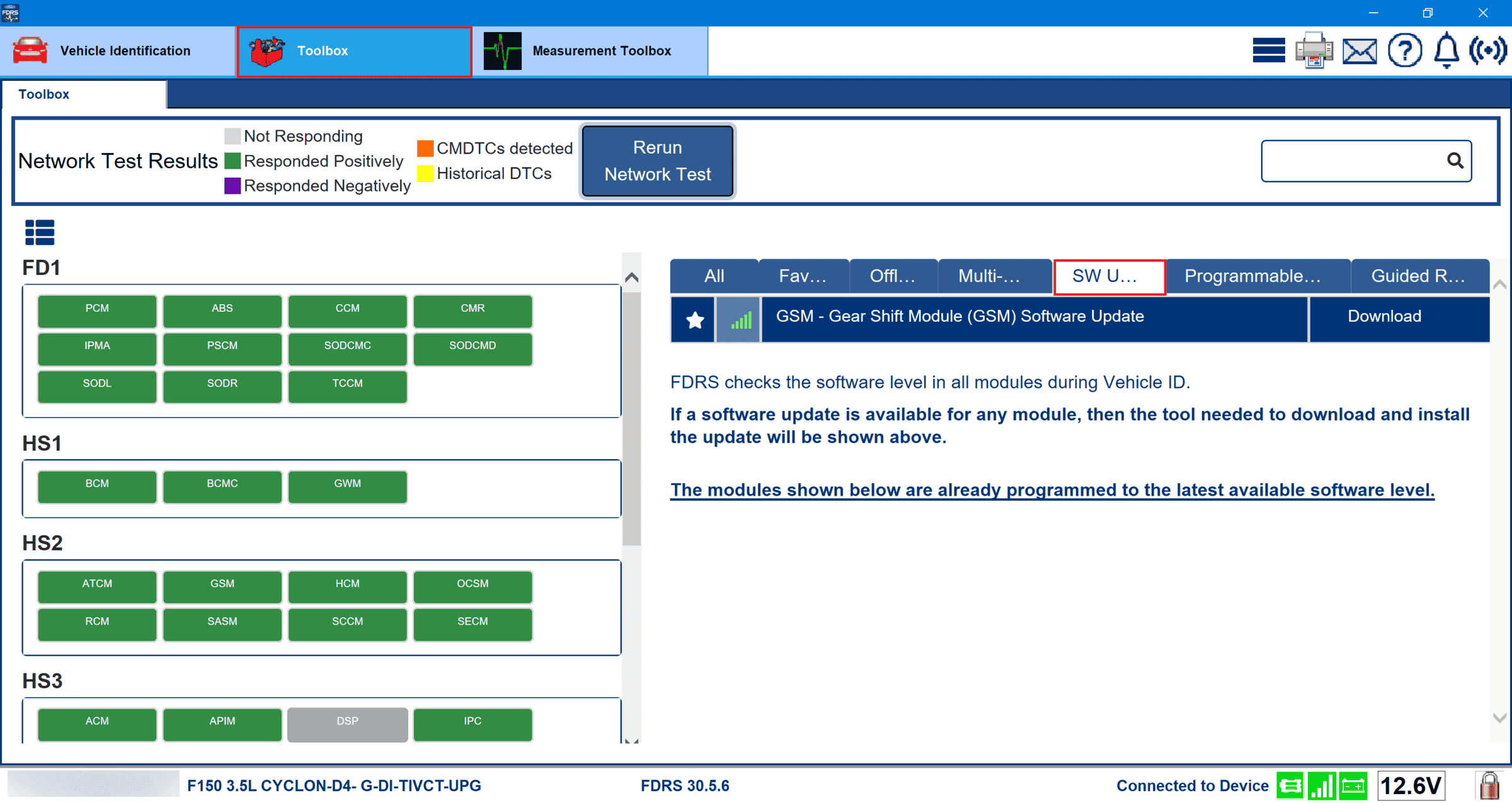

Running Network Test (Initial Scan)
1) Turn Ignition On, Engine Off
2) Click Read VIN from vehicle
3) Click Go to initiate Network Scan
Once completed a new tab called Toolbox will appear at the top of your FDRS screen:
S650 Mustang Another Software update is here. 6.4.0 swupdate-
On the left hand side you will see all modules detected on your truck. The ones that responded positively will be marked green. On the right hand side notice the SW Updates tab. Head over here to see all available SW updates for your modules.
Module SW Update Procedure
1) Head over to SW Updates tab in the FDRS Toolbox window.
2) If there are updates available, hit the Download button. The tool will download the necessary tools needed for the module update.
3) Once download completes the button turns green with a text "Run".
IMPORTANT: Before you proceed to the next step, connect your truck to external power supply (a good battery charger/maintainer as one listed above will do the job). DO NOT connect the negative (black) charger clamp directly to the battery monitoring sensor, it must be connected to an engine or chassis ground in order to bypass the BMS circuitry (see example here). Do not proceed unless you have solid 12.5V or more showing on your ODBII port.
4) Run the SW Update procedure and follow the on-screen prompts very carefully
Be patient, some modules take long time to update. This is especially true for IPMA module which takes almost 3 hours to complete. Therefore, it is very important to have your truck connected to external power supply (battery charger/maintainer)
NOTICE FOR FORSCAN USERS: FDRS will knock out your recent FORScan changes from your modules you are updating. It reloads your As-Built (AB) data at the end of the SW update procedure. Make sure you back-up your FORScan changes and load them back after you are done with SW updates. By time your FORScan changes get propagated to your AB data set on FORD servers, so this would not be an issue. This would only affect users performing FORScan changes and running module SW udate within short period of time. I am suspecting, that receiving OTA shortly after FORScan changes would have same effect.
