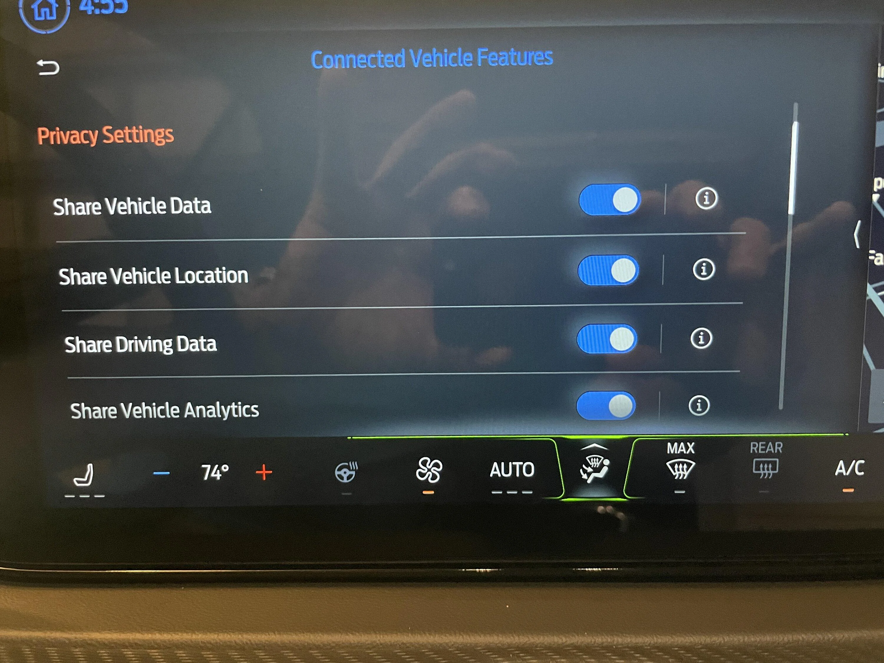

This is the main screen that lets you turn options on or off
S650 Mustang Software Update Mechanism? IMG_4845

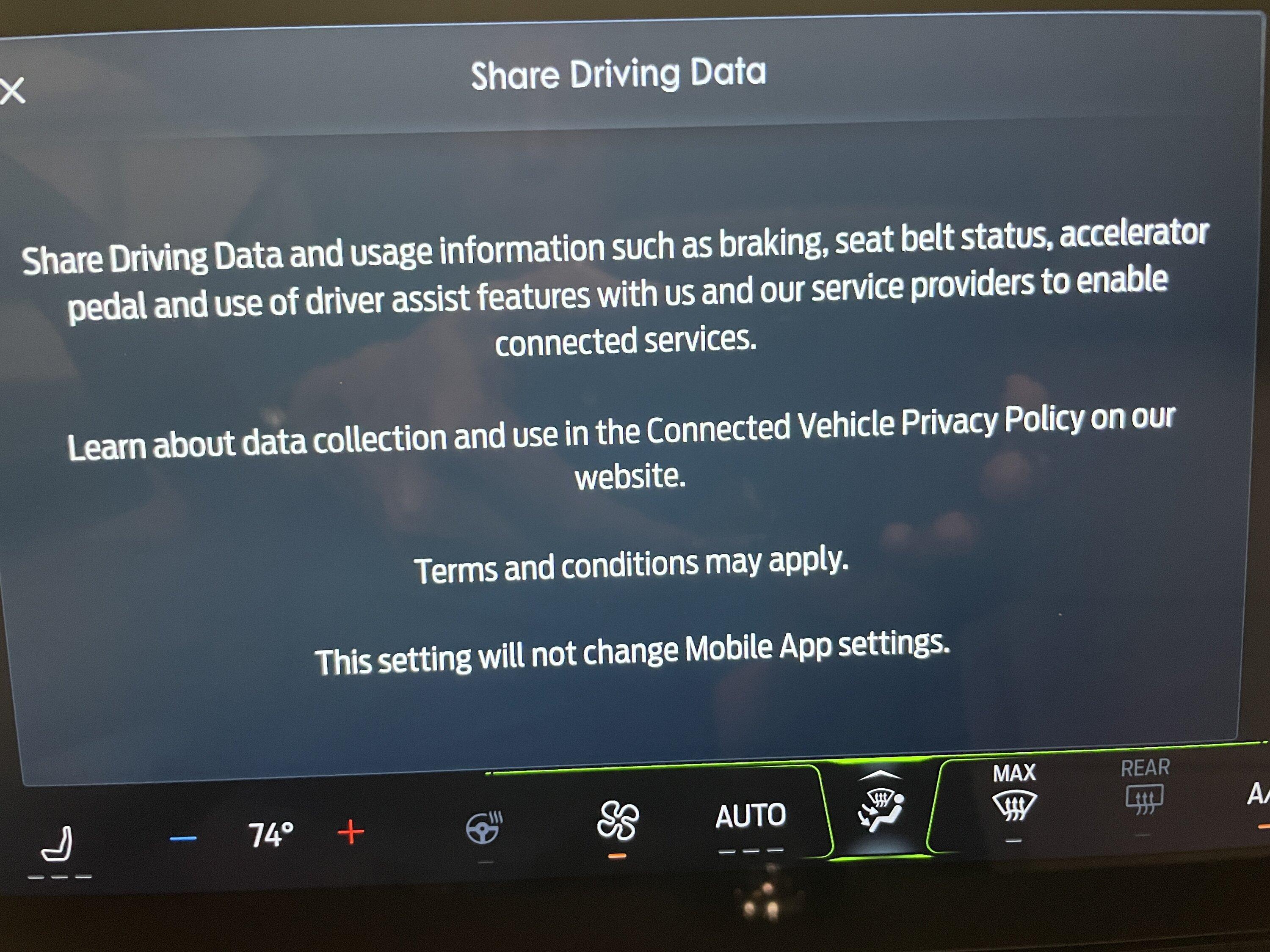

When I went to shut off Share Driving Data I got this message;

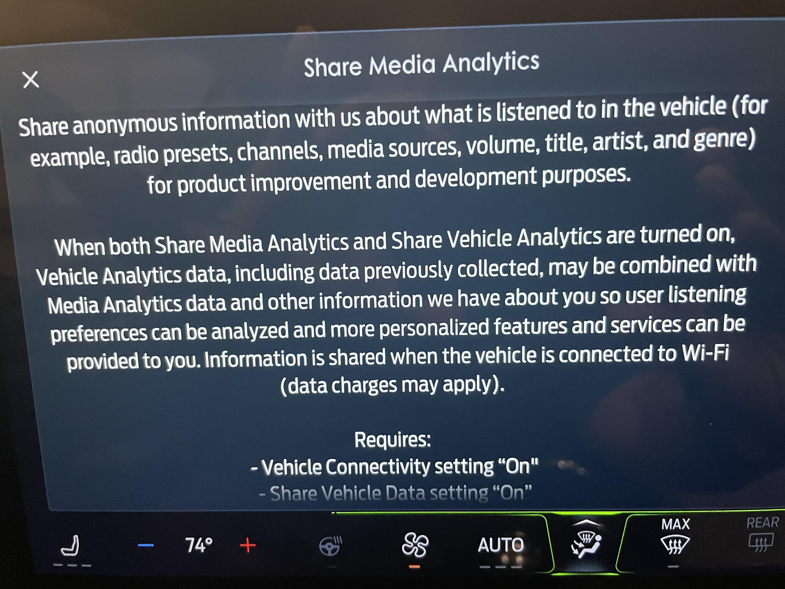

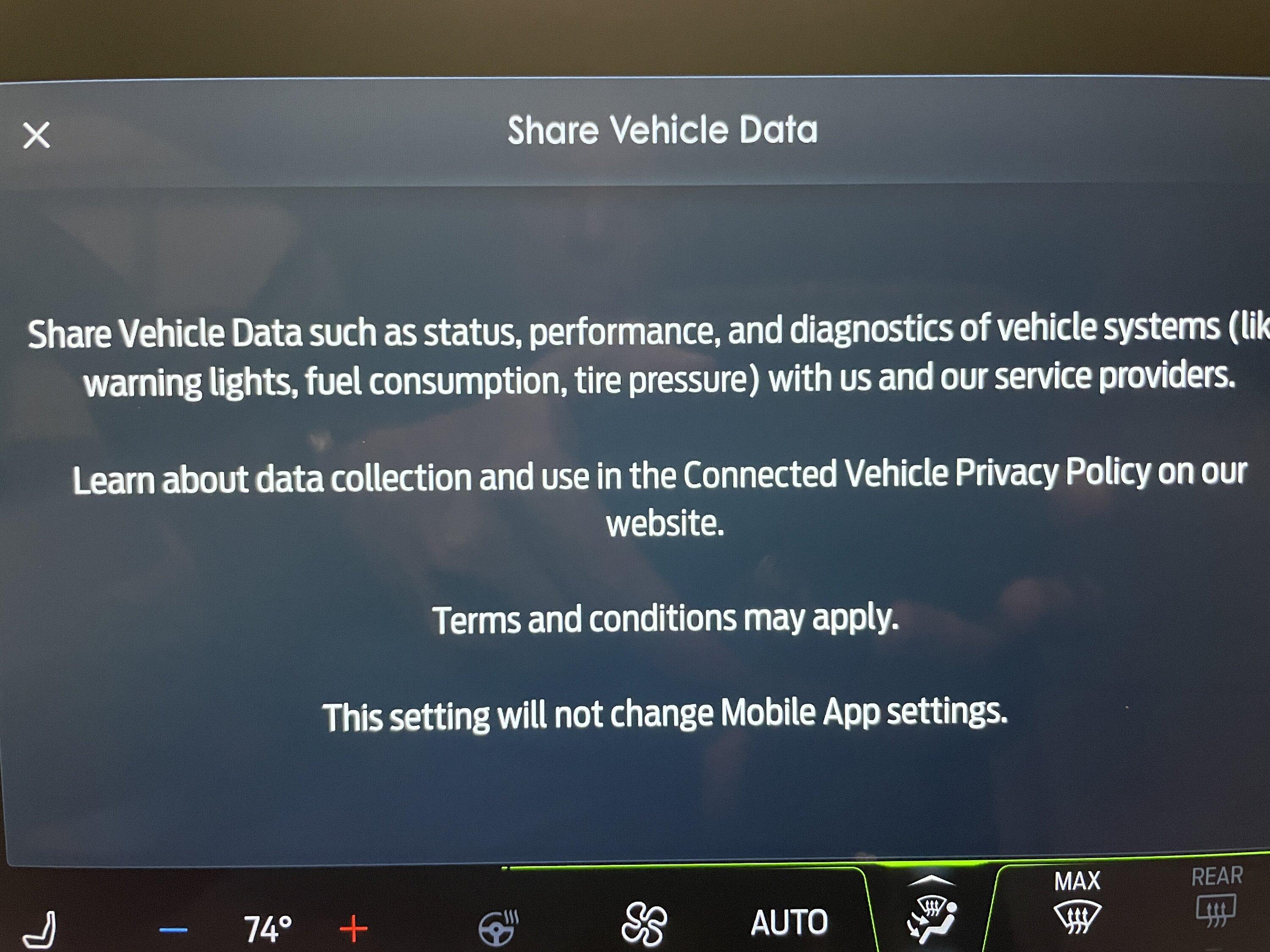

Do I really want Ford or anyone to know how hard I was braking or accelerating? None of their business in my opinion or this;
Maybe I'm just old and think that all the information that is collect about us and sold is wrong and I don't plan on participating in it unless Ford wants to cut me in on the deal!
