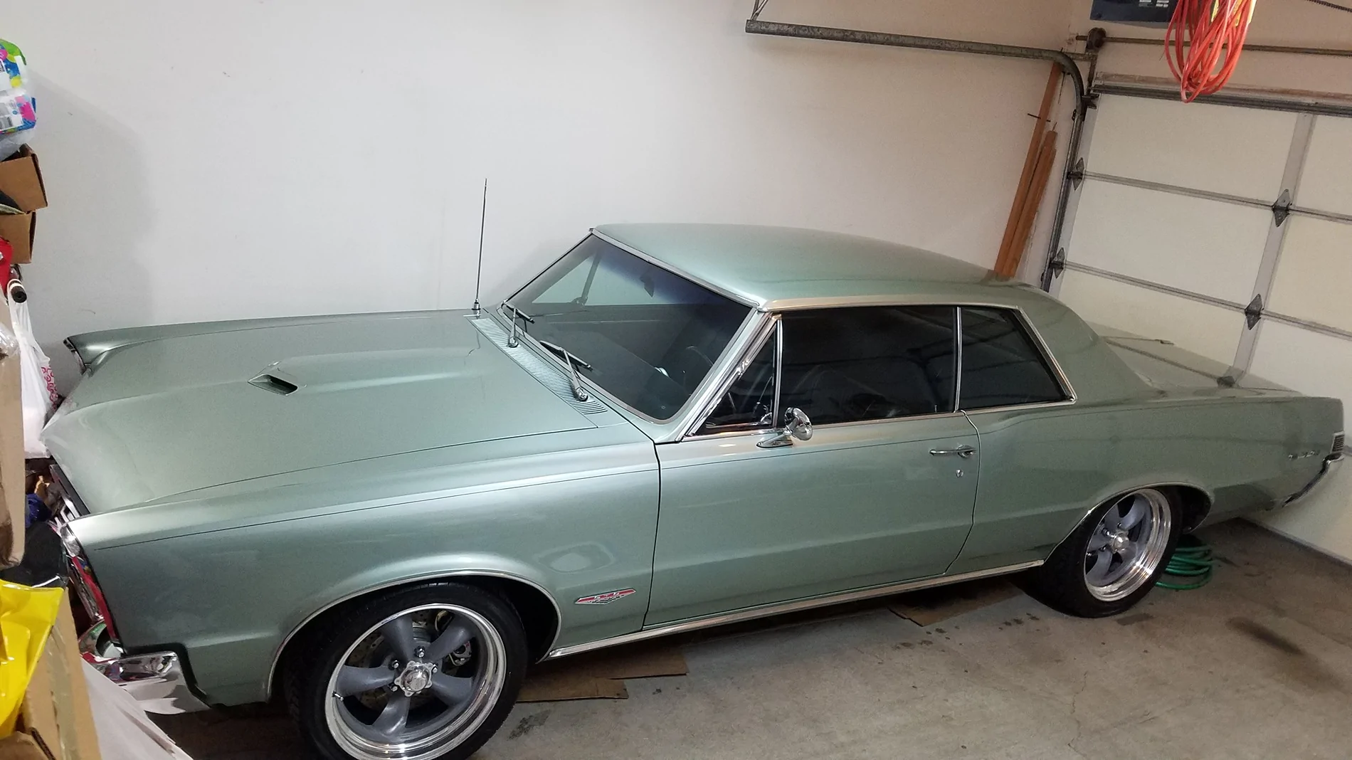

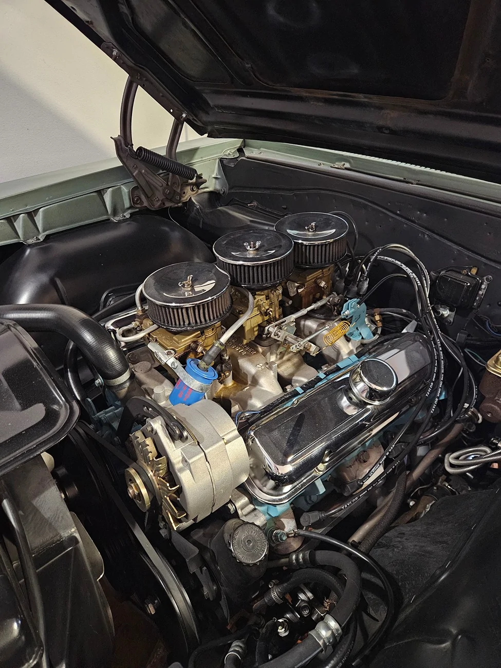

That is some timeless beauty right there.
Much appreciated...Bonus pic of the legendary Pontiac "tripower" set up (3x2 bbls or "three deuces" as my Dad says they called them back in the day).
