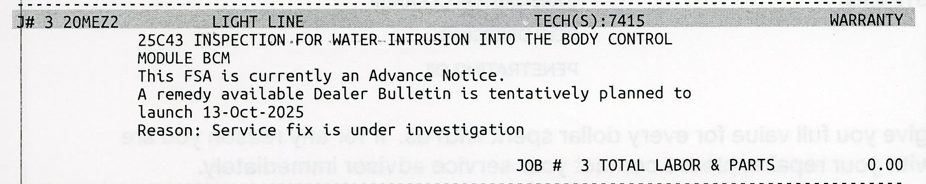

I checked my records, and I only drove 3800 miles in the last 12 months.
Service report: Battery tested good. (Not sure if in checking diagnostic codes any thorough check was made for excessive draw.) Report states u3003 in multiple modules, which would relate to the low battery charge status.
By the way, also inspected and cleared for water intrusion in the body control module (recommended fix expected in October).
Can you speak more on this? Last I heard it was Q1 of 2026.
