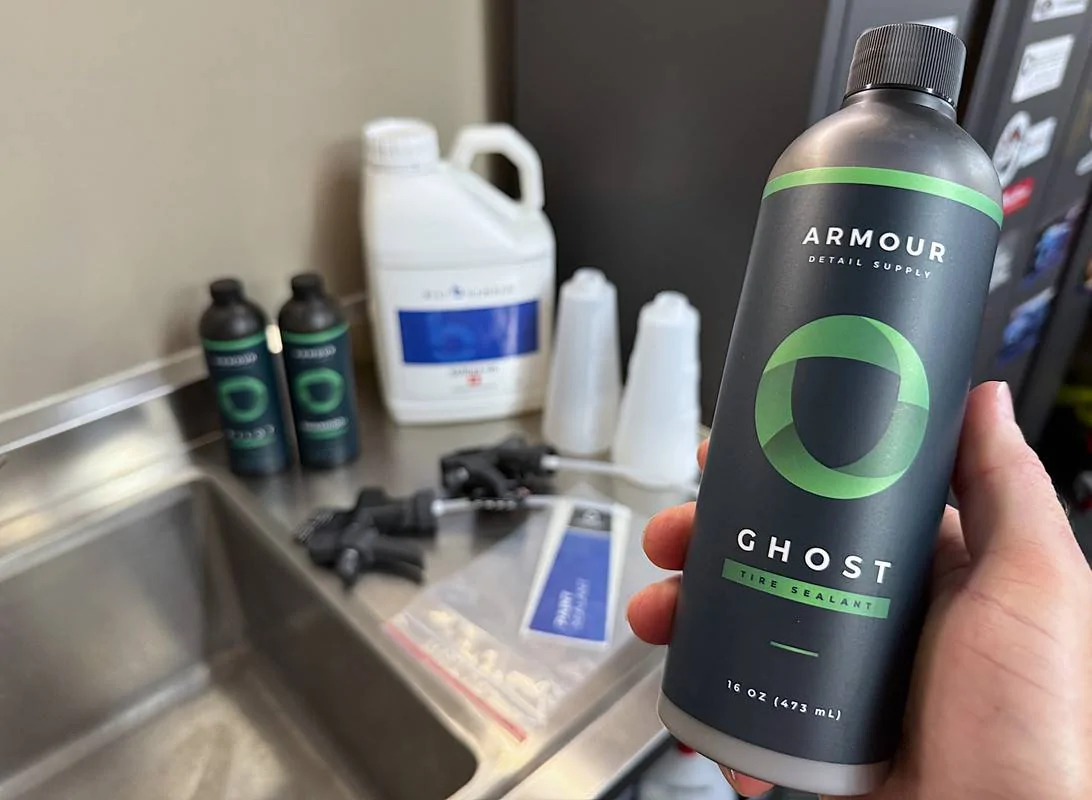

Have been waiting a while to try this one, finally available in Australia.........................................
S650 Mustang Aussie S650 Paint protection and detailing thread IMG-3768

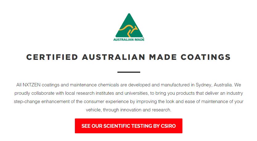

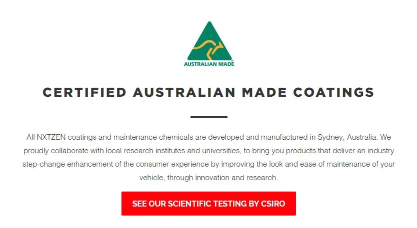

Anyone tried the locally produced Nxtzen products yet? I've been seeing them pop up in detailing videos recently but don't know much about them personally.
No, but I like supporting Aussie made.
https://nxtzen.com/collections/car-care-products

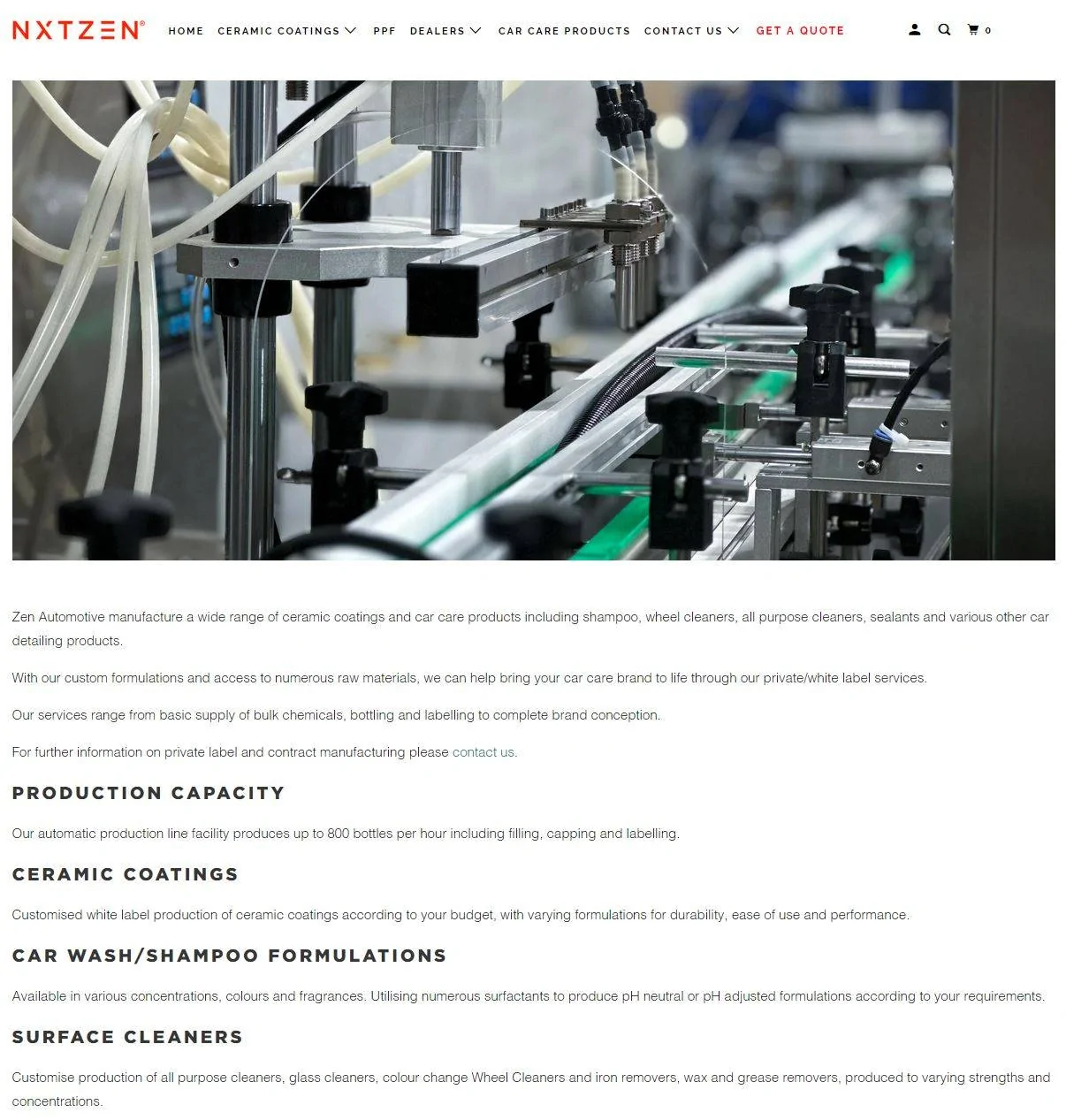

Within limits, I will happily spend more to avoid buying "Made in China", so this is no different, but compared to US pricing, Nxtzen should be a bit cheaper here than what it is.
Being a contract manufacturer, I wonder who else they make products for?
https://nxtzen.com/pages/contract-manufacturing-private-label

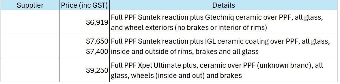

Hi all,
I've been getting quotes from PPF places around Sydney as I want to PPF and coat my car once it arrives. It will be my daily so figured it's worth spending the $$ to help alleviate scratches from the odd door bang, errant trolley and general stone chips (won't stop dents though!).
Here's the prices I received with some info about what they include. I've redacted the supplier names in case some of them are on here. If you want to know who they are send me a PM.
All options include prep (3 bucket wash, paint correction, clay bar etc...) and PPF of the hood vent. Not doing headlights as it can sometime be an issue, nor any tinting or the interior. I'll do the interior myself and want to see what the glass looks like before I commit to any tinting.
I'm going with the middle one, not the cheapest but he's more local to me and he did my neighbours M5 and X50M so I've seen his work already - looks pretty good and he removes badges and door handles before filming for a nicer finish. The others didn't say whether they do to this level of detail. Asked him to price match the cheaper quote and he wouldn't, but gave me a small discount.
The film warranties range from 10-12 years, the coating warranties ranged from 2-8 years. I don't believe anyone who says a ceramic coating will last 8 years. Reckon they just say that cause how is average Joe gonna be able to prove otherwise if they reject a warranty claim.
S650 Mustang Aussie S650 Paint protection and detailing thread 1738228372326-ln

Hey Deano,
The Xpel price is in line with Qld, and it is laser cut patterns and not cut on car, there was an issue with the DH vinyls, but made decision to single piece the bonnet, so there are no blend/dust lines, have pics up on here in another post....and after 6 months it has smoothed out nicely.

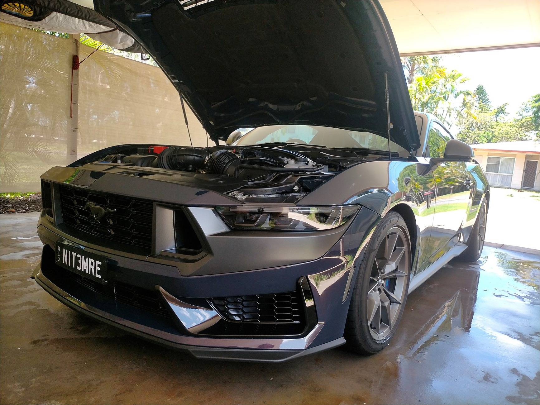

The detailer I used in Brissie put Gyeon coating over the PPF, and the entire car has the PPF covering and windows were tinted via a sub company (Gyeon tint)....the headlights are also PPF'd, was a little on the fence with that but literally can't tell but I guess time will tell.
S650 Mustang Aussie S650 Paint protection and detailing thread dh2
Gyeon treated brakes and rims, and given how dirty they get in a short drive, glad I did, basically takes a soft brush wipe and all new again.

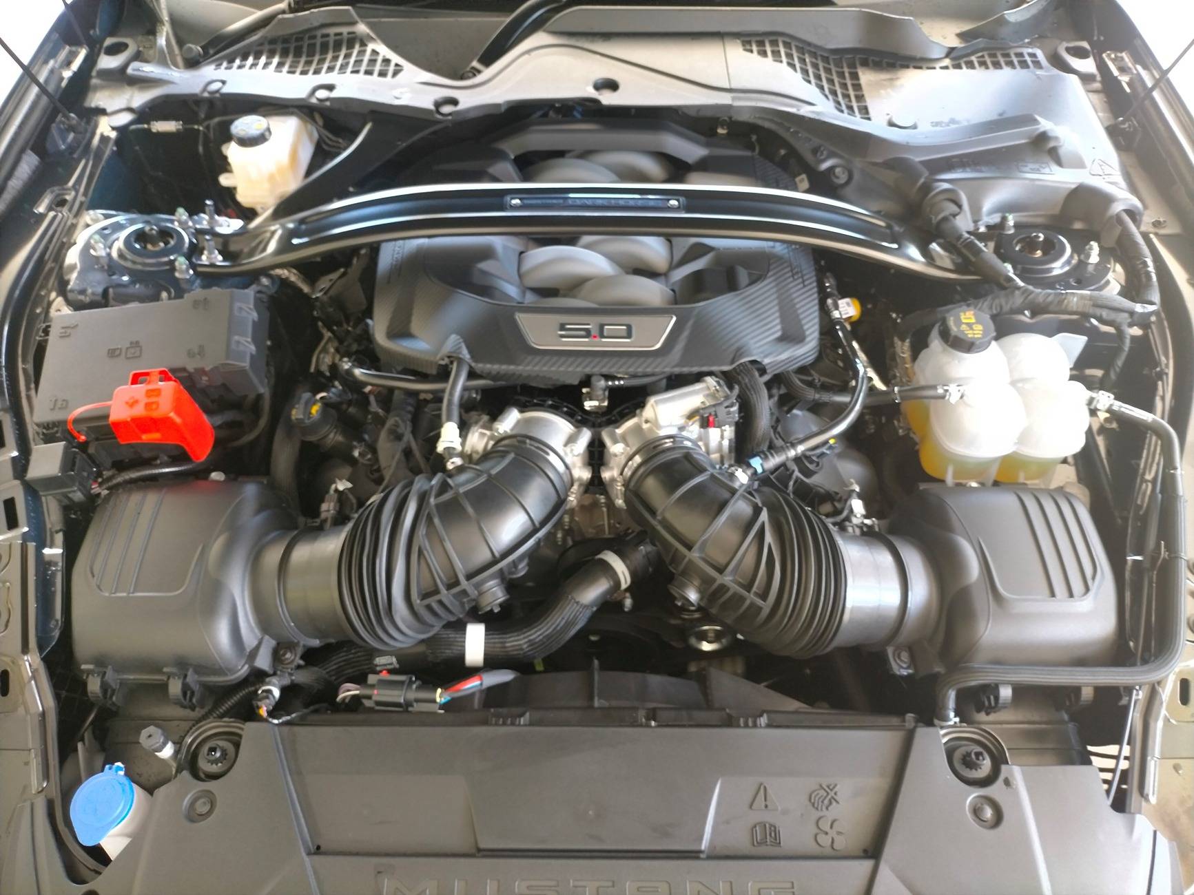

The company I used, also did the engine bay exposed paint and plastics in ceramic complimentary - was a nice surprise when I picked up the car, and after 6 months and 3100km, looks like it come straight out of the factory still, loving the no water stains even after being in the rain
S650 Mustang Aussie S650 Paint protection and detailing thread dh3

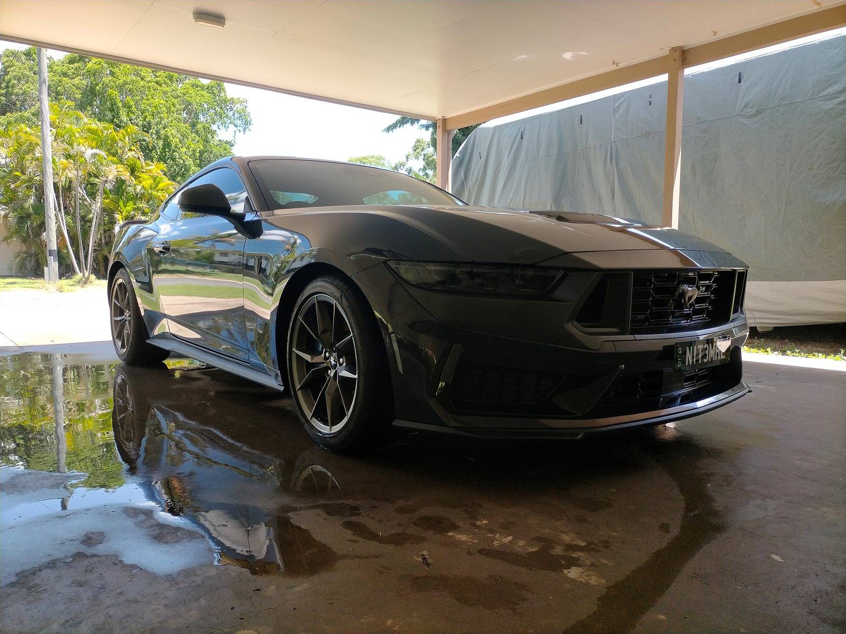

For me, it was worth the cost to protect the paint on the car, and so far have counted in excess of 50 marks on the PPF from stones and scratches, and all but 1 has self healed, if you closely at front right corner of bonnet, you will see unhealed stone mark, but from I can tell no damage below PPF, the car is not a daily driver, but when it does see the road, it is generally 500km at a time on very country roads. Did I mention that bugs just wash off?
S650 Mustang Aussie S650 Paint protection and detailing thread dh1
