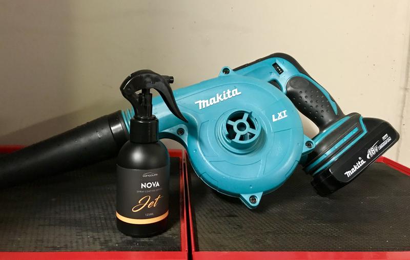

They are ok, but will take longer to do the job on a whole car. For blowing out mirrors, door handles, door jambs, wheels, they are a workable solution.
I used an 18v Makita jobsite blower for quite a while, I could blow the car down on a single 5.0ah battery, including the door jambs.

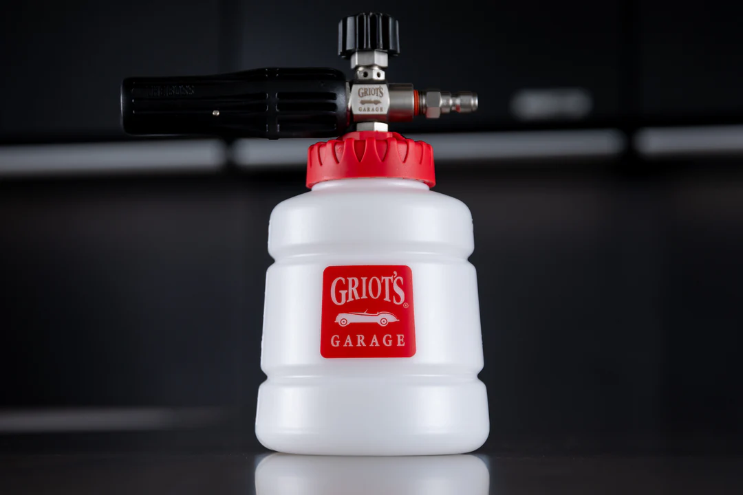

The Griots Boss Foam Cannon is arguably the best on the market. Last time I looked, the $99 USD turned into over $220 AUD by the time it was landed in Australia. However, I now see these are available on Amazon AU for $162. The main benefit of the Griots is the metering tips that can mean you don't need to dilute the soap, the foam cannon will do it for you. Actually, you can screw the cannon onto a bottle of soap.
Griot's Garage BF302 The BOSS Foam Cannon - for Use with Pressure Washers, High-Foam Output, Adjustable Nozzle, 9 x 5 x 7.5 inches, White : Amazon.com.au: Automotive

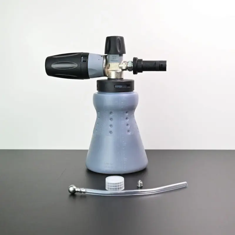

The MTM PF22.2 is what I have been using for more than 4 years now. You might have thought the $162 for the Griots was expensive, but the MTM is about the same price give or take a few dollars. The main thing I like about the MTM is that it seems to use less soap without compromising foam quality. Like the Griots, spare parts are available, as well as spare/extra bottles so you can dedicate bottles to certain products. The MTM is available from multiple vendors locally, most stocking spares as well. If you do go this way, make sure its the updated version with the wide-mouth bottle and weighted filter straw.
MTM Hydro PF22.2 Auto Detailing Foam Kit : Amazon.com.au: Garden
New -
MTM PF22.3 Foam Cannon Kit with NEW Wide Mouth Bottle 2024 - Detailing Shed
Old -
MTM Hydro PF22 Foam Cannon for Perfect Car Wash - Detailing Shed
it might look like I'm just promoting Detailing Shed here, but they have put in the legwork for the Aussie market and offer the most comprehensive spares and supporting fittings/parts. You will note that in those links, there are options to adapt to various pressure washers, in your case chose the Karcher adaptor, which will work with the standard Karcher gun. You can also upgrade to an aftermarket gun like the SGS28 or a foam cannon/gun kit, but if you still wanted to keep the standard gun, there are also adaptors to convert it to quick connect for that as well. I can advise on that if you need.
S650 Mustang Aussie S650 Paint protection and detailing thread IMG_E1320
As for a written review, I have this on the updated MTM here -
Updated MTM PF22.2 Foam Cannon | 2015+ S550 Mustang Forum (GT, EcoBoost, GT350, GT500, Bullitt, Mach 1) - Mustang6G.com
And a demo by yours truly (still using the older bottle design in that video).....................

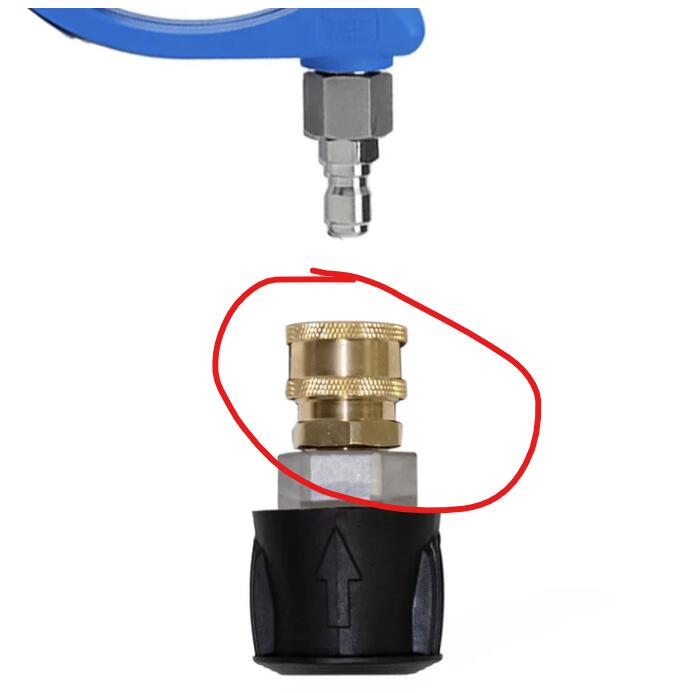

Hey @DFB5.0 did my 1st wash today using the mtm and the karcher k2 and what I'm realising is the karcher bayonet connector and the standard hose are a PITA to work with lol. The Karcher hose kinks all the time and connecting/disconnecting things from the gun are a PITA lol.
So if I want to upgrade the K2 with another hose that is longer and doesn't kink can I use something like this? Do I need additional connectors to connect it to a Karcher?
ProPulse Uberflex 1/4" Pressure Washer Hose – Waxit Car Care
For the gun
MTM SGS28 Gun for Professional Car Detailing - Detailing Shed
My goal is to convert to quick connects as they are so much easier to work with.
or maybe its cheaper getting a new pressure washer lol

Adding an aftermarket hose and gun will transform the user experience of any pressure washer. It will also allow you to shift the balance away from peak pressure for cleaning hard surfaces to a more flow orientated setup............................flow is what does the work when it comes to car washing not peak pressure. It can be hard to convey that to someone against using a pressure washer for car cleaning duties, that we are using the machine to boost water flow, not blasting the paint with ultra-high pressure water.
Hoses -
Typically, you will have the choice of 1/4-inch and 3/8-inch hoses for pressure washing. While I run a 3/8 hose, a 1/4 hose is easier to manage. Important to note you will still get some hose bind when going aftermarket, but nowhere near the horrible ultra-hard OEM hoses that have no give to them. An aftermarket gun with a live swivel helps mitigate this too.
In terms of length, you want at least 15-metres/50-feet. Anything less is a waste of time and money. At 15-metres, you won't need to move the pressure washer as you work around the car.
The Pro-Pulse/Uber Flex hoses are a nice upgrade offered at an agreeable price. You other option would be to go with a 3/8 MTM Cobra Jet, but I'd stick with 1/4-inch hose on a K2.
Gun & Wand -
I know you can get a short gun on Amazon for less, but they are junk. Considering the pressure involved here, going cheap on this part doesn't make sense. For that reason, I would be looking at Mosmatic or MTM.
I have the OG-spec Mosmatic gun with the integrated live swivel for less bulk at the hose connection. But....................................its very expensive. I also ran an MTM SGS 28 for a while, most people will prefer the SGS 28 for its smoother progressive trigger action.
Obsessed Garage OG Spec Mosmatic Swiveling Sprayer - Detailing Shed
A wand attachment is not essential, but nice to have. Again, I have the OG-spec Mosmatic. I also ran the MTM version, but I didn't like the plastic handle grip, not especially comfortable. If you wanted to bring down the cost, the DS-spec Mosmatic is nice too.
Mosmatic Premium Bent Lance OG Spec with Durable Design - Detailing Shed
Mosmatic Premium Bent Lance DS Spec - Detailing Shed
Stainless Steel Spray Lance for Foam Gun - Detailing Shed
Nozzles -
Keep in mind that you will also need nozzle tips for the short gun/wand. It's important to chose the correct orifice or you risk overworking the machine. For a Karcher K2, you would use the 3.0 orifice, as shown in the link below. Make sure you chose the orifice size when ordering, or specify it in the order notes.
The Pressure Washer Spreadsheet
The biggest question here is how or where to buy all this from. Waxit seem to offer the easiest end-to-end solution by bundling all of this together.
This kit will have you sorted, it also includes the 3.0 nozzle orifices and adaptor fittings to pair with a K-series Karcher. Sold out at the moment though.
Waxit Recommended Pressure Washer Upgrade Kit - Karcher K – Waxit Car Care
There are a couple of reasons why I would probably go a different route here. While the gun has a swivel, it's not fitted by MTM as Waxit seem to be buying the basic (un-fitted) SG-28 and fitting cheaper non-MTM swivels and quick connect fittings. And as mentioned, I'm not in love with that wand.
I know you will pay a bit more, but I would make two separate orders to get the exact spec -
ProPulse 50ft Hose -
Hose to Machine Adaptor -
ProPulse 1/4" Uberflex Hose Adapter Kit – Waxit Car Care (Sold out at the moment)
Convert Karcher Fitting to M22 for Sale Online - MD Car Care
Male thread 3/8 Quick Connect (M22 / 14mm) -
Stainless Steel Coupler for MTM Hydro Twist Seal Plug - Detailing Shed (Stainless)
Aquatouch Pressure Washer Adapters - 3/8" Female QC - M22 Male – Waxit Car Care (Brass)
SGS 28 Short Gun (you won't need the Karcher adaptor here) -
40 degree (3.0 Orifice) Nozzle -
MTM QC Hydrojet SS Nozzle for Spray Foam Gun - Detailing Shed (Basic)
MTM Hydro Stainless Steel QC Nozzles 4-Pack - Detailing Shed (Set)
Mosmatic Nozzle with Guard 40° Fully Assembled - Durable and Efficient - Detailing Shed (Advanced)
MTM Pressure Washer Nozzle – Waxit Car Care (Advanced, sold out)
Wand (Optional) -
I know that's a lot, it sounds more complicated than it is. You easiest bet would be to wait for the Waxit kit to be back in stock.
As for cheaper buying a new machine, not necessarily because you still need all these parts and pieces to make it work as it should. All of this stuff can be transferred to a new machine in the future.

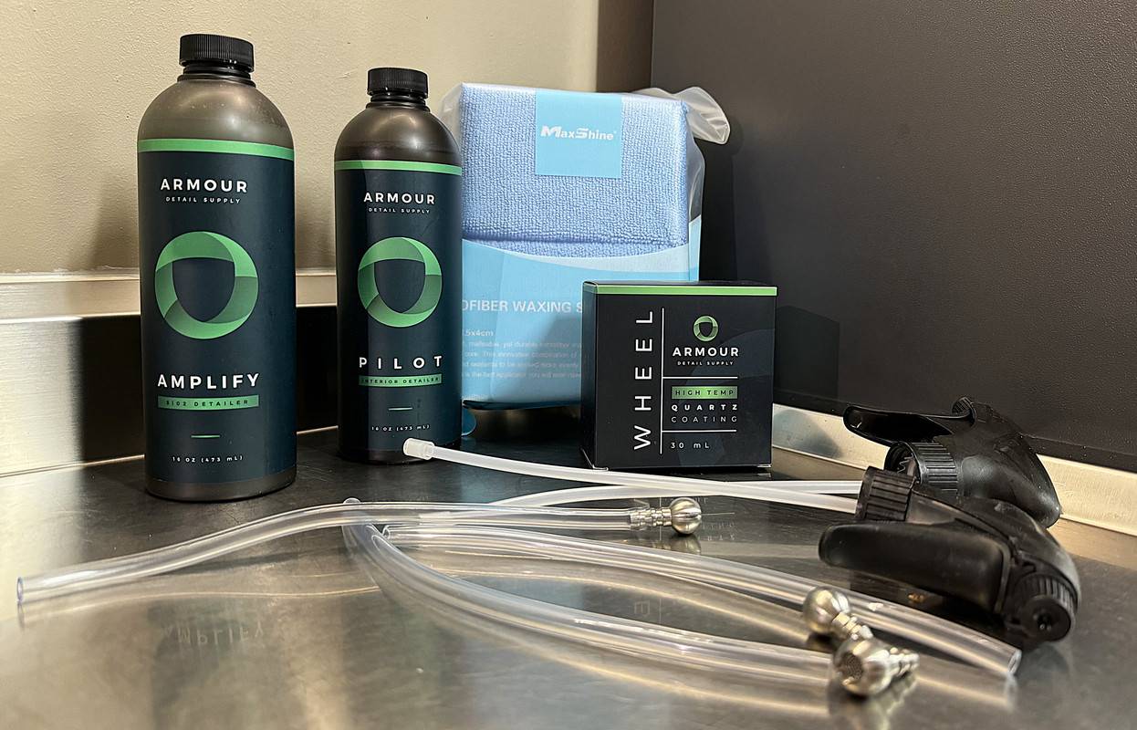

And while on the Detailing Shed topic, I squeezed in a final order before they close up for a few weeks.
S650 Mustang Aussie S650 Paint protection and detailing thread IMG-3453
