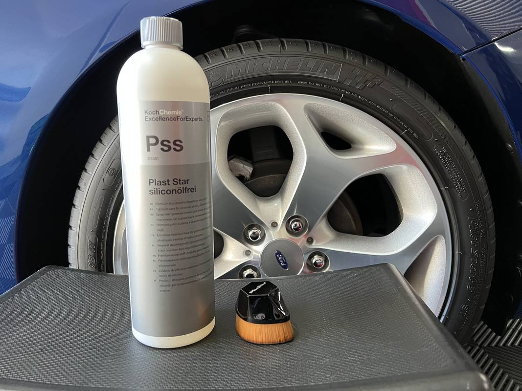

Koch Chemie Plast Star PSS
Koch Chemie Plast Star is an exterior dressing designed for unpainted plastic and rubber surfaces. Unlike a lot of water-based exterior dressings, Plast Star's ability to bond to the treated surface means it will last "months, not weeks". The protective layer left behind will then protect old and new surfaces from UV damage and fading.
Koch Chemie (PSS) Plast Star Silliconolfrei | Exterior Plastic Care – Waxit Car Care
S650 Mustang Aussie S650 Paint protection and detailing thread plaststar
Plast Star can be used to enhance and protect new plastic and rubber trim, preventing premature discoloration. It also has the ability to revive older, faded surfaces. I've found treated areas take on a darker, satin sheen. Plast Star can be used on the following areas -
- Rubber/plastic window and door trims
- Unpainted bumpers, bumper inserts and diffusers
- Unpainted side skirts
- Unpainted wing mirrors
- Door seals
- Engine bay plastics
- Wheel arch liners
- Tyres
Early on, my initial uses for PSS were on tyres and rubber window trims. I have also used it on side steps, although just be mindful that it will add some slickness to those surfaces.

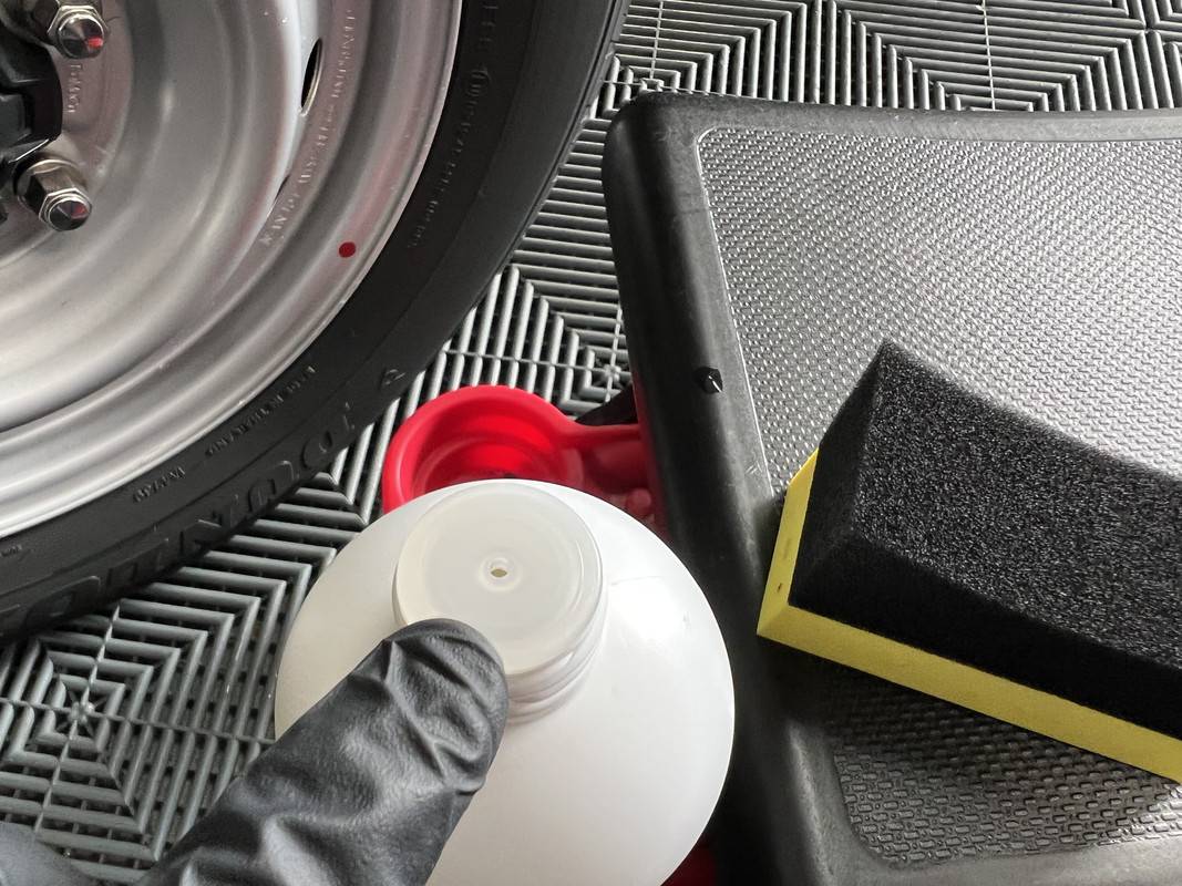

How To Use -
As with any protective layer, the success or otherwise lies in the preparation before application. PSS is not different.
1. No matter the surface, start by cleaning the areas to be treated. For tyres, use a strong tyre cleaner, on trim you may want to use a strong APC and wipe down with an IPA prep spray.
2. Ensure the areas for treatment are fully dry before application.
3. Add PSS to a sponge or microfiber applicator and work it over the surface. The product will go on quite wet and runny, but as it bonds and flashes, it will turn sticky............that is your clue that it's been worked sufficiently. Sometimes, you may need to apply a second layer on faded surfaces.
4. Allow the product to dry and fully bond.
S650 Mustang Aussie S650 Paint protection and detailing thread IMG-4297
Usage Notes -
- On plastic and rubber trim, you may find using a prep spray will help evaporate any remaining moisture before application.
- For trim and plastics, PSS is best applied with a microfiber applicator. On tyres, I've found those ultra-dense cosmetic-style brushes to be the pick.

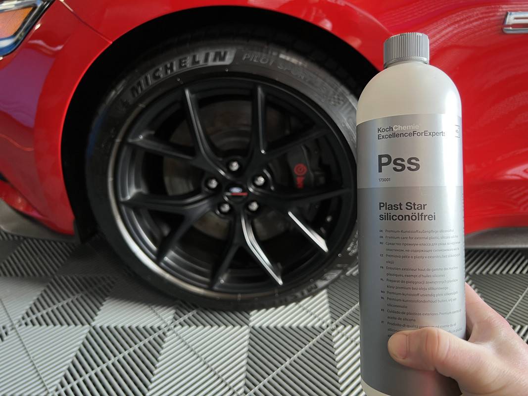

- You will find PSS a little grabby on tyres, especially as it begins flashing.
- Once bonded, PSS is dry to the touch and won't accumulate dust and dirt.
- PSS is a ready to use product and should not be diluted or used on wet surfaces like, say, 303 or Hyper Dressing.
- PSS doesn't come with a spray head, rather the signature KCx dispenser.
- Koch Chemie suggests PSS will leave a "semi-matte appearance". If used on tyres, you may find it a little glossier, tyre dependent though.
S650 Mustang Aussie S650 Paint protection and detailing thread IMG-4470
Final Thoughts -
The biggest drawcard of Plast Star is its durability compared to other trim dressings. No, it won't approach the longevity of a trim dye such as Solution Finish, or a ceramic trim coating. But it will easily outlive a water-based dressing that will disappear at the next wash. In other words, PSS is a happy middle ground, both in application ease and overall longevity.
