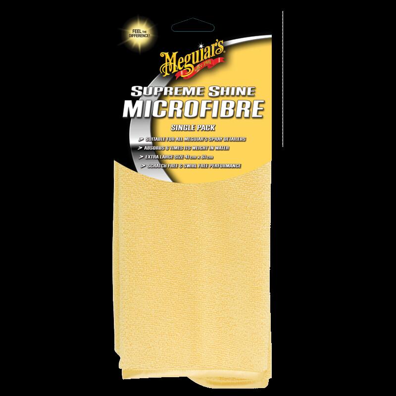

I hope my responses don't come across condescending, certainly not my intention. I was where you are at the moment and learnt in a similar way, asking questions and doing my research. This included towels because I used to ration them, they were a significant investment for me at the time.
Back in the early 2000's, microfiber wasn't mainstream. For my "good" towels, I started out using whatever was available at the auto-store, namely those Meguiar's terry towels and the gold microfiber. I'd then buy cheap prepackaged towels from the Reject Shop for "B-grade" towels, then pinch rags from my father's workshop for dirty jobs. Two things that stand out here, those Meguiar's towels were (and still are) vastly overpriced. Secondly, those Reject Shop towels were cheap for a reason.
S650 Mustang Aussie S650 Paint protection and detailing thread megssmf100
S650 Mustang Aussie S650 Paint protection and detailing thread mctt101
I then found The Rag Company and discovered good towels aren't necessarily expensive, you just need to know where to shop for them. The hardest part is knowing what towel suits each task. I remember sitting in front of my computer with an endless list of towels on offer and being completely overwhelmed, you know how it is when presented with too much to choose from. It took me many years to know what to look for in towels, so when I make recommendations, its after making all the mistakes myself. Stuff like buying cheap towels because more is more, only for them to be completely useless at just about everything. Or buying towels from the auto-store that, while decent towels, are so overpriced because you are paying for a label and packaging as well. Or using the wrong towel on glass and wondering why my windows were covered in lint.

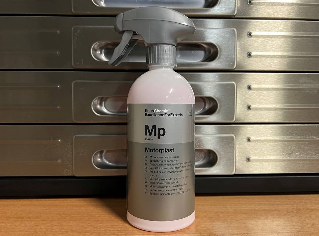

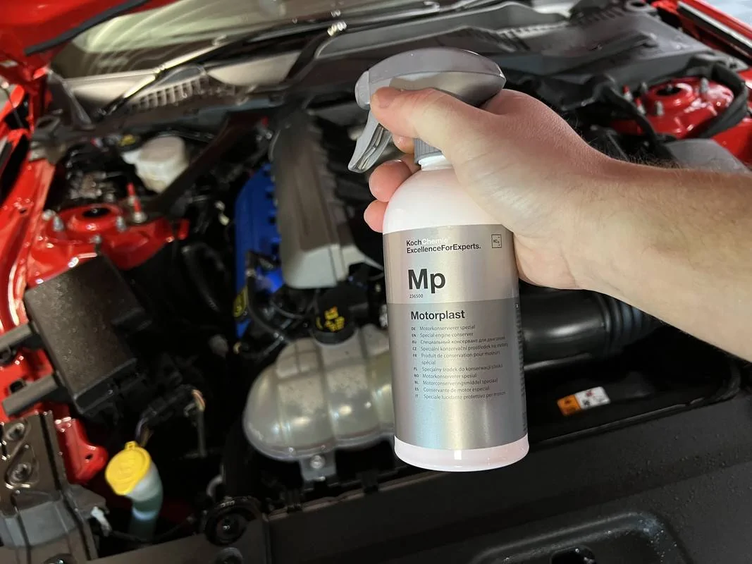

Koch Chemie Motorplast MP
This is another one of those in-demand products from Koch Chemie that was very hard to get for a while there, and when it returned, it commanded a $30 price premium. Since then, the price softened but was still too expensive for what it was. Now though, at $25.95, Motorplast is back in the game.
Koch Chemie (MP) Motorplast | Engine Bay Conserver – Waxit Car Care
Koch-Chemie - Motorplast | The Rag Company
S650 Mustang Aussie S650 Paint protection and detailing thread IMG-3006
What Is Motorplast?
Motorplast is what Koch Chemie call an "engine bay conserver"..................in other words, a water-based dressing for your engine bay that will deliver an as-new look. It can be used on a dry surface, however it has the ability to displace water on wet surfaces. In that regard, its perfect to use after cleaning your engine bay, more on that shortly.
Motorplast is heat resistant up to 250 degrees C, the elastic-like film able to breath with temperature fluctuations. Unlike some dressings, once dry Motorplast will prevent dust attraction and adhesion. While primarily beneficial to plastic and rubber surfaces, it will also protect metal from corrosion and other environmental factors. The product also has a distinctive scent that seems to be a crowd pleaser.
S650 Mustang Aussie S650 Paint protection and detailing thread IMG-3094

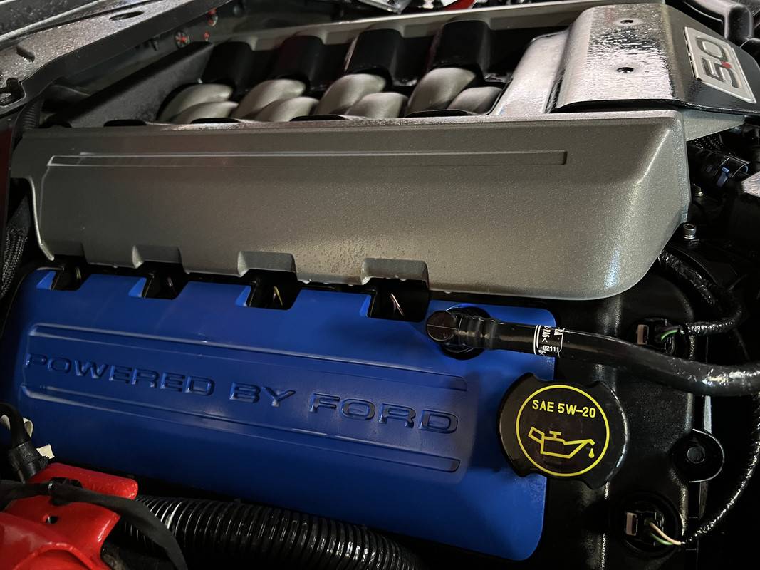

How To Use -
You can apply Motorplast on wet or dry surfaces, but its quicker and easier to apply directly after cleaning and while the engine bay is still wet. For the full process, check out the following thread -
(1) Engine Bay Cleaning and Detailing | 2015+ S550 Mustang Forum (GT, EcoBoost, GT350, GT500, Bullitt, Mach 1) - Mustang6G.com

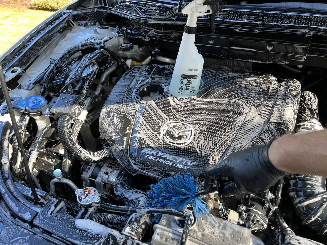

1. Start by cleaning, or at the very least, rinse the engine bay.
S650 Mustang Aussie S650 Paint protection and detailing thread IMG_4373

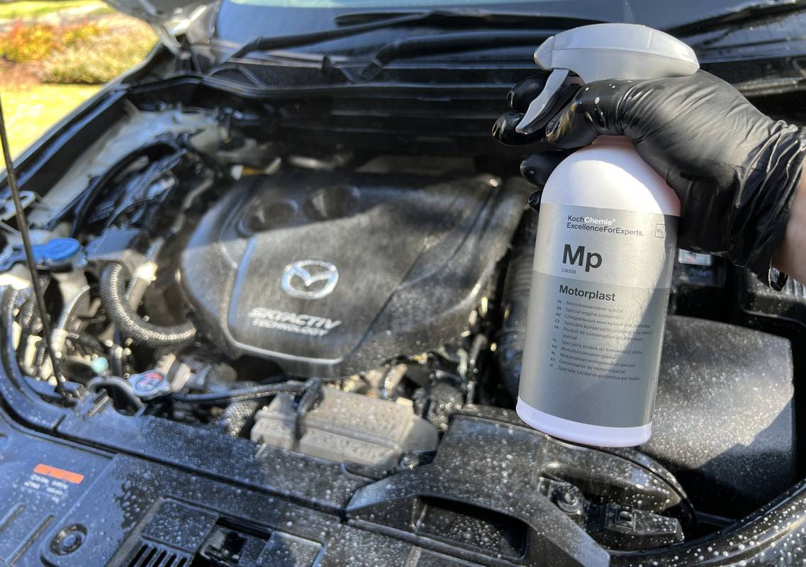

2. Once clean and while still wet, spray Motorplast generously across the entire engine bay. Don't worry about getting it on painted/metal surfaces, it won't harm these areas or look greasy.
S650 Mustang Aussie S650 Paint protection and detailing thread IMG-4378

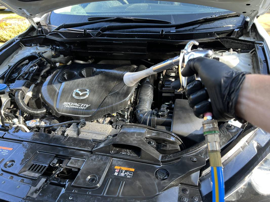

3. Optional, grab your blower or compressed air to distribute excess water and dressing. I've found this super helpful in getting dressing into the various ribbed and intricate areas without having to mess about with brushes and towels.
S650 Mustang Aussie S650 Paint protection and detailing thread IMG_4382

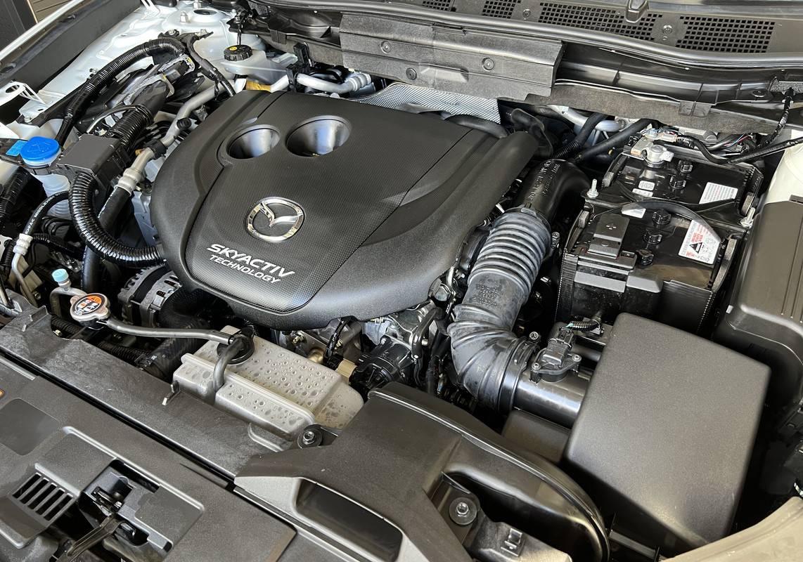

4. Close the hood, job done.
S650 Mustang Aussie S650 Paint protection and detailing thread IMG_4425

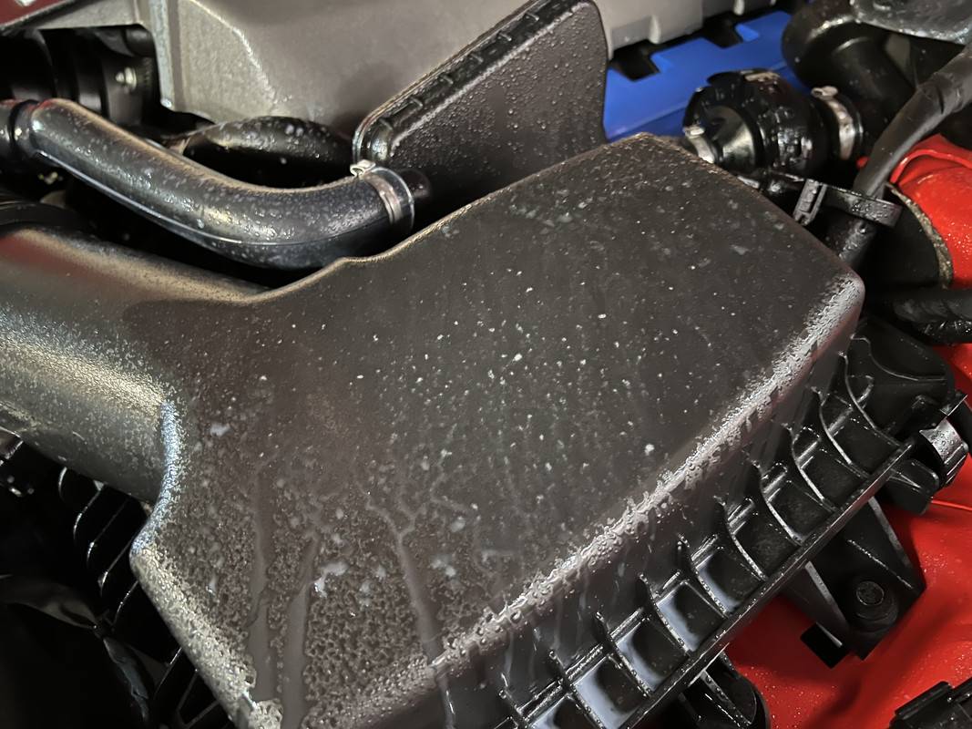

Usage Notes -
- The best part of Motorplast is how it self-levels when applied to a wet surface. This means you don't have to be super specific with its application, just spray generously and close the hood.
- When applying, you are aiming for generous coverage.
S650 Mustang Aussie S650 Paint protection and detailing thread IMG-3103
S650 Mustang Aussie S650 Paint protection and detailing thread IMG-3104
- You may need to return with a towel a few hours later to level off any high spots.

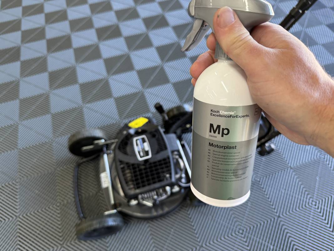

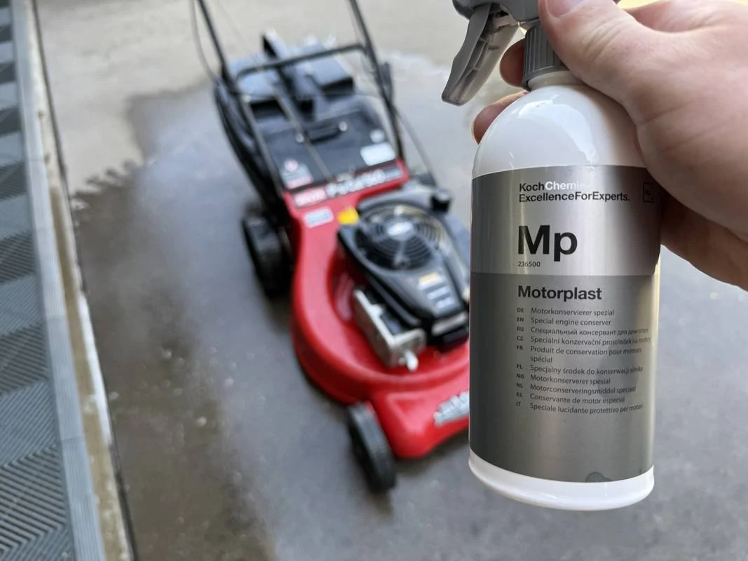

- Probably not an obvious one, but I also use it on my lawn mowers.....................
S650 Mustang Aussie S650 Paint protection and detailing thread IMG-4024
S650 Mustang Aussie S650 Paint protection and detailing thread IMG-4056

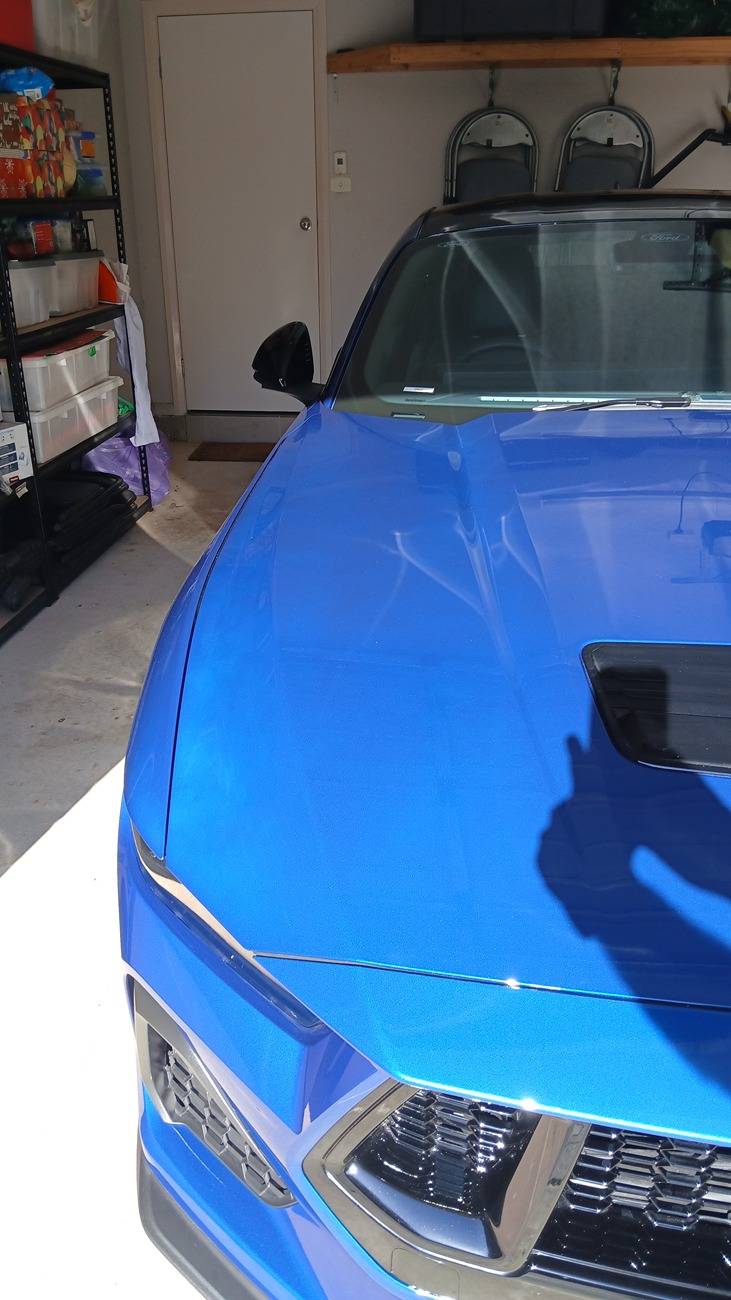

Hi guys,
Didn't think this worth worth a new thread so figured I'd post here since it's paint related.
Check out the pic below, mottling of the colour where the bonnet meets the qtr panel on the drivers side. You might need to zoom to see it.
It extends from the bonnet ridge to the qtr panel for the length of the bonnet.
Have sent these to the dealer and he's asking the service dept about it, doubt they can do anything, and the cure might be worse than the disease.
It's booked for PPF next week, will still get it filmed and if they end up replacing the bonnet, I'll try and get them to pay for new PPF too.
S650 Mustang Aussie S650 Paint protection and detailing thread 20250212_174200

Looks as if it didn't get enough paint at the factory.

Agreed.
Inadequate base coat. :frown:

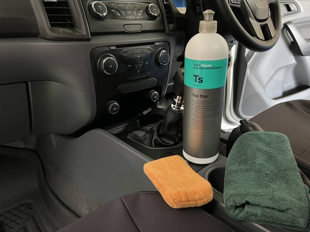

And so, we arrive at Koch Chemie Top Star.
Koch Chemie (TS) Top Star | Interior Plastics Care – Waxit Car Care
Koch-Chemie - Top Star | The Rag Company
S650 Mustang Aussie S650 Paint protection and detailing thread topstar02

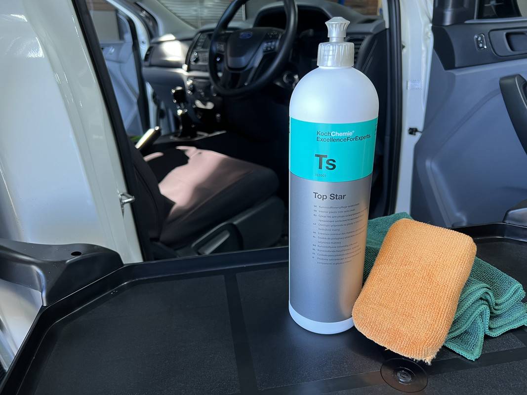

What is Top Star?
Koch Chemie Top Star is a product that can be used to dress and protect a range of interior surfaces. Plastic, vinyl and rubber surfaces will all benefit from regular applications of Top Star, think rubber seals, dashboards, door trims, center consoles, steering wheels and even artificial leather.
Koch Chemie suggest Top Star can be used as a combined cleaner and protectant, which would be fine on a lightly dusty interior, but you really should clean separately before application.
Once treated, Top Star leaves behind UV inhibitors and anti-static properties. I'd describe the finish to be a natural to satin sheen appearance, which provides a more noticeable result than 303. The scent is consistent with other KCx interior products, a subtle fresh fragrance.
S650 Mustang Aussie S650 Paint protection and detailing thread IMG-3506

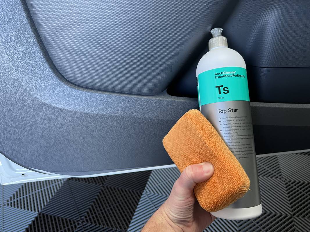

How To Use -
Top Star is a very runny liquid, as such you have options when it comes to application. The product can be sprayed or via the supplied dispenser cap. For spraying, you will need to remove that dispenser cap from the neck of the bottle. Top Star can be applied using a folded towel or microfiber brick.
1. Ensure you are working with a clean, dry surface. Use something like the previously mentioned ASC or Pol Star for example.
2. Lightly shake the bottle before opening.
3. Prime your towel or applicator with Top Star by spraying or dispensing.
4. Work the product over the areas to be treated. I've found Top Star offers excellent coverage, so only small additional amounts will be needed as you work around the interior.
5. Top Star will generally evaporate and self-level, but you can help things along with a separate dry towel if you like. On glossier surfaces, you may need to wipe over these areas to remove streaks.
S650 Mustang Aussie S650 Paint protection and detailing thread IMG-5421
Application Notes -
Top Star is very forgiving to use, so there isn't much to highlight here.

- I prefer to apply Top Star with a microfiber applicator brick as it offers more control. Foam applicators can also be used, but a short pile microfiber applicator will spread the product more evenly and help prevent streaking. I like the TRC Pearl applicators and the Carpro/Gyeon finger mitts.
Microfiber Pearl Weave Applicator Sponge | The Rag Company
CQUARTZ Microfiber Applicator (5 pack)
The Rag Company Pearl Applicator Sponge – The Detail Store
CARPRO Microfiber Applicator - 5 Pack – Waxit Car Care
- I also tend to use the supplied dispenser cap.
- Koch Chemie don't provide a longevity for Top Star other than "long lasting". I'd say expect 2 - 3 months, just depends how much sunlight the vehicle is subjected to.
- Treated surfaces tend to take on some slickness, so probably don't apply to the steering wheel rim, gear shifter, floor mats and pedals.
S650 Mustang Aussie S650 Paint protection and detailing thread IMG-3509

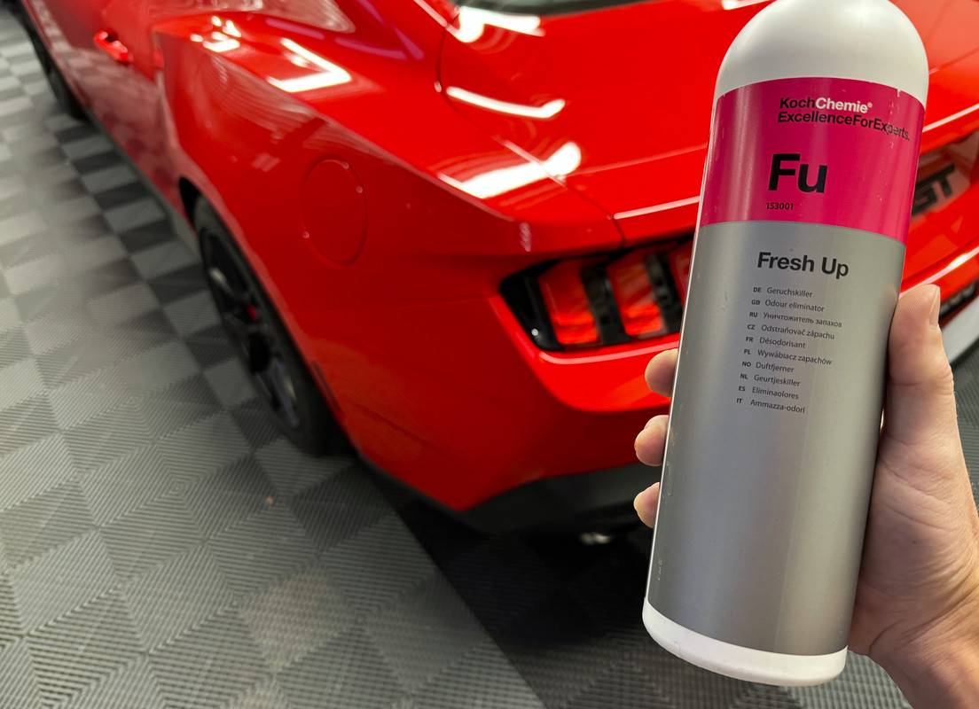

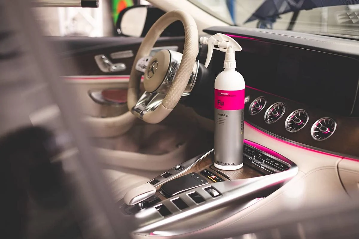

Koch Chemie Fresh Up FU
I wonder if the Germans knew what they were doing when they gave this product it's abbreviated name? Anyway....................
Koch Chemie Fresh Up is a product designed to refresh the smell of vehicle interiors. It would be easy to assume that Fresh Up is simply an air freshener, and in that regard, it certainly instills a pleasant, fruity aroma. What separates Fresh Up from a basic interior scent is how it targets odors by neutralizes them instead of just covering them up.
Koch Chemie suggest Fresh Up "encapsulates odor molecules", in turn "eliminating them and making them ineffective". In other words, its a deodorant for your car. Fresh Up is said to eliminate unpleasant smells caused by pets, cigarettes or anything leaving an unusual odor behind (spilled food and beverage). In addition to car interiors, it can also be used on caravans, boats and household areas.
Koch Chemie (FU) Fresh Up | Odour Eliminator – Waxit Car Care
Koch-Chemie - Fresh Up | The Rag Company
S650 Mustang Aussie S650 Paint protection and detailing thread kcxfreshu
How To Use -

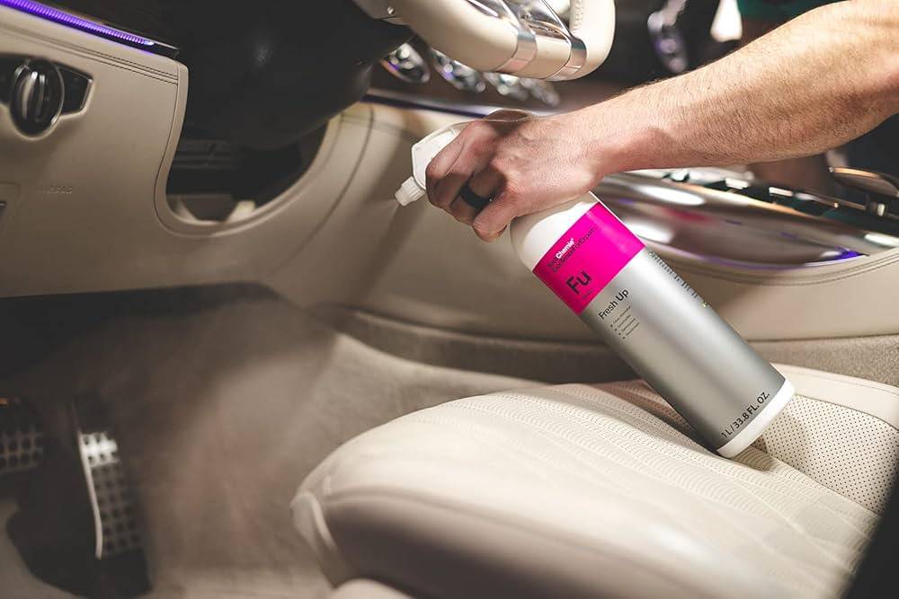

Fresh Up is intended to be used after cleaning as a final step. Sometimes despite extensive cleaning, an odor will remain because the chemicals haven't broken down certain bacteria molecules. Fresh Up in turn helps neutralize what remains.
1. Clean the interior or affected areas.
2. Fresh Up is typically sprayed directly onto affected surfaces, be that carpet, fabric or plastic surfaces. Mist Fresh Up across the area, aiming for a consistent light coverage, no need to soak things down with it.
3. Allow to dry.
S650 Mustang Aussie S650 Paint protection and detailing thread freshu

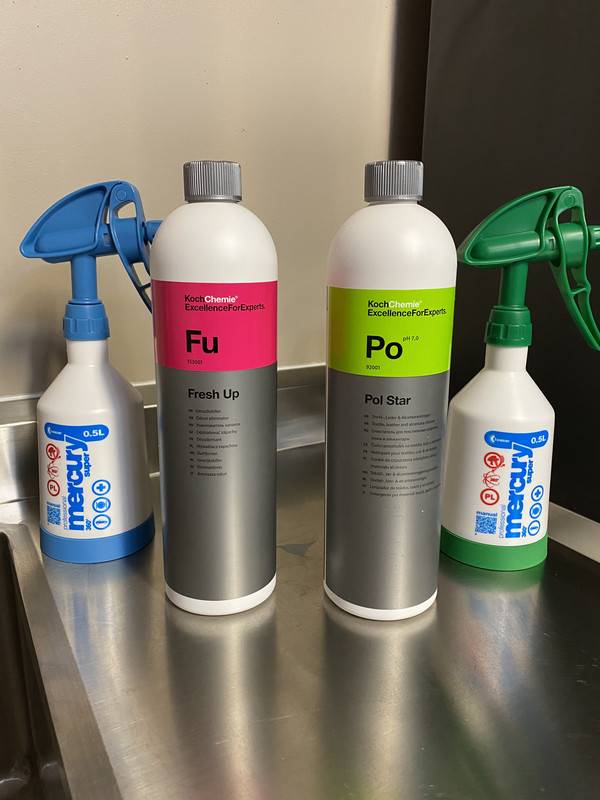

- Fresh Up is ready to use and dilution is not recommended, you need full strength to do its job effectively.
- Know that sometimes an odor will remain due to a lack of product coverage. This would apply to odors coming from the HVAC system or other hard to reach areas. In those situations, you may need an ozone machine.
- Fresh Up is not supplied with a spray head, common to the white bottle Koch Chemie line. This is because the brand was/is primarily focused on the professional user who would have a stock of spray heads and/or bottles to use with these products with.
S650 Mustang Aussie S650 Paint protection and detailing thread mar21912
- I've found this is another product that kills spray heads. The KCx canyon sprayer will work, but I'd purge the chemical out of the spray head after each use, or be prepared to swap spray heads as needed.
