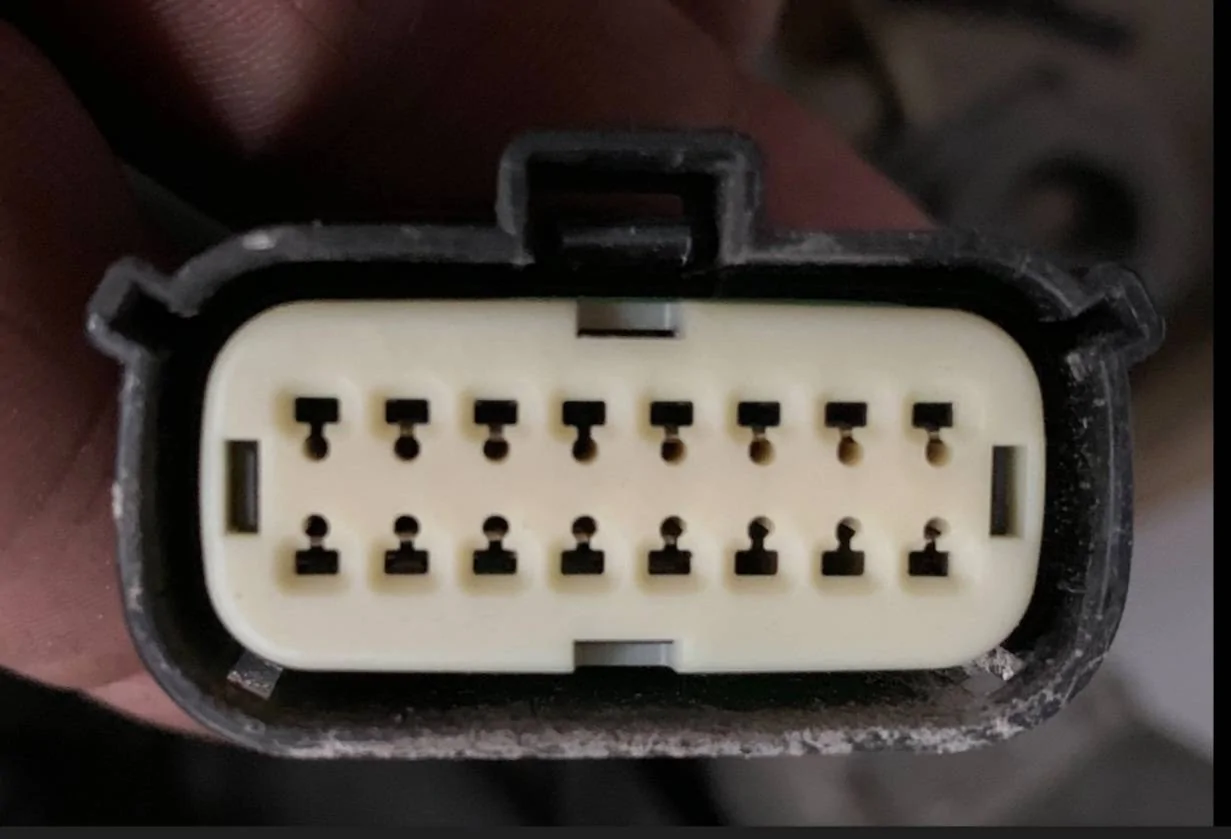

Okay, I need some help from the tech guys.
I found a picture on the internet of the door harness connector that I have to release the side mirror connector from.
So this is the thing that has a tab somewhere to press so I can release the connector.
Can somebody tell me where the tab is and how I need to press it to release the cable?
Because all of this I have to do blindly
S650 Mustang Are the side mirrors with turn signals plug and play? Screenshot_20250328_151734_Googl
cause this connector is hidden and can only do this by feeling.

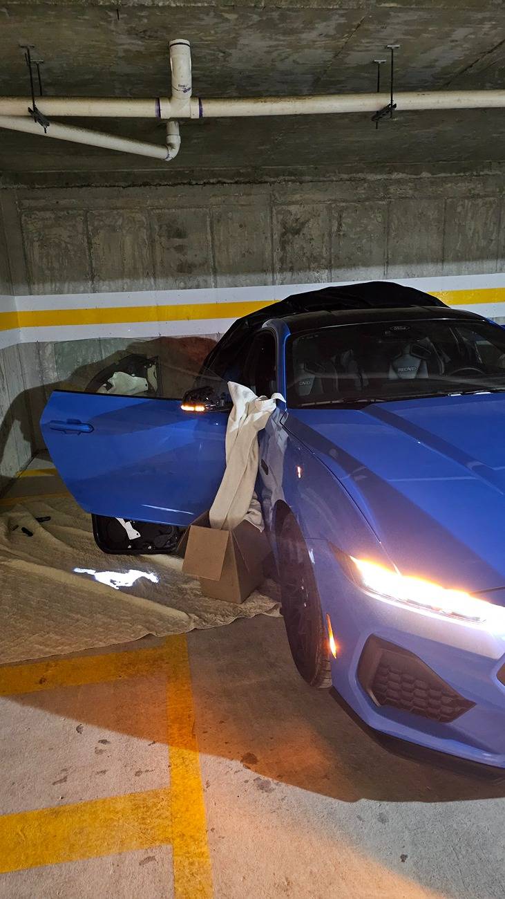

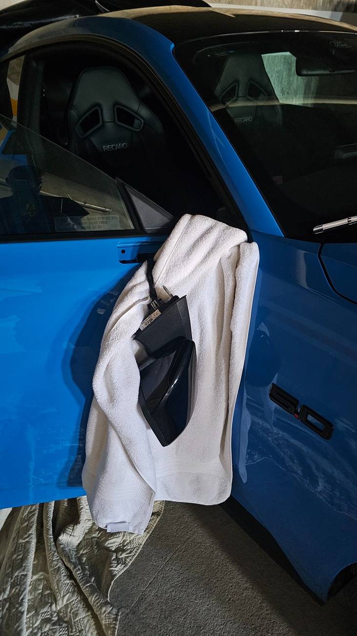

I gave it a second try. This time it took me 1.5 hours to disconnect the connector. No succes.
The area is too small and too tight.
I tried a different way. Unbolt the 3 bolts of the side mirror, release the side mirror and let it dangle, then the connector gets verticle. Somebody said its easier to disconnect it that way. Nope, still impossible.
There was another video who said you have to use a flat screwdriver to get inside the connector to release it. For some reason I can't find the lip blindly when having the screwdriver in my hand. The area is too tight to find it blindly.
In total I was busy for 5 hours.
3.5 hours was only trying to disconnect the connector.
I'm getting desperate.

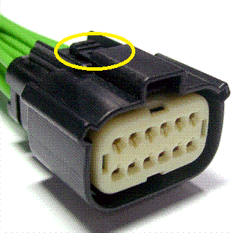

I looked on my car, they all appear to be hard to get to.
Push down on the tab (circled) while pulling apart.

Thanks so much. I think I might pull it out today!
I'll go try it in 30 minutes! Will let you know. But I have a feeling this might work now!!

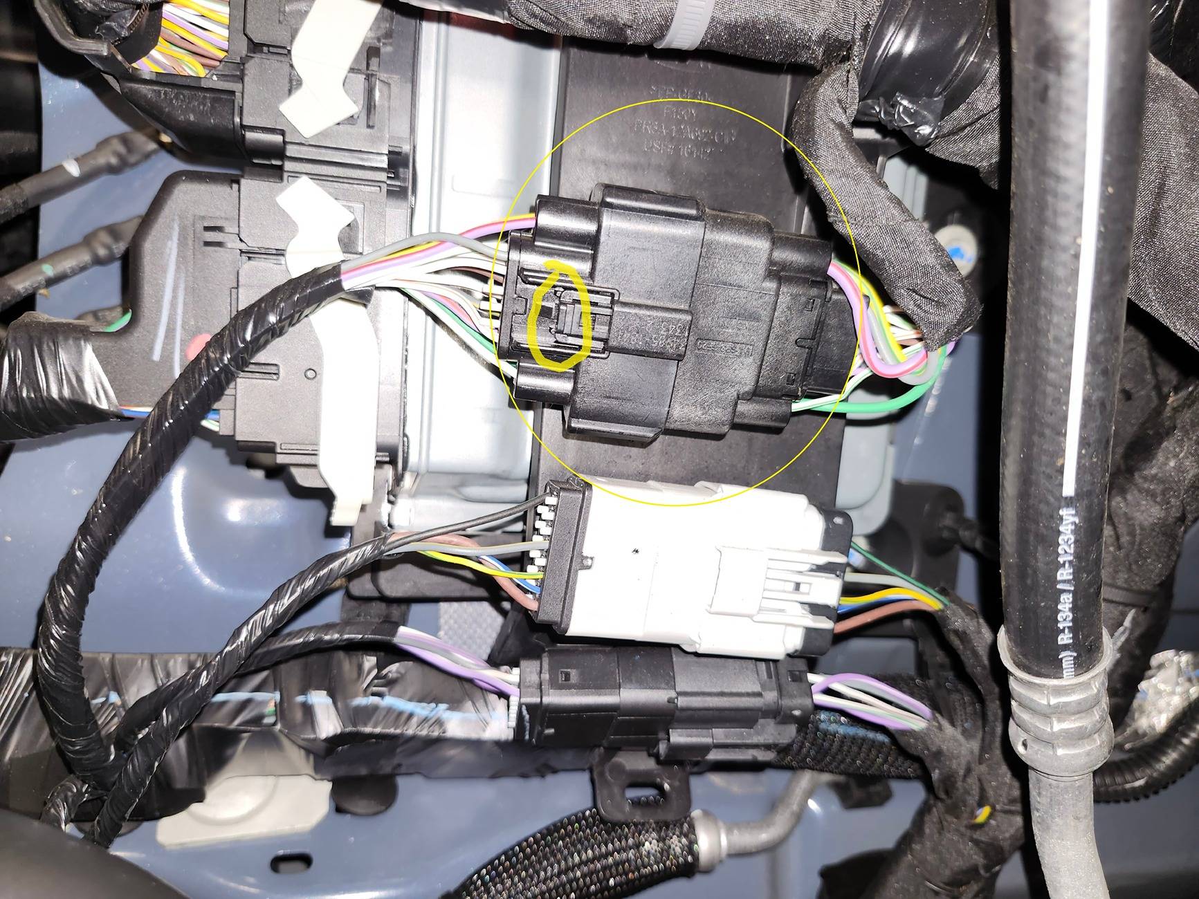

It looks like this connector here has the same type of tab (different connector).. located on right fender, below the fusebox. You will need to push down on tab... usually pretty hard. at least you can see how it should work.

You are a HERO!!
Not only I disconnected the connector, but the turn signals are PLUG & PLAY!!!!
Now I'm super mad at Ford why they didn't give me my side mirrors with turn signals since I have the 401A equipment group!!
Ford is really cuttings costs with stupid excises like "you have a different door harness because you have Recaro seats an no memory function.
Yes I have a different door harness because of my Recaro seata but it's plug and play you stupid chicken nugget!!!!
I worked the whole day since 12pm on this.
But at the end, it saved me a LOT of money, because it's plug and play.

Okay maybe I was happy a little bit to early.
My puddle lights and ambient light wont turn off anymore.
Im going to put back on the old side mirror and see if everytjing is back to normal.
