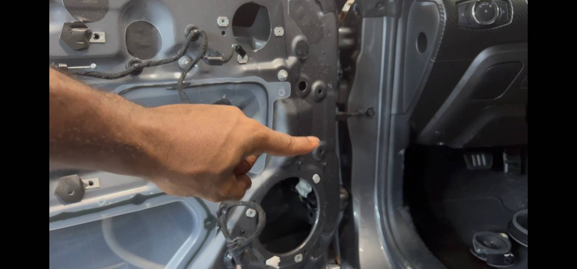

What I know is that the connector is hidden in the hollow area in the edge of the door.
When installing the mirrors, you can't see the connector and you have to put your hands inside a small speaker hole to release the plug from the connector blindy.
S650 Mustang Are the side mirrors with turn signals plug and play? Screenshot_20250314_230549_YouTu
The connector is behind the metal where his finger is pointed. Definitely makes it hard to inspect it.
I hope it's plug and play but @A4techpl told me that it's not and you should tap the wire from the front headlights or rear lights.
