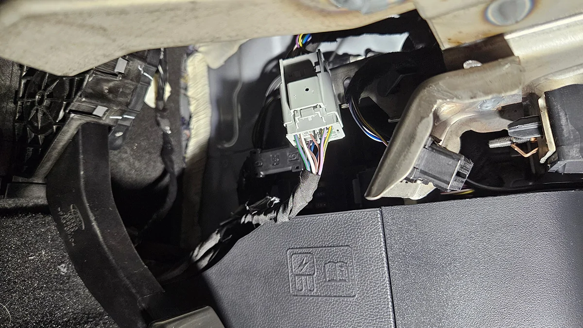

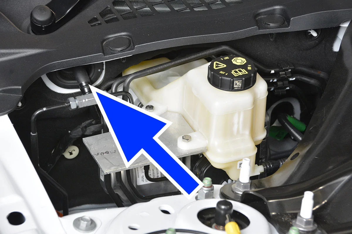

I would lean towards powering the hot side of the relay from a fuse tap in a spare fuse slot (BJB F140 or F125). Ground side of the relay would connect to the switch. Other switch contact would find a chassis ground near where the switch is mounted,
The only drama I see is running a wire from the cabin through the firewall into the engine bay.
S650 Mustang Anti Theft Solutions _DSC7904_1200
I know there is a grommet near the brake fluid reservoir that is accessible, but what about from the inside?
Any thoughts on that?

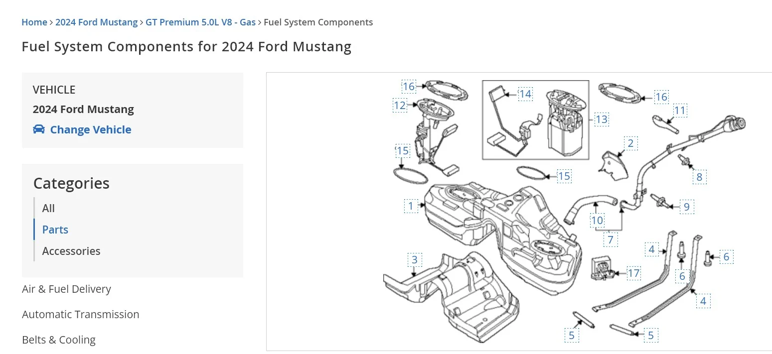

Thinking about this some more....
S650 Mustang Anti Theft Solutions Screenshot 2025-10-09 165920
https://ford.oempartsonline.com/v-2...0l-v8-gas/fuel-system--fuel-system-components
Fuel pump (??? - there's two part numbers listed!)
https://ford.oempartsonline.com/oem-parts/ford-fuel-pump-assembly-jr3z9h307c?c=Zz1mdWVsLXN5c3RlbSZzPWZ1ZWwtc3lzdGVtLWNvbXBvbmVudHMmbD0xNSZuPUFzc2VtYmxpZXMgUGFnZSZhPWZvcmQmbz1tdXN0YW5nJnk9MjAyNCZ0PWd0LXByZW1pdW0mZT01LTBsLXY4LWdhcw==
Interrupting a power wire on an old-school fuel pump would have been easy.
But these days, hmmmmm. :whew:

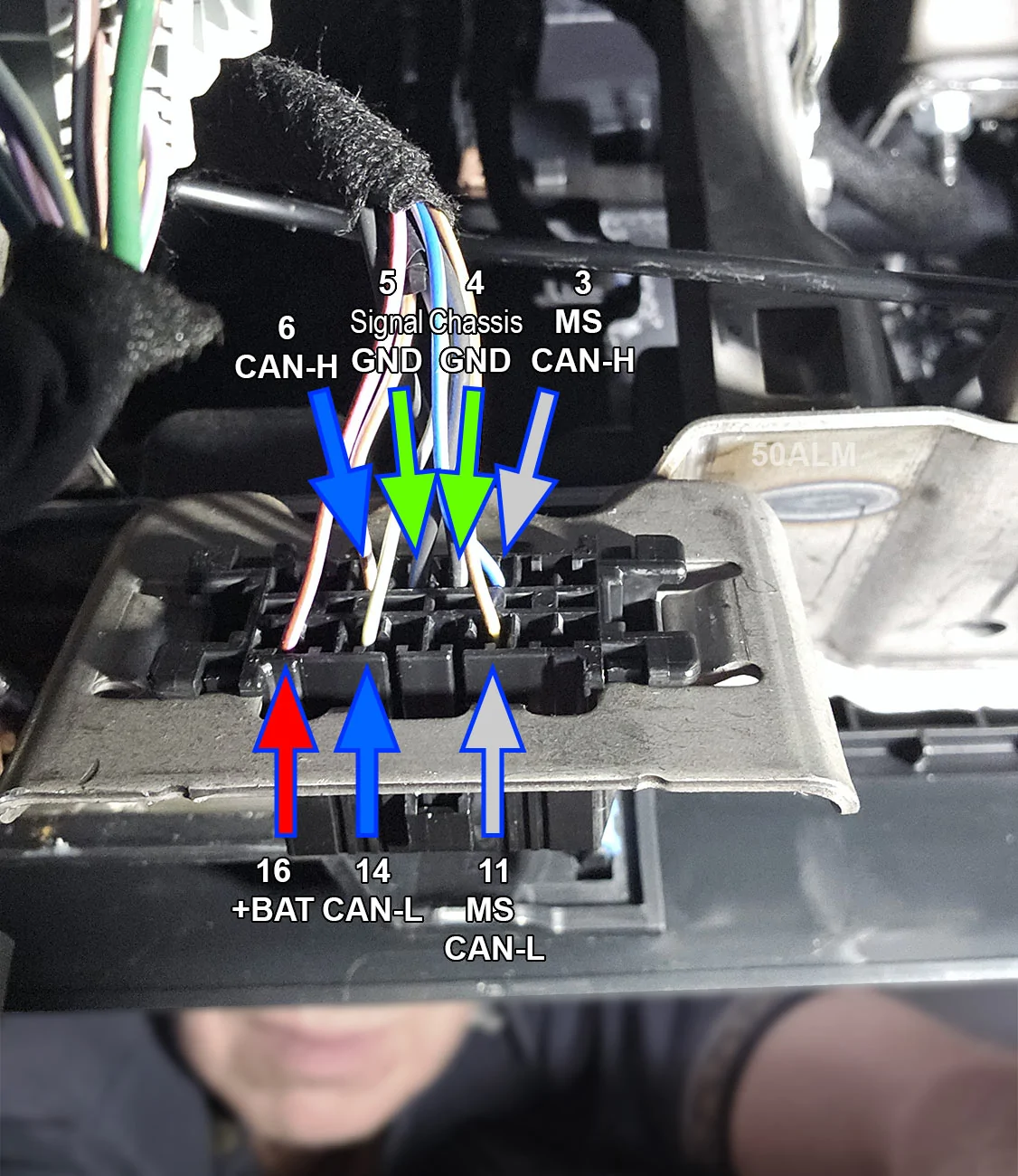

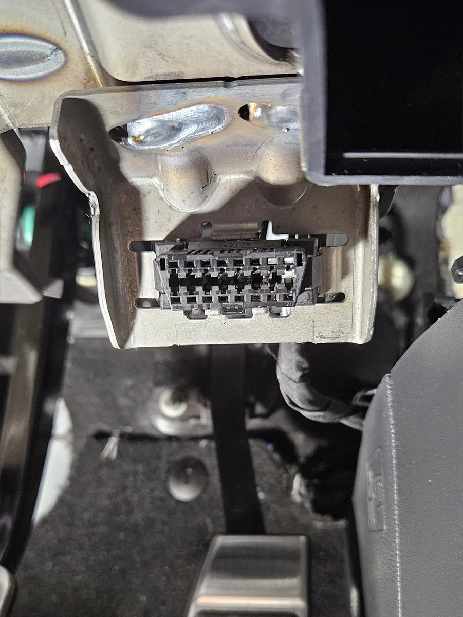

If I'm going to install a hidden switch, it could be a toggle switch somewhere behind the actual OBD2 port, possibly mounted off the sturdy metal bracket. Thinking... JB Weld an aloominium L bracket at the rear?
S650 Mustang Anti Theft Solutions 20250928_122548_1200

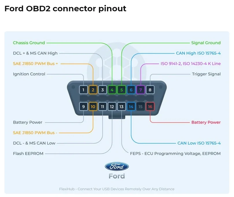

The switch could break either the CAN-H or CAN-L (it doesn't matter) wire.
In the heat of the moment, it's unlikely the scumbag is going to get their head under there with a torch and start looking or fumbling around for something - not knowing what they're actually looking for.
(Personally I hate contorting myself to look under here - it really screws up my back doing so these days!)
Disrupting one of the CAN-bus lines means they can't perform a CAN-bus injection attack of any sort to begin with - the CAN bus will appear "dead" to them. No starting the car, no disabling the security system, no cloning a key fob. No nuttin.
Might as well use DPDT switch (double pole, double throw) and disable one of the medium-speed CAN lines as well. (I'm not sure if these CAN-bus hacker boxes use the MS CAN lines for anything, but just to be safe.)
If they thought their $500 Chinese hacker box bought off Alibaba has died, then that would be hilarious! :giggle:
This wouldn't affect your daily use; ie; forgetting to flick the switch to kill the fuel pump before leaving the vehicle -or- forgetting to re-enable it when you get back in.
Avoids that :facepalm: moment.

This is what is under there.
S650 Mustang Anti Theft Solutions OBD2-Port_1200
You can correlate my from-behind picture above with the front-on diagram below.
S650 Mustang Anti Theft Solutions Ford OBD2 pinout
Thoughts on this?

Yep. It's visible just above the steering shaft. The parking sensor "installer" used it.

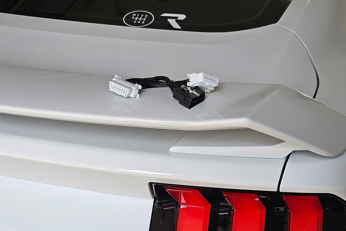

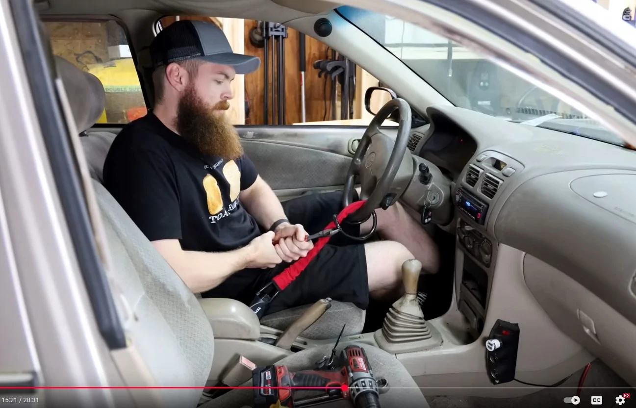

My new "device", of which I bought two last week (one for each car) was defeated easily.
S650 Mustang Anti Theft Solutions Screenshot 2025-10-13 104939
Should have watched this first! :facepalm:
The seat belt lock might still be deterrent for the lazy thief, but I have something a lot more higher tech, and it involves this that was delivered yesterday:
S650 Mustang Anti Theft Solutions 20251013_105328_1200
Will involve some wire snipping and soldering to customise this into what's really needed.
More details on this project coming!
